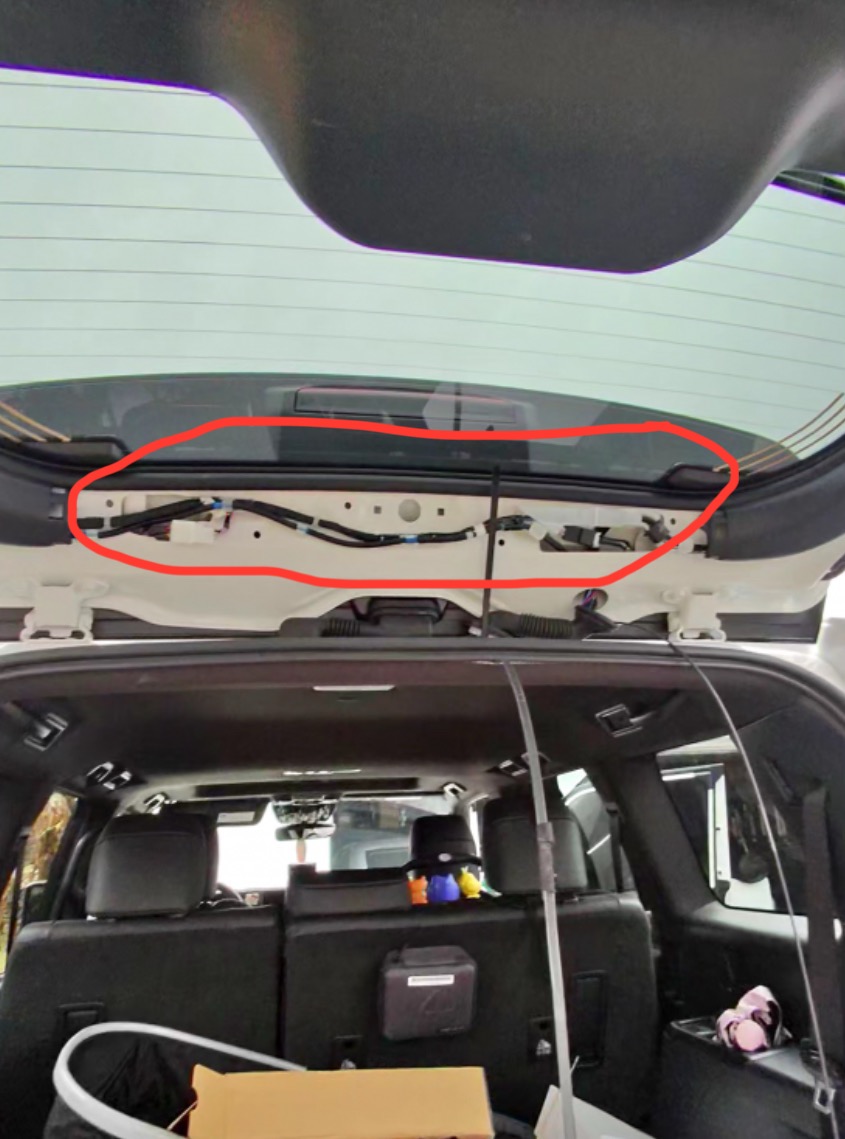

I ran the rear camera cable down the driver side headliner to the rear to the rear hatch going thru the passenger side rubber wire housing, there are two to use with the pax side easier to route the cable.

Any tips on removing the passenger side rubber wire housing?
Slide something really thin and flat under the rubber part next to the the body so that you can release the clips. Like a feeler gauge. If you pull on it it will break the retaining clips.
Awesome, thank you so much for the reply! Any tips on removing the trim on the cargo side of the cargo door?

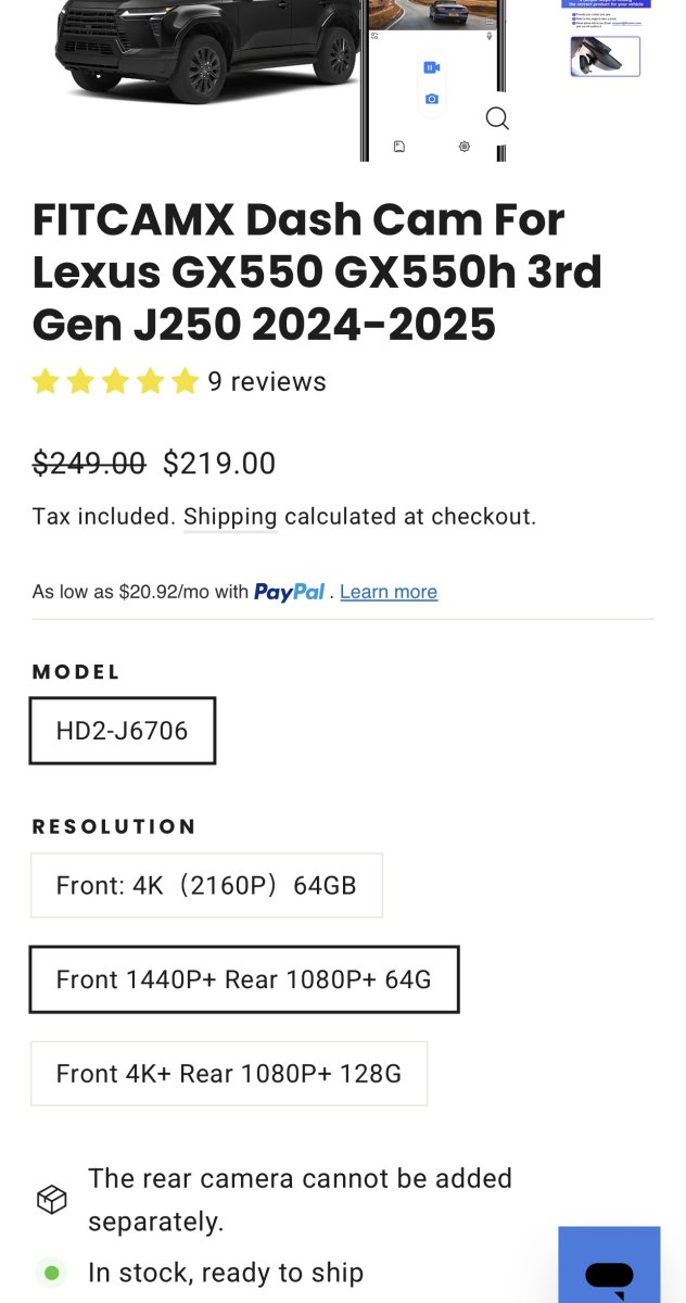

Man, I was so proud of myself today getting the front and rear camera installed only to realize I had ordered the 2K version for the front camera without realizing it. I checked the fitcamx website again and notice they conveniently nestled in the 2K version in-between the 4K options and my dumb monkey brain was paying more attention to the SD card size lol.
Oh well, gonna just live with it since I don't want to go through the install process again.

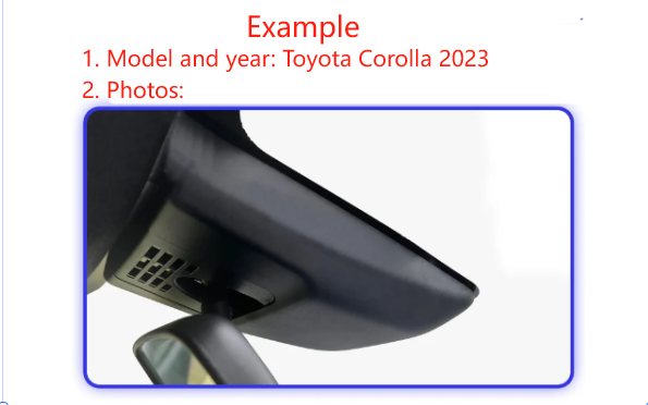

Getting a 2025 Luxury plus next month and ordered this from their black friday sale.
They are asking for a picture as stated below, has anyone done this and can send me for a Luxury plus?
"Please take a photo of the rear view mirror cover from the angle shown in the attached picture and send it to us."
