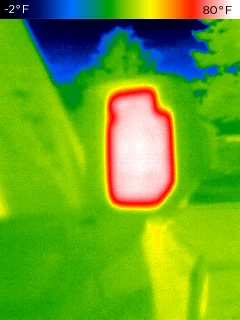

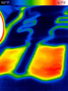

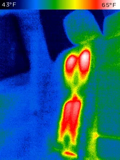

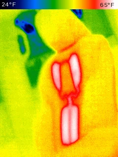

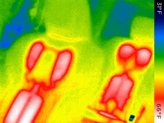

Just did some basic test and front and rear seats registered at 65F/18.3C without sitting in the seat. This was measured 10 minutes after setting seat temp to max. It may be slightly warmer with you sitting in seat. Also the steering wheel topped out at 85F/29.4C and the side mirrors 80F/26.6C. The ambient temp was 51F/10.5C. This was non-scientifically measured with a thermal imager. As soon as I can get it to work, I will post the pics of the seat heating elements.
Setting the seat temp to low took a very long time to register. That might be why some think it doesn't function correctly. I would set seat to high and shut off/reduce temperature when comfortable.
As promised, although a little late. This is from an October build.
