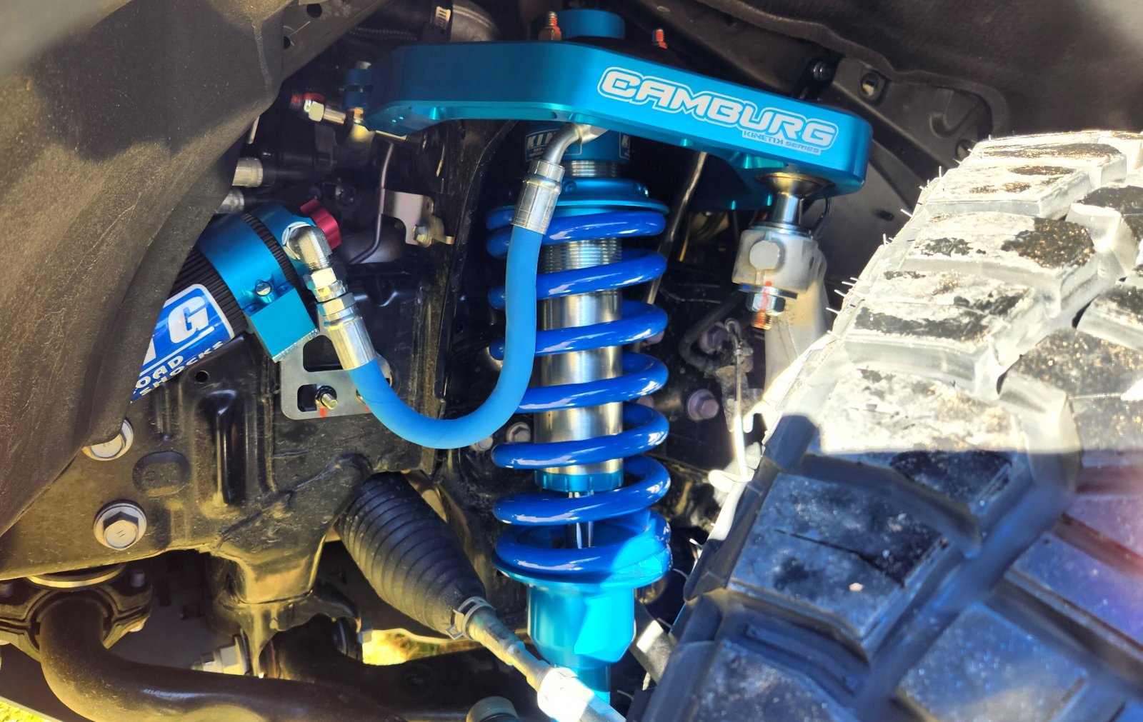

I can say you loose nothing. AVS is nice and the computer is doing all the work. They're still a oem shock. No codes are set when they're disconnected. The King ride is as plush as oem if not more. I did expect it to be a little stiffer of a ride but, the out of the box, the adjusts seem right on. There's 20 clicks on the damper to chose from.

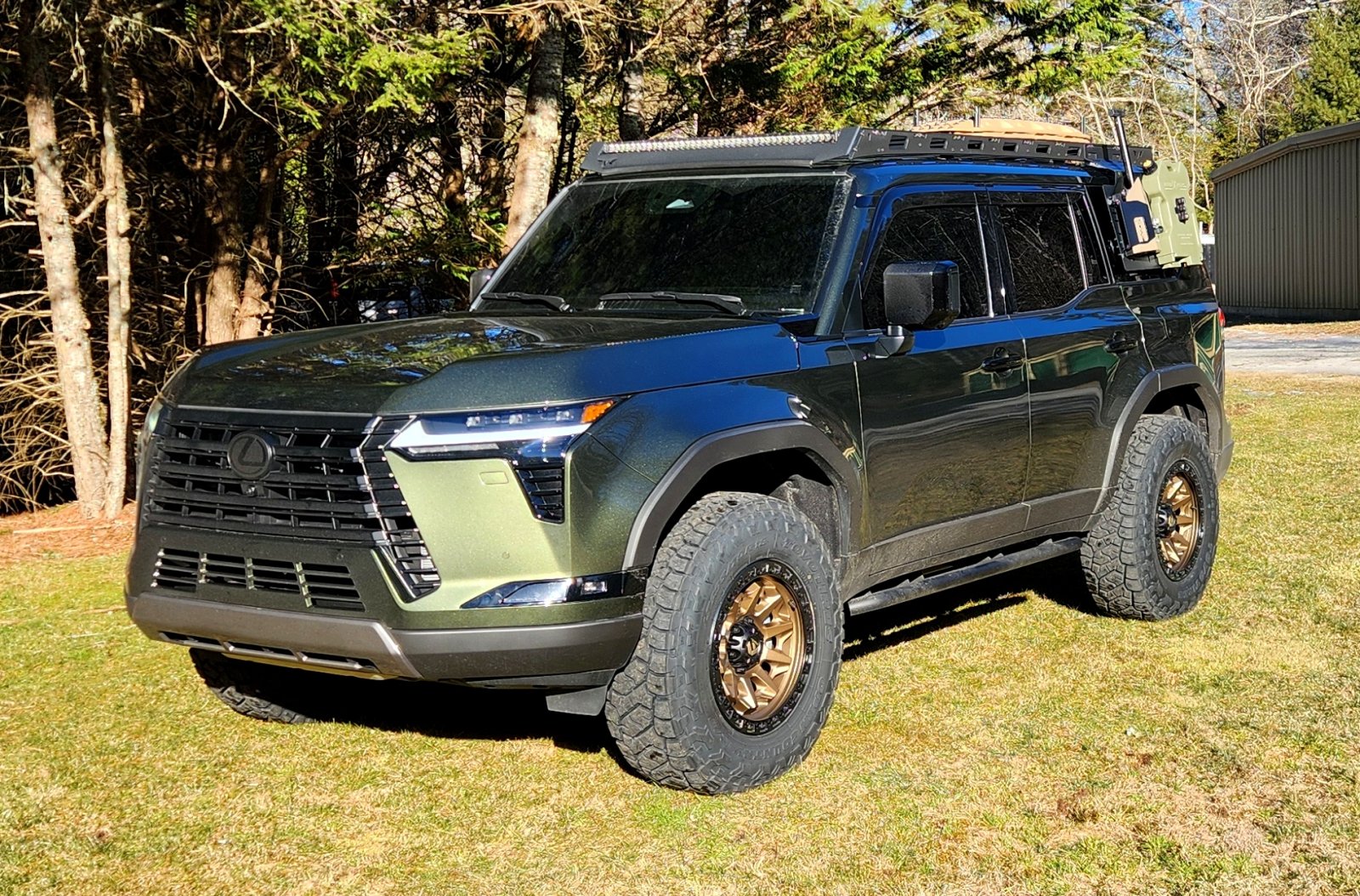

View attachment 7603View attachment 7604
What is your tire size after the lift? How much lift did you get? I'm thinking about 2 - 2.5" lift with 285/75R18 tires. I'm waiting for King to release the rear shocks that can accommodate KDSS which should be about a month.
Thank you for your input.
295/70/18 The Kings are available now, it's what I just got. About 2" but, are adjustable. Their problem had nothing to do with the rear. They had to redesign a bracket for the front passenger side because of the kdss lines in the way.
That looks awesome. Do you have a build thread for this? Are those Lexus factory rock sliders?
Thanks! No thread. Is there something you wanted to know about? Yes, they're oem sliders. I think they're as nice if not nicer, than most out there.
How'd you spec the suspension mod? Did you work with King directly, and do they have one GX550 "kit" that includes the Camburg UCAs? Or did this take more dot-connecting than that? Would also love to know about wheel offset and how much things poke out of the wheel wells. (hard to tell from the pics)
