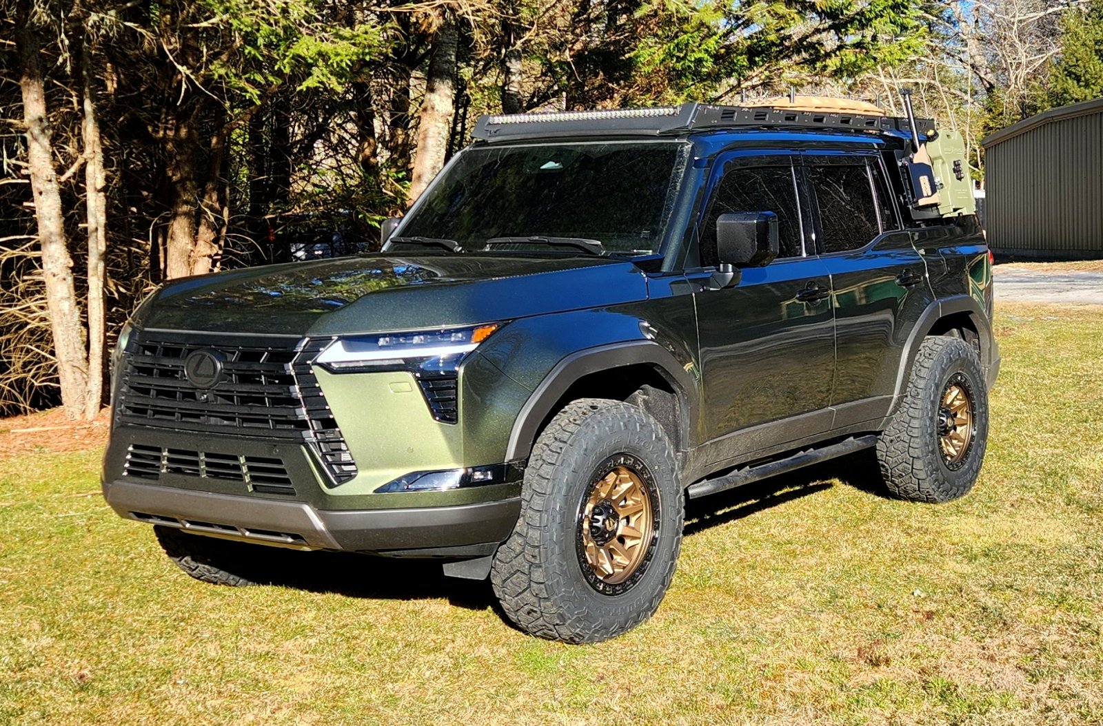

How'd you spec the suspension mod? Did you work with King directly, and do they have one GX550 "kit" that includes the Camburg UCAs? Or did this take more dot-connecting than that? Would also love to know about wheel offset and how much things poke out of the wheel wells. (hard to tell from the pics)
Tastefully done setup for sure!

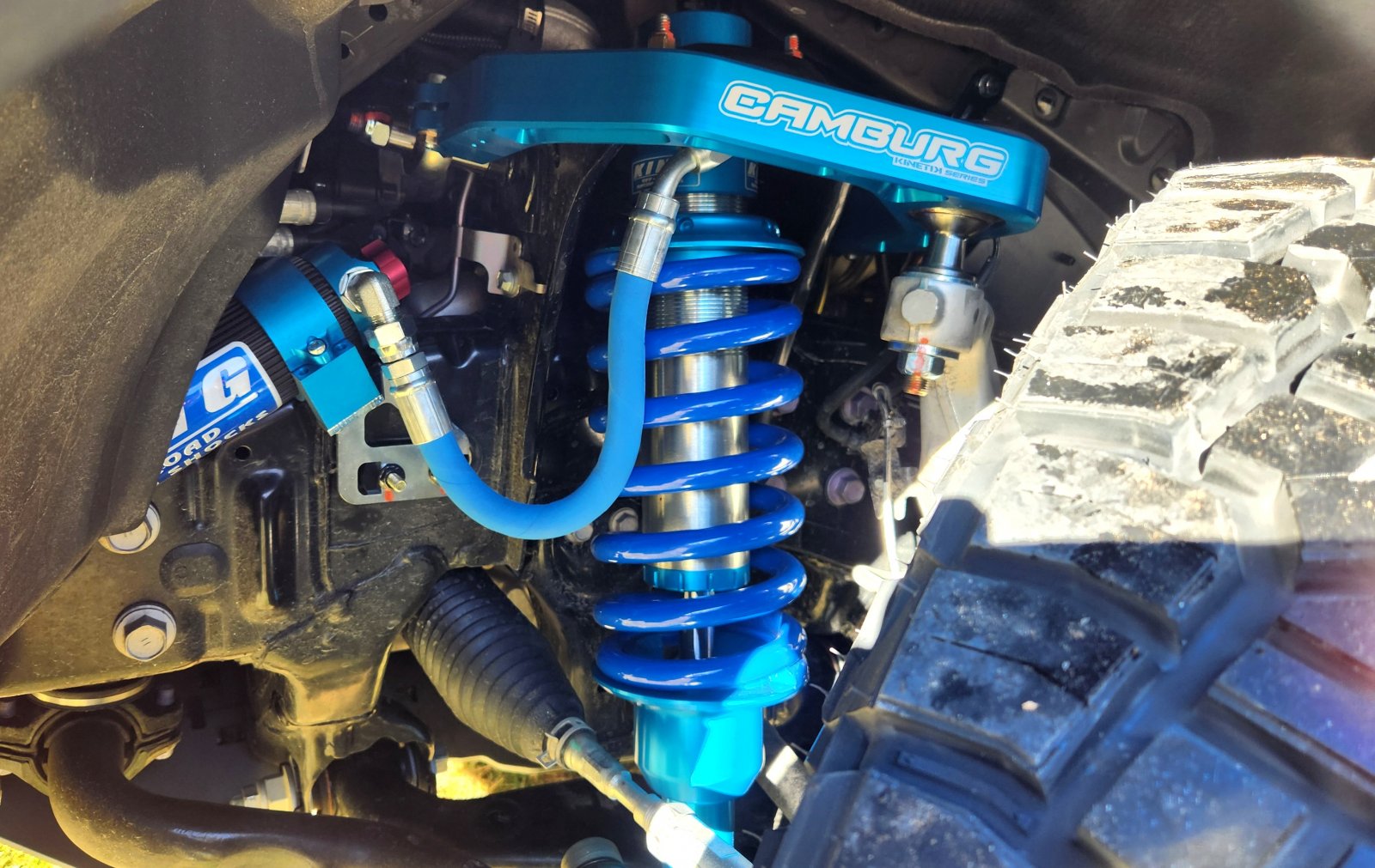

Thanks! You have options. You can go on Kings site to see their kit. Just put in your GX info. They've already spec'd them for the LC and GX. I preferred the Kings and Camburg arm over the others.... just my choice. Icon, Total Chaos, Ready-Lift and probably a few others make the shock kits and control arms. Without more lift, I didn't want to be too negative with the offset. Also wanted to keep close to the oem geometry. I think it worked out well for now. I'll get the articulation without smashing the well rims
specs are ... 295/70 18x9 +20

Any particular reason why you went with Camburg Kinetik? I'm still deciding between Total Chaos and Camburg. I like the blue finish of the Camburg but I'm reading that they're both very similar.
Just my preference. I like the billet over the tubular style. I went with blue to match the kings. It costs more though. Wasn't totally necessary. Going with a suspension upgrade though.., it's a good idea.

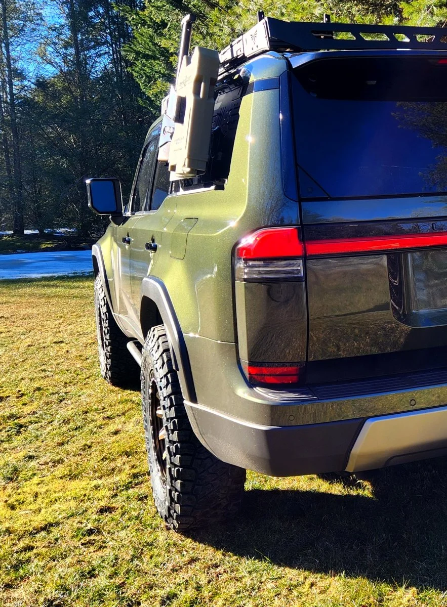

since the KINGS dont come with rear springs, did you stick with the factory rear springs, also if you did does it still level front to back?
My set up might be a little different than others. I have a bumper/winch on the front. The ride was good with the out of the box Kings and oem springs but, it needed a little something. I felt the rear was a bit spongy. I added preload to the Kings and because of that, Dobinsons with an extra 1/2". Made a world of difference and kept it level. If just doing the Kings out of the box, it's pretty level.

Thank you! i have a 2025 OT so was curious. sounds like i can add the dobision later if i end up adding weight
no problem. It's a 30min job ( on a lift ) to replace them if you decide to do it.
