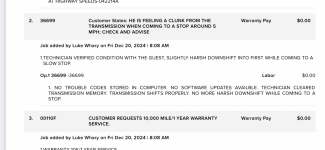

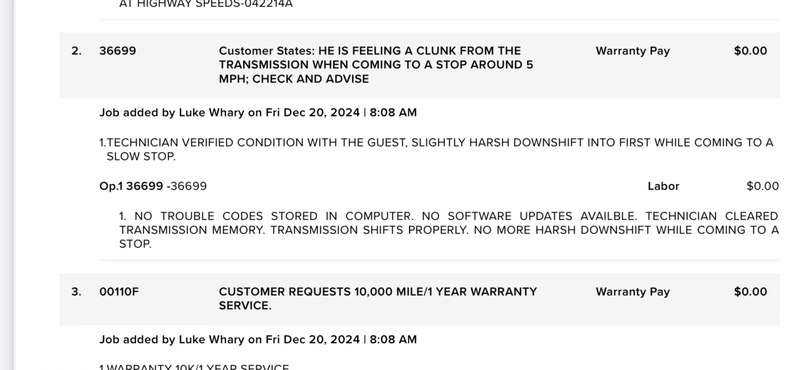

In a previous post, I described a harsh downshift clunk when slowly coming to a stop. Most noticeable in stop and go traffic. Sometimes felt like two bumps, one around 3-5 mph, and the second just when I come to a full stop. I was not sure if this normal for that type of transmission or if something else was wrong.
I was at the dealership for 10k service, and went for test drive with tech to demonstrate the issue. The tech said no mechanical issue, no problem codes, and no software update (yet) but cleared the transmission memory.
Now the shifting is absolutely smooth, no harsh downshift at all.
While I was there I also had the break squeal repair (known issue).

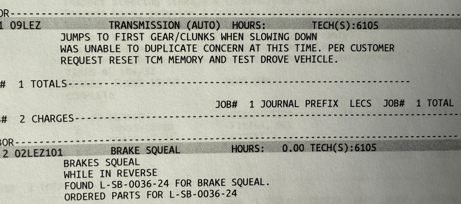

Here is the write-up on my service receipt from Bell Lexus in Scottsdale, Arizona.
"Reset TCM Memory"
You can also see where they ordered the brake components to cure the squeal in reverse. I just took it in this morning and they are doing the brakes now.
"Reset TCM Memory"
Extremely useful info and something affected forum members can take to their dealers and get going with the resolution of the issues!👍
