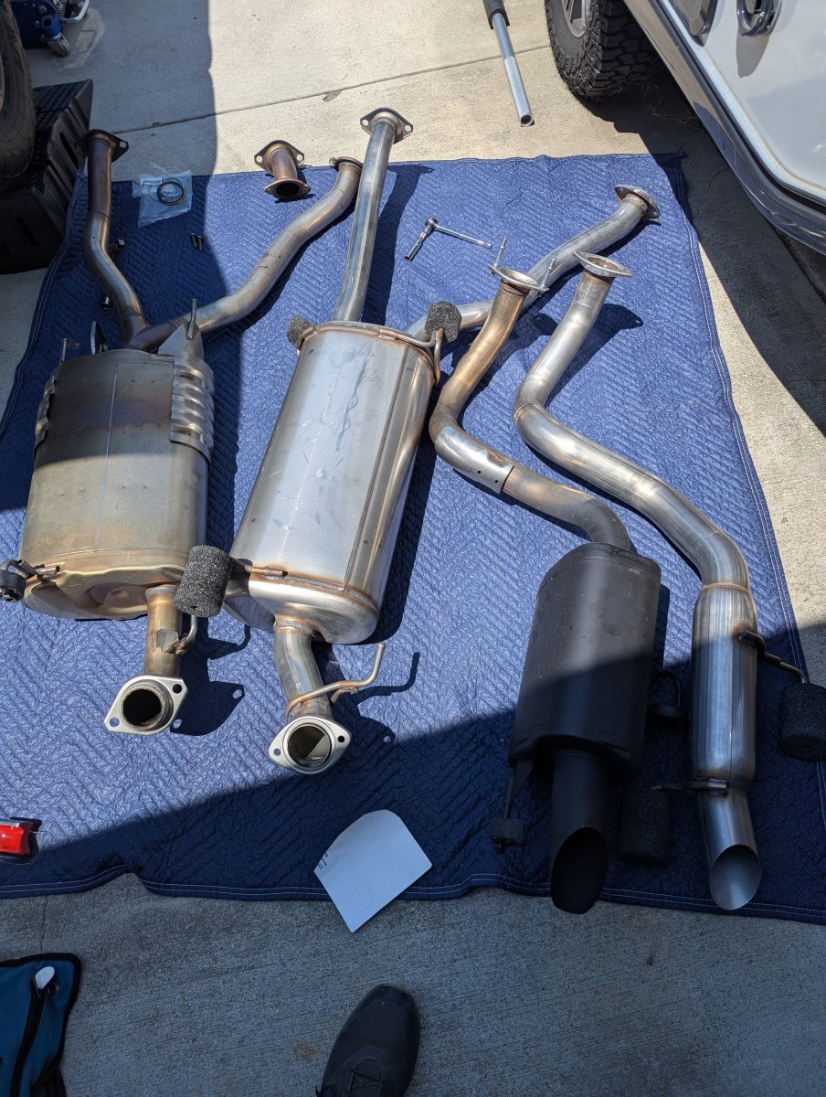

Standard parts, left. TRD, right. Elbow that I didn't need to remove, top center. Note that on stock exhaust and the MagnaFlow, the inlet pipes are joined before entering the muffler. On the TRD the pipes enter the muffler separately, which I expect would result in better flow. That is a win for the TRD in my book.

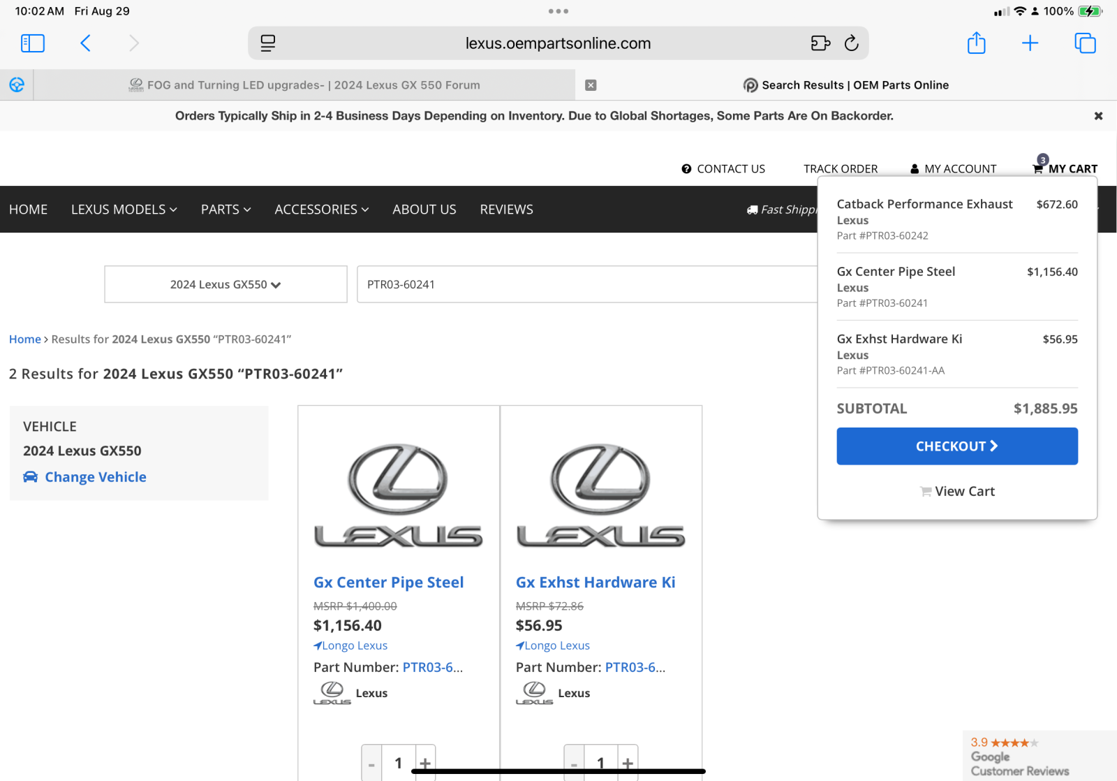

Can the stock center pipe be re-used? i just want the purchase
Catback Performance Exhaust Part # PTR03-60242
and was wondering if it is a direct bolt on to the existing stock centerpipe?
It is bolt-on so I don't anticipate any troubles installing it myself in my driveway. I have a motorcycle jack with a big platform I can use to lift it into place. Not including digging out my tools, I bet I can do this job in less than an hour, but I will keep you posted.
Were you able to install, can the catback exhaust be bolted on to the stock center pipe? trying not to buy the $1100 piece of pipe!!
