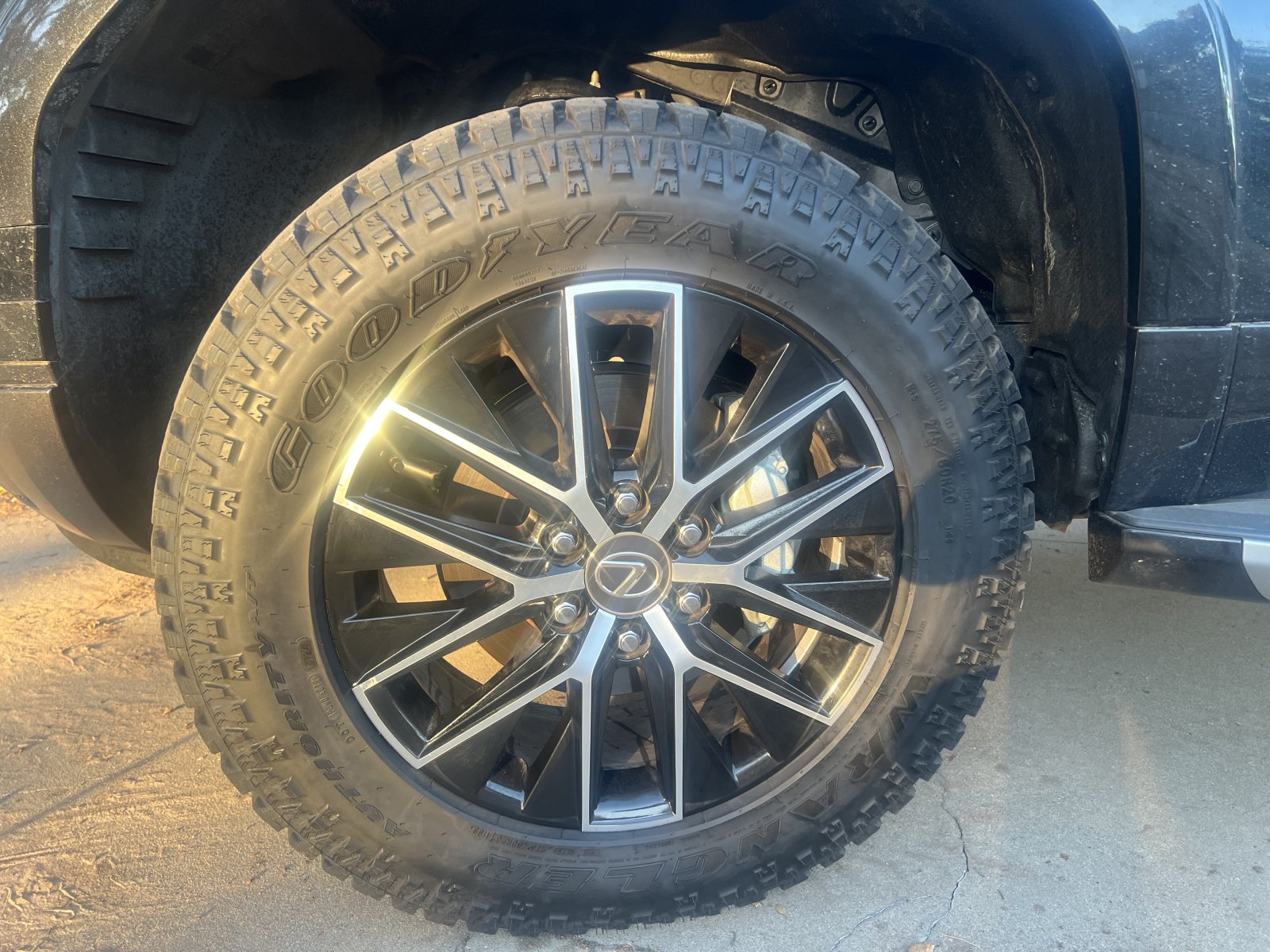

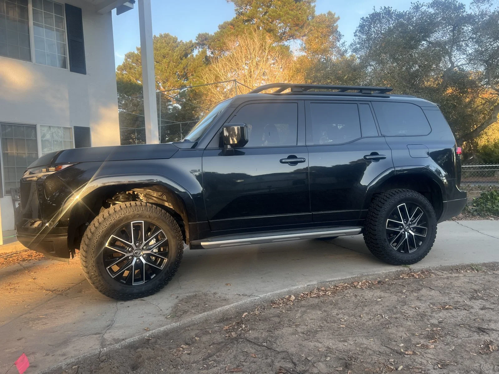

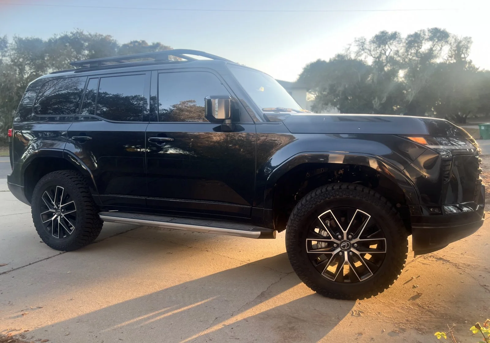

Hey Klint I decided to go with Goodyear Wrangler ATs 275/60r/20 (little over 33” tall) for my premium+ (kept stock wheels, will soon paint all blk) threw them on after I installed the Westcott lift earlier today and I have zero rubbing at all.
Here’s a few pics for reference.
