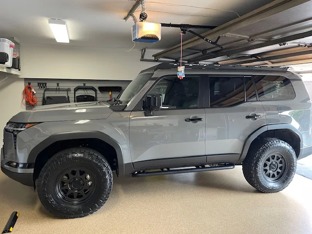

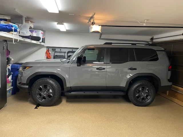

Do you have before and after pics with the Westcott lift? Maybe while yours still had the factory 33" Toyo tires?
Yes, first pic was as purchased without Lexus roof rack. Second pic is after lift new roof rack wheels and tires. Tires are 285/75 r17 Toyo Open Country A/T III

Looks so good. I intend on doing something similar. I think I saw on other threads you don't any rubbing at all with 0 trimming, right? Any side profile pictures by chance?
No rubbing. I’ll take and post some side pictures when I get a chance
It will be a couple days before I can take some side pics. It’s in the shop getting PPF until Friday.

All good! Sweet rig again! Ill likely do the same but with K02's (I am partial to BFG's and they're also normally slightly smaller in diameter)
