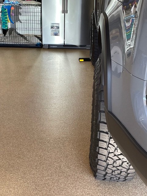

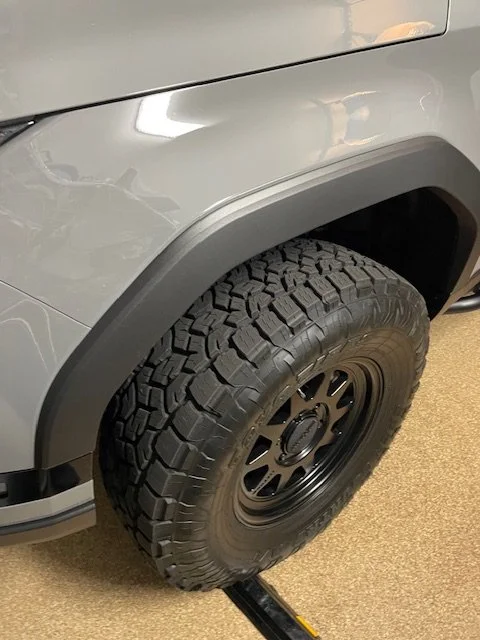

As promised side pic
. Hope this is the angle you wanted to see

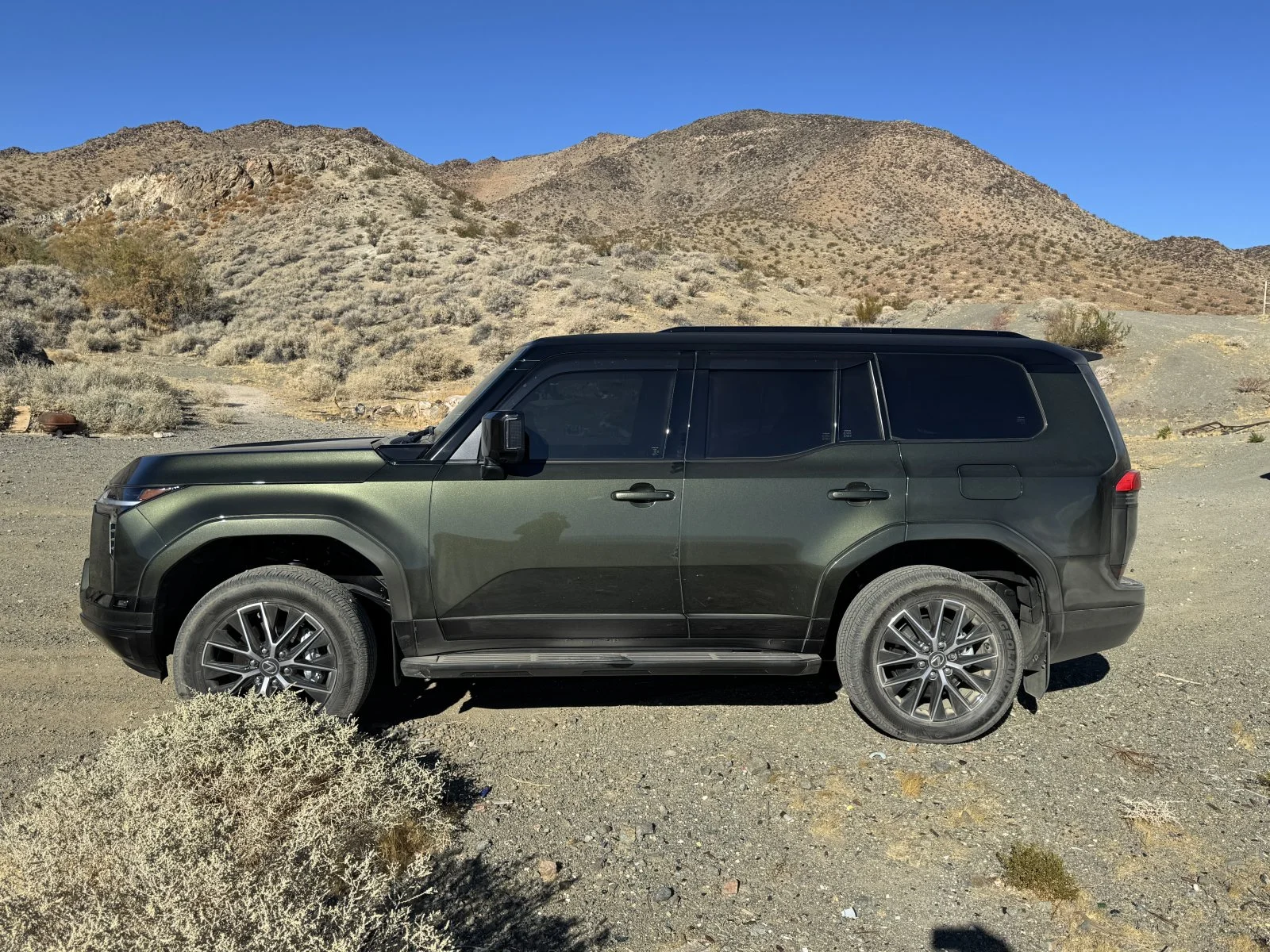

I added a peak suspension front spacer kit for an added 1.25” up front. Rear is stock. Brings up the front, still still has a slight forward rake and

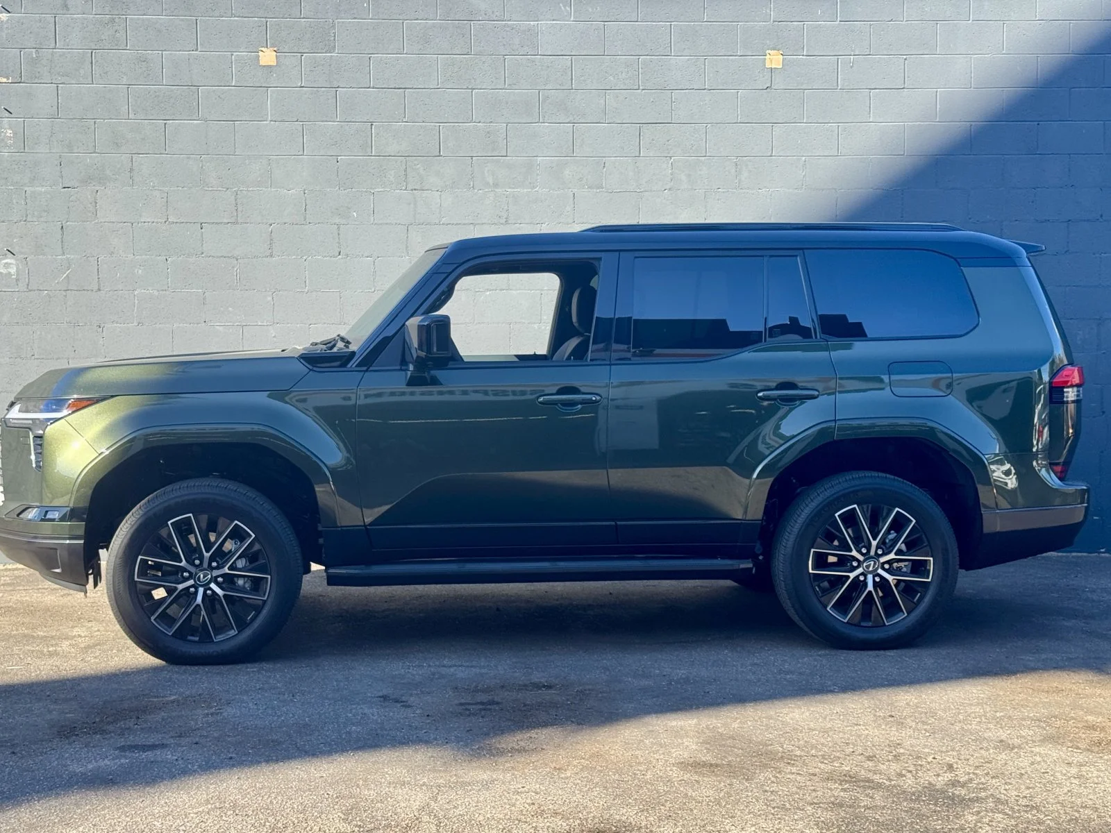

Amazing, didn't know that was an option. Does it change the drive at all? In the image, the front actually looks a bit higher than the rear, but maybe it's just the photo. Any other pics? Where did you have it done?
That was a photo on uneven terrain. Here is one on level ground. The center of the wheel to fender measurement is still higher in the rear by an inch.
Nothing noticeable on the street. Not recommended for heavy off-road use. Should be fine for trails. I had a local tire shop install it. It’s a quick install since the shock assembly doesn’t need to get taken apart

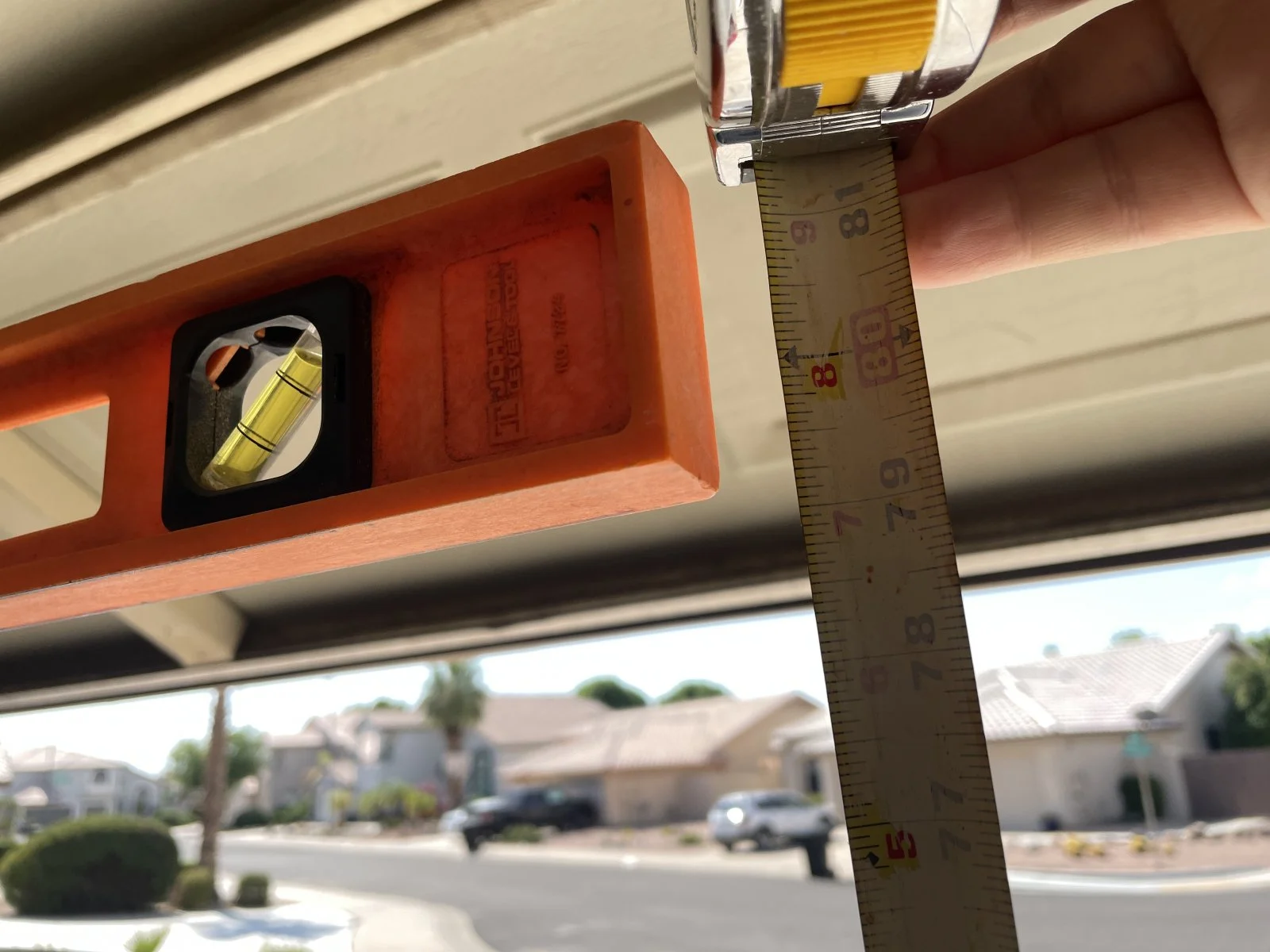

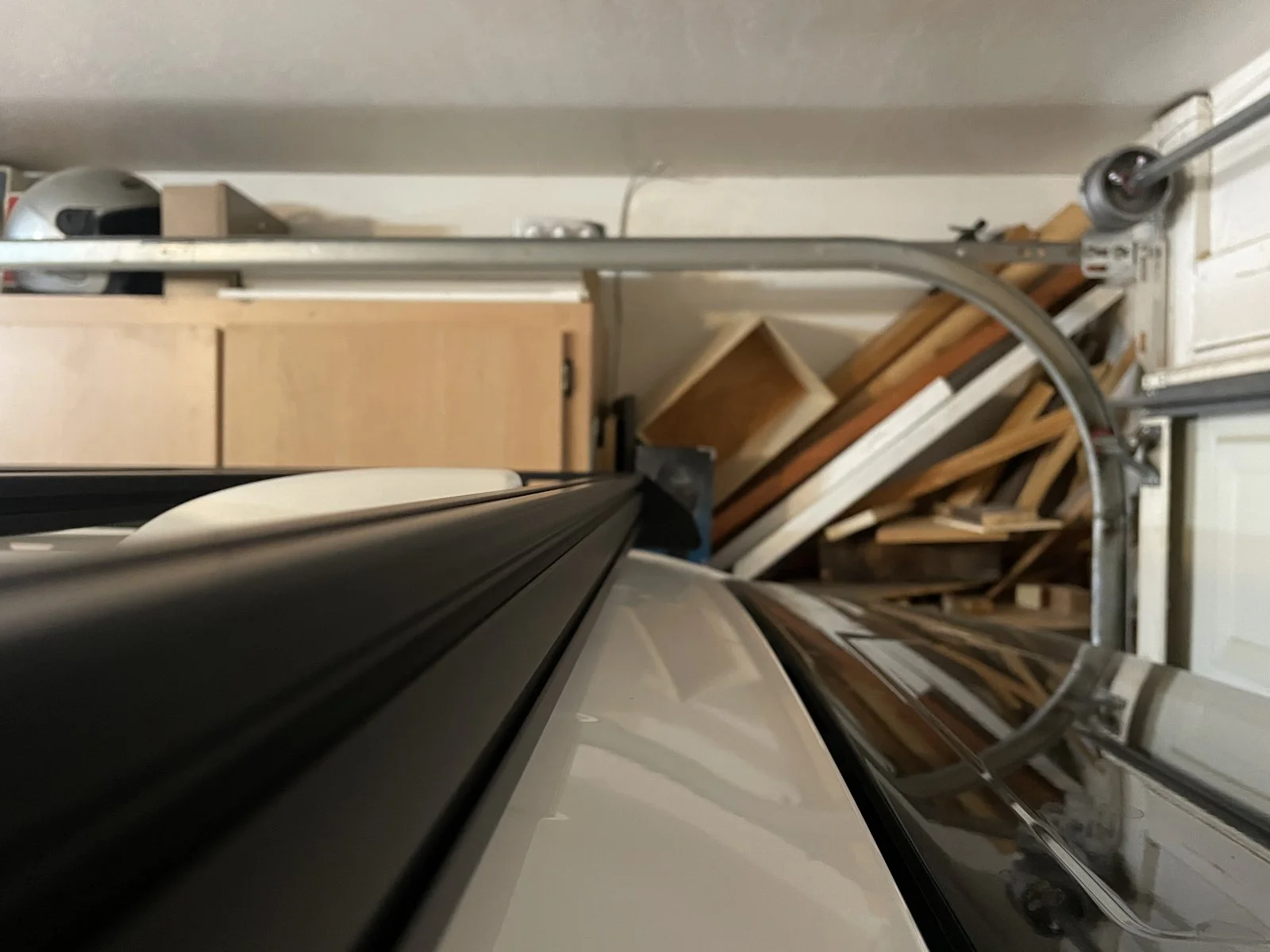

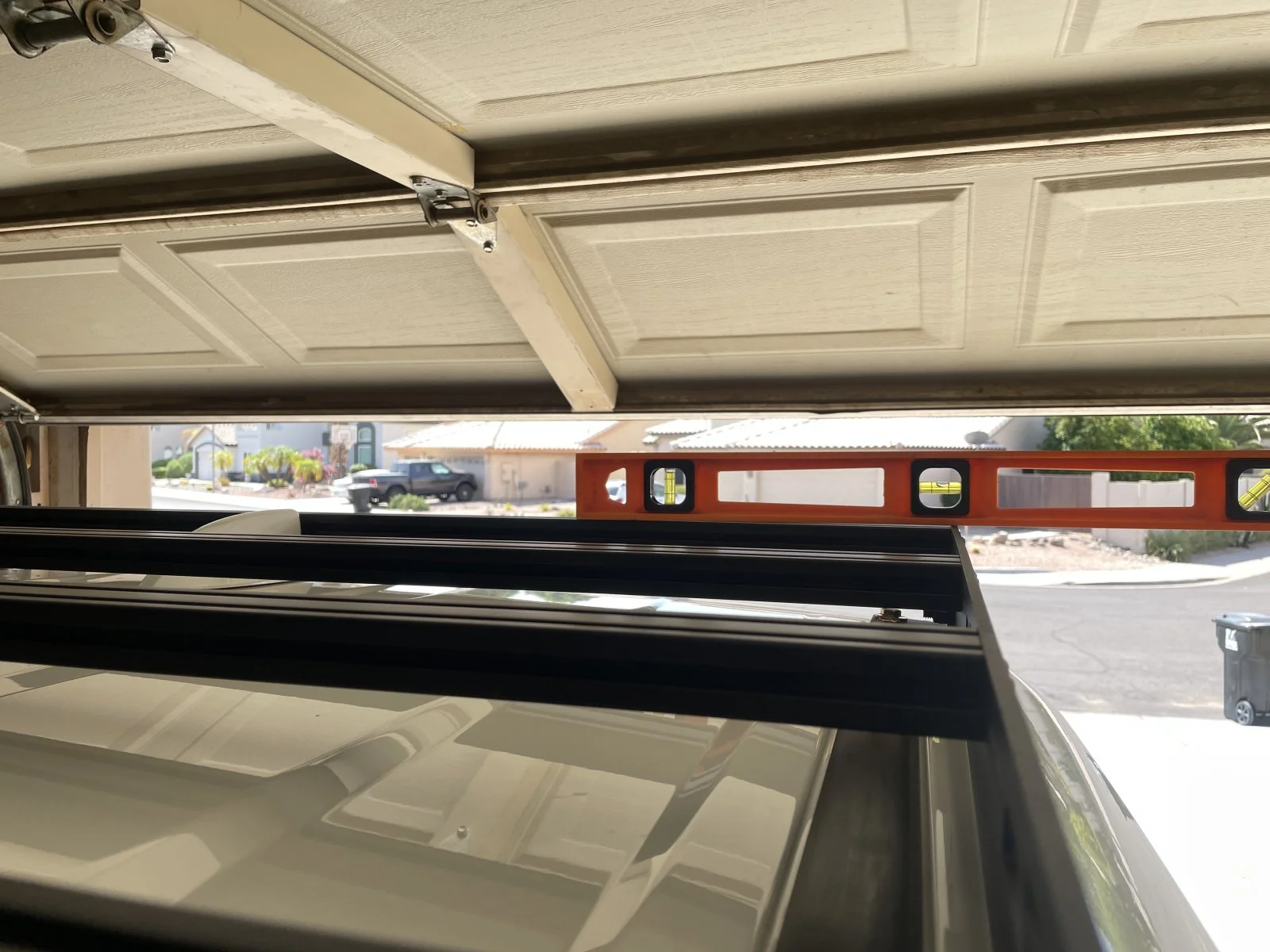

See photos below...I measured my height of the top of the Westcott rack after installing the rack, Westcott pre-load collar lift, and 35 x 12.5 x 17" tires.
Using a large level, the top of the rack height is 79.25". You may say who cares about the rack, but the key is that the little shark fin antenna actually stick up a little bit higher than the Westcott rack. It's about 1/8-1/4" higher, so the firm, fixed truck height after lift & tires is about 79.5". I just call it 80 inches and give myself a 1/2" buffer. Still, I went into a garage with 80 inches of posted clearance and took it slow and easy, watch out for low hanging lights, fire sprinklers, signs, etc. You also have to be mindful of suspension rebound. I had to back out of a supermarket garage in La Jolla last summer and I had all sorts of people pissed at me. Luckily no one's packing in southern California....LOL
