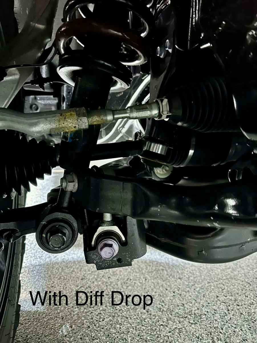

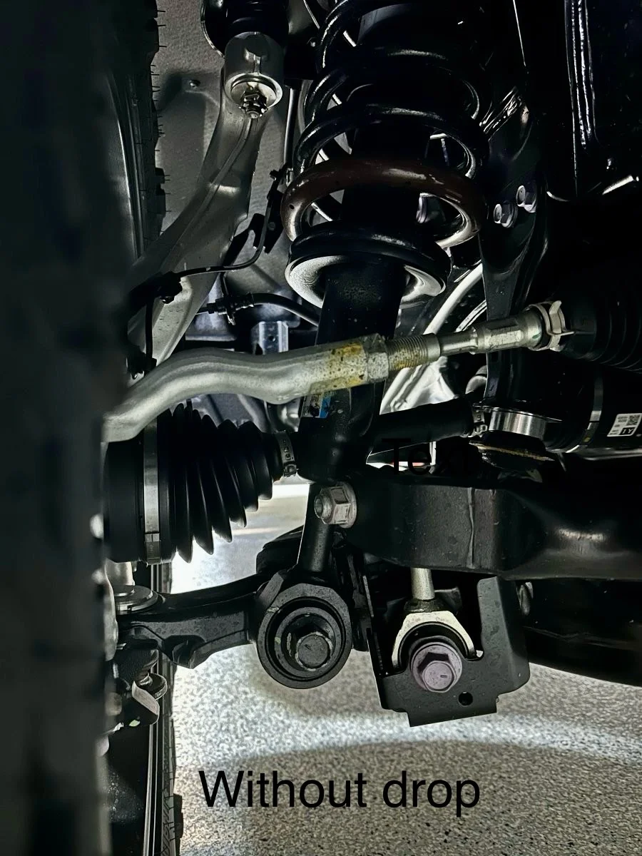

Turns out i got wrong diff drip kit from Icon. The one you posted the link to with install instructions appears to be the correct one. It has three holes on that one price. It’s the same Kit for a tundra and sequoia. Which means it’s different than the LC250 kit. Some websites were selling the LC250 kit for the GX which wasn’t right. I’ll report back after lift is on to see what I think about the CV angles without it.

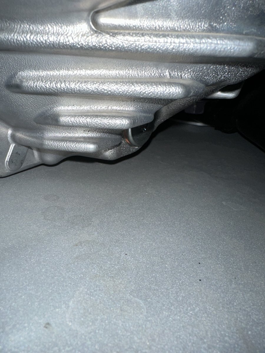

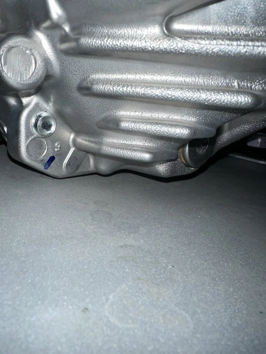

I installed the Icon Diff drop. the skid plate might need to be spaced, but no rattle as of now.

Got the ICON stage 9 tubular and my King extended travel coilovers on the way. btw the tundra diff drop is same for the gx and dobinson makes a diff drop if youre looking for options
I ordered the icon one but received the one for the LC250 so they’re sending me the right one. Dobinsons lift already on. Driving carefully on streets only for now. Thx for the update and hope your lift setup goes well!
just ordered and installed the BOTCK kit plus the track bar. Easy to install and The vehicle is more like stock.
