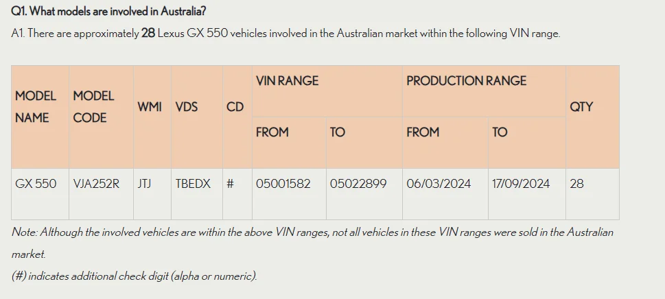

This is from the AU recall site, it has the VIN range for recalls in AU but implies that the VIN ranges are global.
It looks like production mid-September 2024 up to #22899 are recalled. Mine was built in Nov 2024 with an engine build date in July 2024, no recall notice in the Lexus app.
I dug a little into this, and I'm not sure this is for the V35 recall. I think this is for the electric brake and knee air bag.
