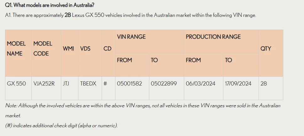

This is from the AU recall site, it has the VIN range for recalls in AU but implies that the VIN ranges are global.
It looks like production mid-September 2024 up to #22899 are recalled. Mine was built in Nov 2024 with an engine build date in July 2024, no recall notice in the Lexus app.
Okay, yours is definitely a very early production unit, probably built around the 1st quarter of 2024.
Just for reference, based on what I’ve found online , a GX550 with the VIN sequence “20620” (indicating the 20,620th unit produced) had a recorded build date of August 2024. Refer to this link and scroll down where you can see the VIN tag on the car- Used 2024 Lexus GX 550 Overtrail+ For Sale (Sold) | Autobyzack Inc Stock #R5020620
So if yours is in the 2,000th unit range (02234), it very much suggests that your engine was built much earlier and likely still uses the older bearing design.
