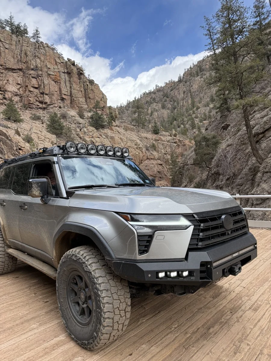

The picture is from a LC250 but the GX would be the same as confirmed by NYTOP.
See other posts on this, the running board light can be attached up above and not on the bottom of the rail, or not at all as you wish.

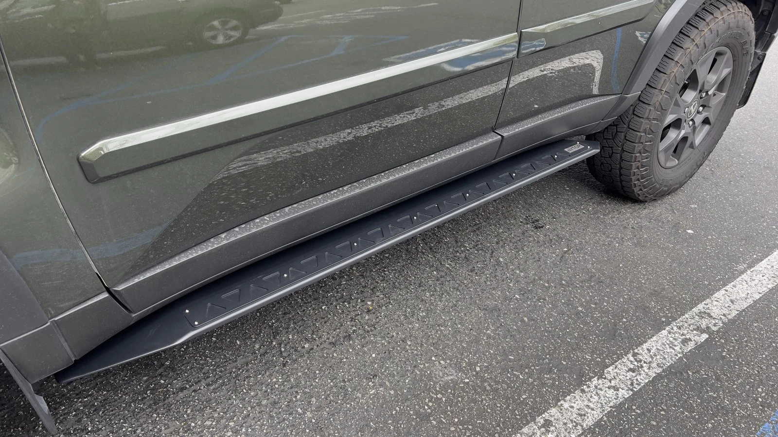

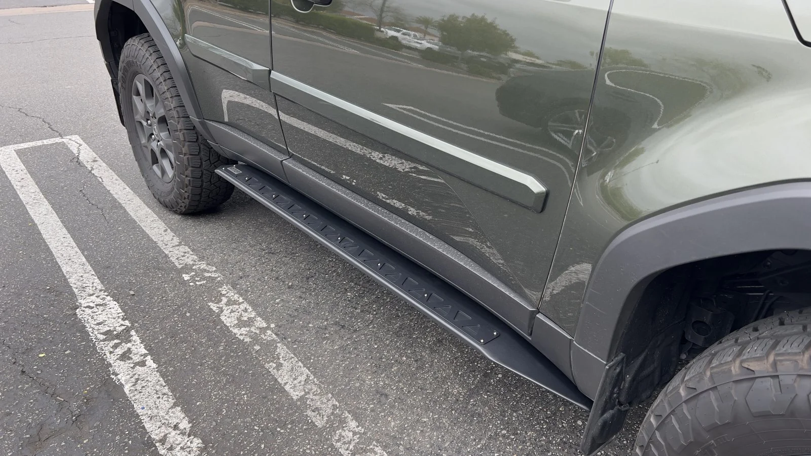

Picked up the NYTOP sliders on Saturday and installed them on Sunday. Took some maneuvering to get them installed, using a Badlands floor jack and jack stands.
Installed the NYTOP skid plates as well. Hard to get any good pictures of the skids.
Took me 3.5 hours for both with a friend's help. Couldn't have done it without help.

Looks good. Mine are on the way. How did you end up attaching the running board light?
I ended up putting the light on the bottom just like what NYTOP did. I could have zip-tied the light somewhere to hide it but decided against it.
I was told there is a light delete kit that would plug into the terminal where the wiring would be. Leaving the terminal bare would expose it to the elements. Just have to find the part if available.
Thanks. When I put mine on I may experiment with putting up above somewhere. I don't get much light from it on my running boards now, so I don't particularly care if it does much. Did you use a floor jack to support the sliders when you were attaching them?
Yep, used the floor jack to lift the sliders with a cardboard box to hold them on one side while bolting the other side.

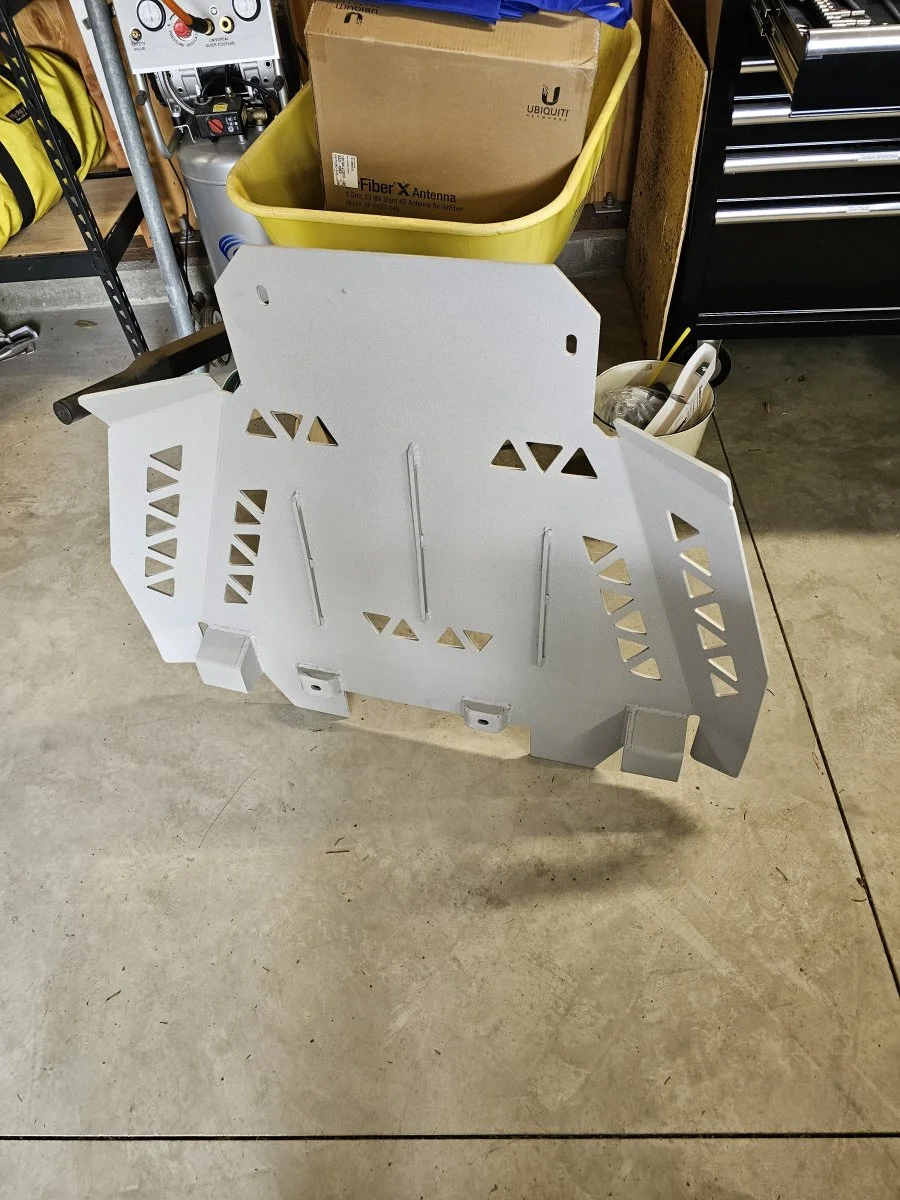

Hi, finally getting around to putting my sliders on. I have a question about the NYTOP skid plates. Do you feel that they are a material improvement on strength/coverage from the OEM Overtrail plates? Are they going to be a pain for the Lexus service people when the oil/filter is changed?
Thanks for your input,
Good question for any third party skid plates. Some have a nice access hatch for oil changes. Most? Not sure about the NYtop ones.
I have only done the rear skid plate but the OEM was 0.16" thick and the NYTOP was 0.25" and also had some reinforcing bars on the large flat areas. The front OEM skid plate may be more difficult to remove because the OEM fasteners had built-in washers and the NYTOP hardware had separate washers so I am not sure they will work with the keyhole holes in the front OEM skid plate which are designed to allow you to remove the plate without totally removing the fasteners.
I still don't get all the holes in it. I know you want it to drain but those seem like dirt and weed scoops to me. not all the 3rd party skid plates have them. The Toyota TRD has almost none which makes more sense.
