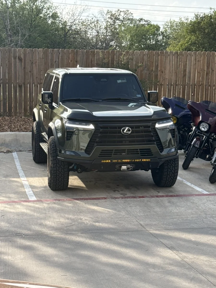

I'm using icon rear springs. Icon UCAs icon full rear arms my fronts have settled since I put my kings on I'm going to raise the front to match my rears.
@Bluegill yessir i got around a 3in lift in the rear with it. if i were to do it again i would just get the panhard bar and maybe rear LCA from camburg like you did.
