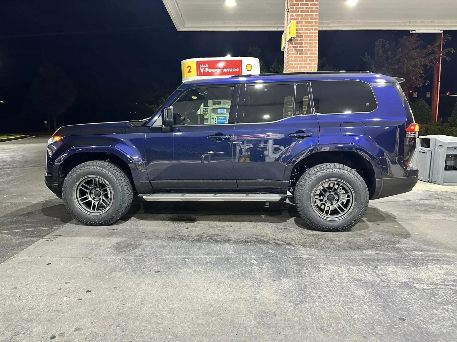

For those interested in wheel and tire swaps, this thread serves as a helpful resource. A common question we often encounter is about offset and its effect on the stance of the vehicle. If you've recently switched to new wheels & tires, we'd appreciate it if you could contribute by sharing the wheel/tire size, offset, and detailed photos
Here's an example of 18x9 wheels mounted with 265/70r18 tires. The wheels have a negative 0 offset.
(Photo credit S. Yoon - GX550 Owners FB Group)
Do you get much tyre scrub at the front?

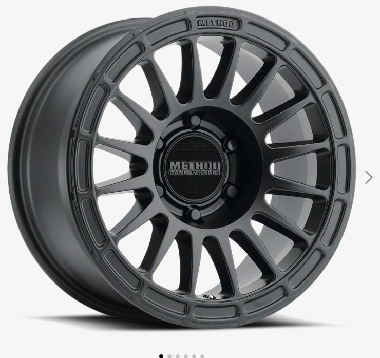

I just got my White Overtrail+ home today and the wheels are 'ok', not bad.... but I'm thinking about
getting these Method 316 wheels in matte black. Do they look black enough?

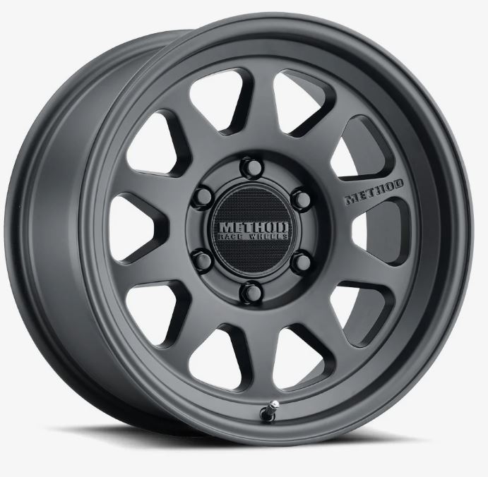

OR the 314's

I think the 314’s will look sick! I will live with the factory wheels for a while before switch tyres and wheels just to get used to the drive.

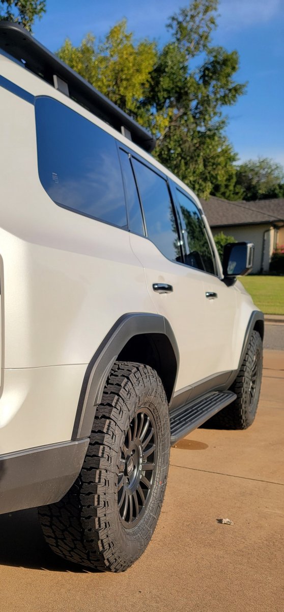

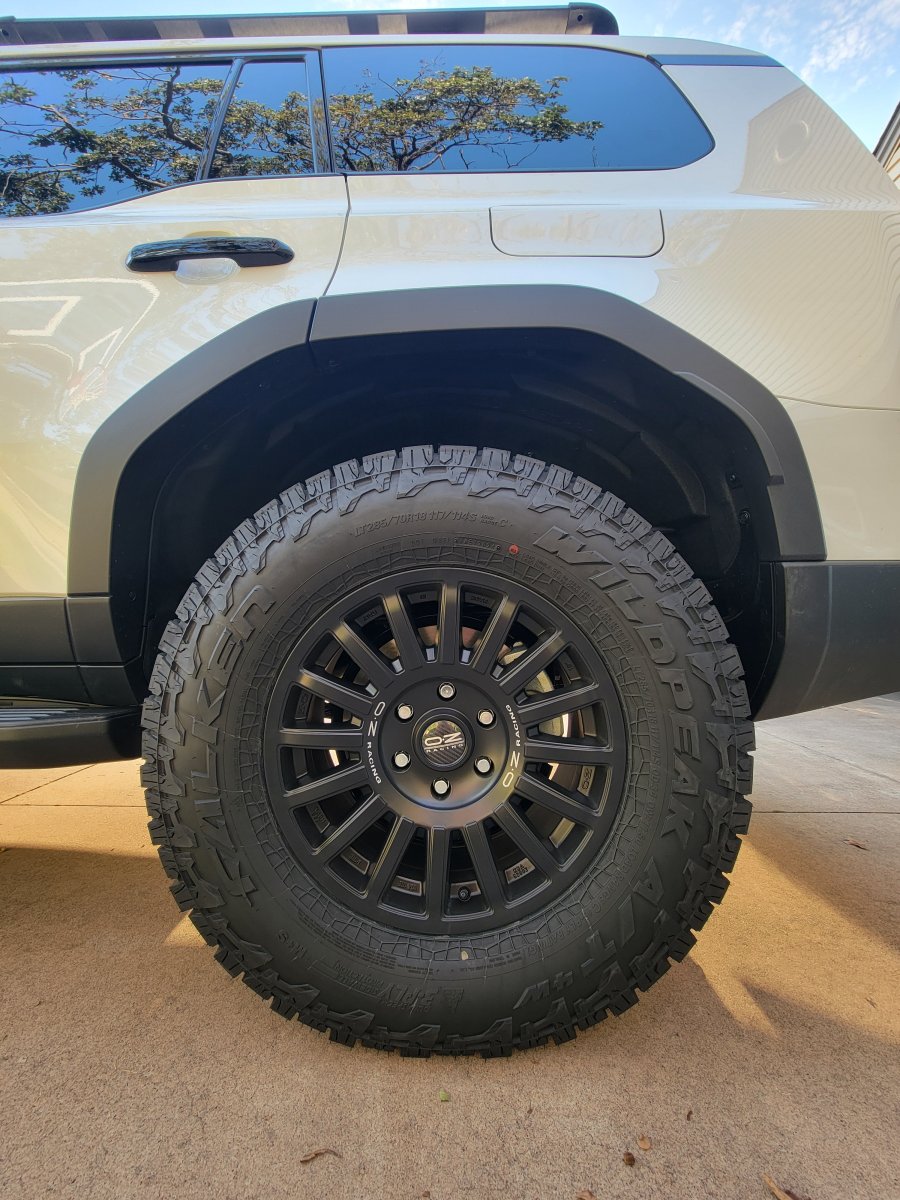

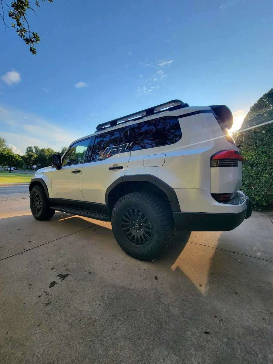

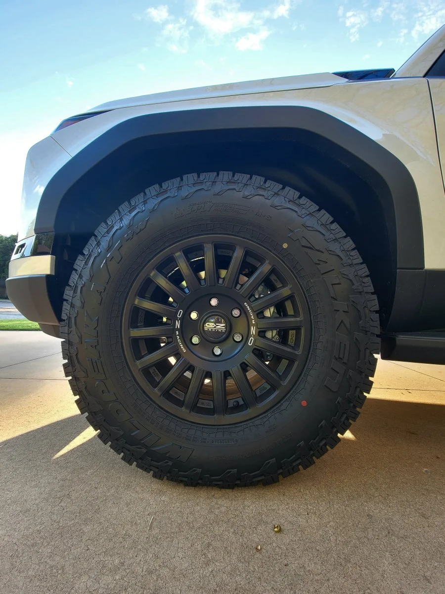

O.Z. Rally Raid, 18x8.5 +35
Falken AT4W, 285/70/18, C load
No lift and no rub after removing the small covers in the wheel well behind tire.
How do these tires ride compared to the stock OT tires? Really would like to know how quiet they are too. They get really good reviews. I’m eying a similar setup, but have had BFG KO2 C-load for years. Have you tested full flex yet? More pics? Apologies if you already answered this elsewhere!

I don't know if Method has the correct bolt pattern and offset in those series of wheels. When I purchased mine (July) all they had to fit the GX550 was the 703s. I wanted 701s but they didn't have our fitment.

Really like them so far. About 800 miles on em and they've broken in a bit and feel great. Running at 30 psi. Steering and turn in is still quick and I honestly can't tell much difference from the Toyos in that regard. They do make the rig feel slightly heavier from a stop but not by much could be in my head because they are heavier tire. Great on highway and amazing in the rain. I went with these over Toyo, Cooper and Nitto mostly because of the performance in rain and snow/ice. Have not a had a chance to wheel them yet so can't comment on that. Noise is similar to the Toyos, pretty quiet around town and only the typical quality AT hum on the highway. The OT+ roof rack is way louder than the tires lol. Can't go wrong with any of the options out there honestly. I almost went with the Coopers in the slightly smaller size in tbe SL load, but super happy with the Falken AT4W's so far. We are getting about 13.9 mpg w/ mostly city driving. Closer to 14.5 highway. I think the roof rack is playing a role as well though.with the mpg.
Oh, and I've had KO2s on a lifted F150, and Nitto Ridge Grapplers on a lifted 4Runner and the Falkens are just a better tire imo.

Look amazing, the alternating tread on the edge makes them look like mud tyres!

This is such a clean set up!
Do you mind sharing where you purchased those OZ wheels(online, local dealer,etc)? They are really growing me. Just doing a general search they aren’t that common in a 18x8.5 +35.
Also how do the falkens ride(stiffer or bouncy) with that 3ply side wall? I have a westcott lift ordered and would like to go with the 35x11.50 C load but might just call it a day knowing the 285/70’s fill up the wheel well nicely. I’m not about just stuffing the biggest tire I can. Thanks in advance.

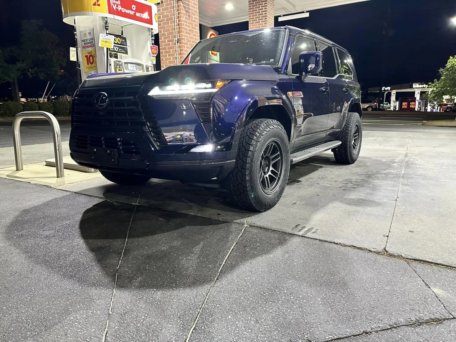

Anyone have an idea what wheel/tire combo this is? It looks mean.
