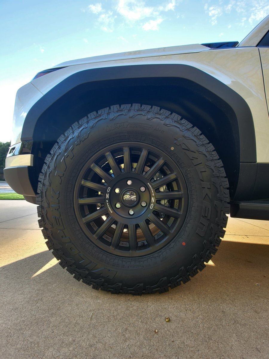

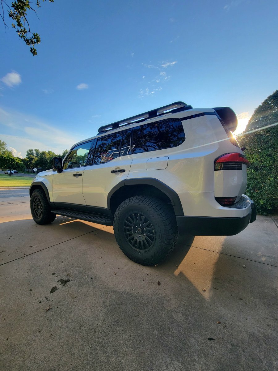

I was able to fit 285/75 R18 on the stock overtrail wheels. No cutting, but did need to remove some brackets in the wheel well. No lift yet. Spare does not fit so I’m still trying to figure that out.
Did you manage to fix your issue with the spare?
O.Z. Rally Raid, 18x8.5 +35
Falken AT4W, 285/70/18, C load
No lift and no rub after removing the small covers in the wheel well behind tire.
Now they look awesome, was this replacing the standard OT wheels and tyres? Looks like you cannot fit a fleas ass hair between the tyres and the wheel arches! 😃😃😃 does it not catch on compression on the trails?
