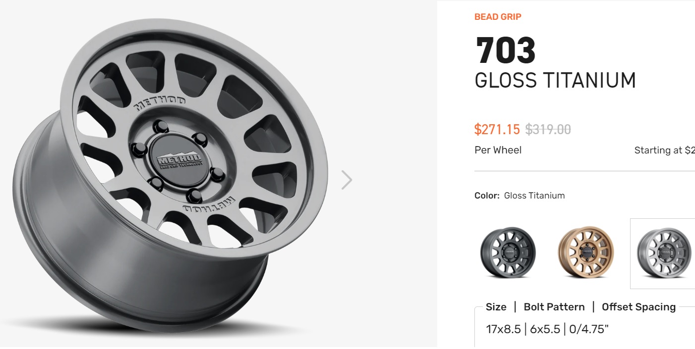

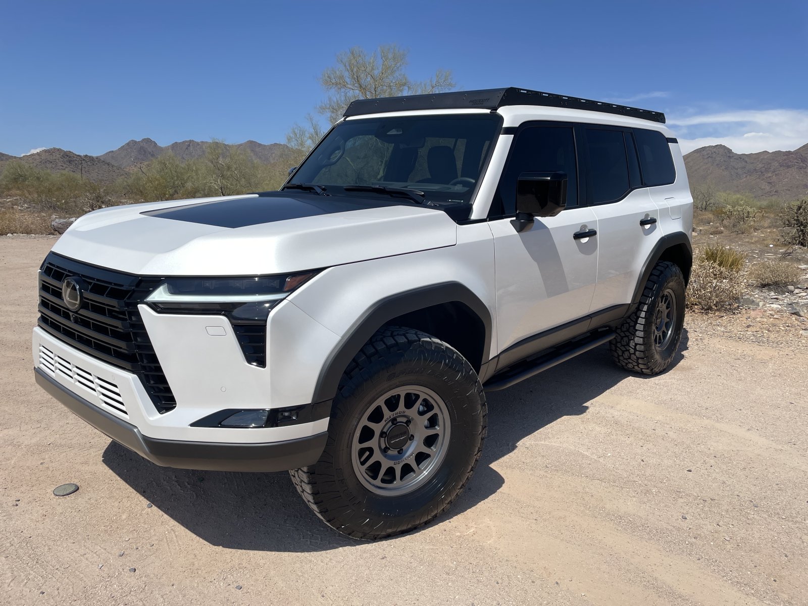

I went with Titanium Method 703s.
I picked up a set of four 2003-2009 4th generation 4Runner OEM alloy wheels for $50 a few weeks ago. They are 7.5" wide X 17" diameter with a +30 offset. My Method wheels are 8" wide X 17" diameter with a +35 offset. I'm using one of the 4Runner wheels as my spare and I'll be taking it to the tire shop in about 500 miles to get my tires rotated and also buy a spare tire - going to try to fit a 33.5" spare (a "34" tire) under the cargo hold in the stock spot. I bought the 4Runner wheels because I'll be selling my stock Overtrail 18" wheels as a full set of five. The best part is that I sold the remaining 3 4Runner wheels for $100 the other day!
Seems like we are very limited on wheel choices if we want some positive offset, but I really like the 703s that you got. I like the 701 the most but not sure it'll work for this.
I also wanted the 701s but they don't have an application for the GX550 (offset). The 701s have 8 holes vs 12 on the 703s and they look less busy and easier to clean. I was going to go with the machined clear coat (silver) finish in the 701s. I also like the bronze color but my wife made fun of it - compared it to the out-of-style brass faucet finishes in our master bathroom (that is now about to be remodeled).

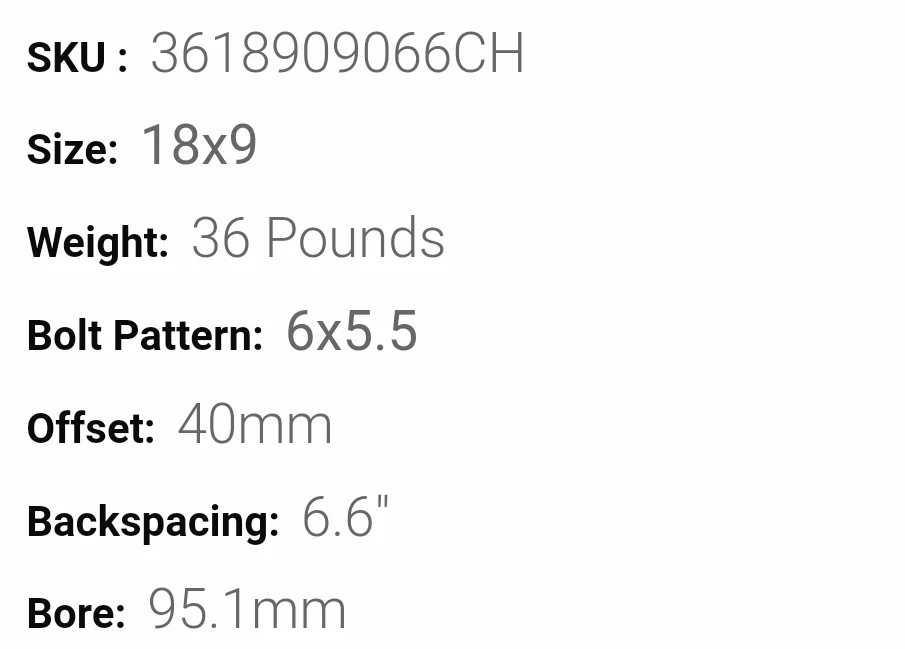

Here's another wheel option that some are overlooking

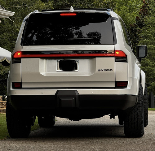

I had to trim my lower black plastic on the bumper. I'm running 35x11.50r18 and 2.5 lift on the front.

Westcott recommends an offset of +35 to run 35x12.5x17. That's what I have with Method 703s.
I'm running 35x12.5x17" on Method 703 wheels with +35mm offset.
Would the 703s with the +35mm offset look good with 33s? No plans for 35s. Would it rub?

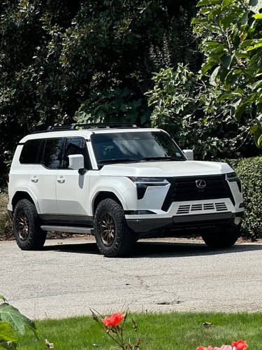

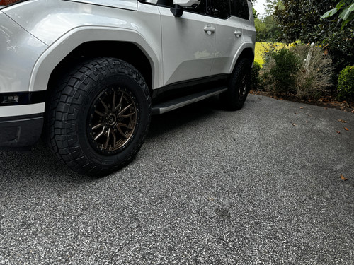

Fuel Rebel 6 Matte Bronze wheels 20 x 9 with 20 mm offset, wrapped with BFG AT KO2's in 275/60/20. No other modifications were necessary. Unbelievably happy with the Nori Green/Bronze combination.

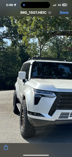

This looks great! Do you have any other shots from the front? Trying to see if wheels are sticking out from fender much. And if that will cause any debris slinging out/wearing out paint more. The
Much appreciated! The wheels and tires just got installed yesterday and this was the only shot I got before I dropped it off to get PPF installed to protect the paint from chips and scratches. I believe the offset and tire size only pushed the tires out about an inch and the fenders on the Overtrails have extra width due to the plastic fender flare. I’ll post some more pics from different angles after I get her back in a couple days!
I think they'd look good. I doubt 33s would rub since 33s are standard equipment. The +35 offset is a bit different than the stock wheels' +50 offset but not much.
