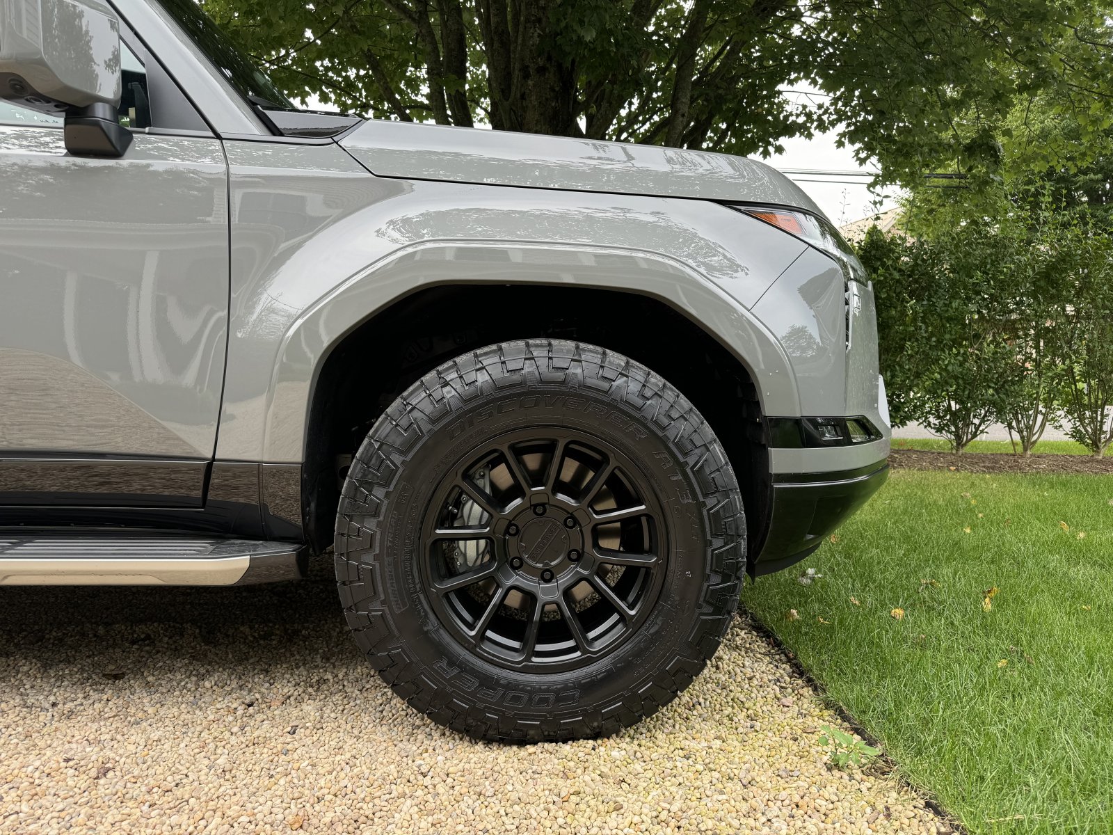

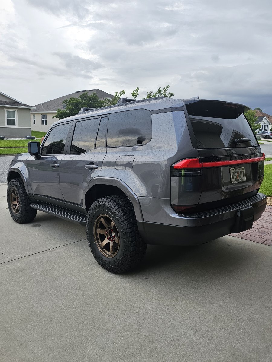

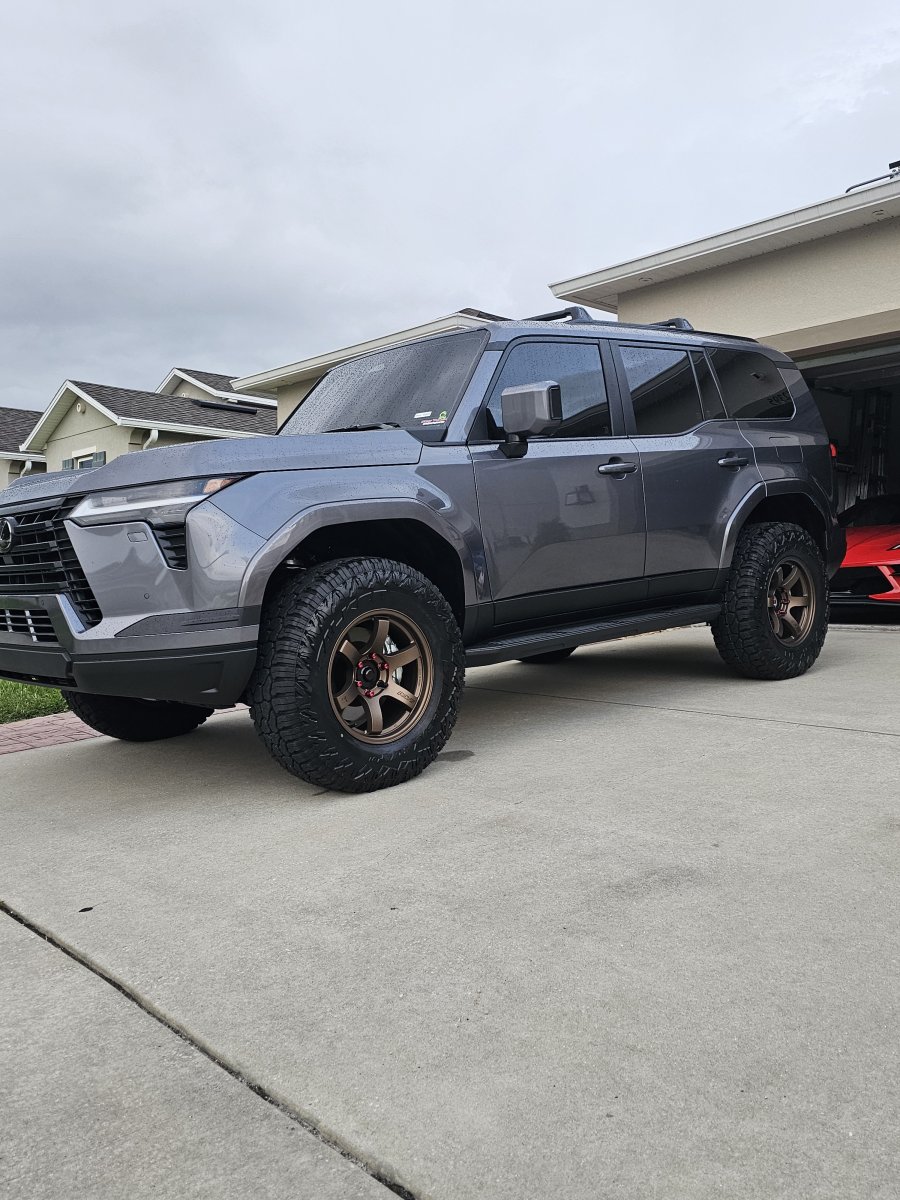

Patiently waiting . 18x9 + 20 offset . Going to be running 35x11.50R18 load c Falken RT-01s

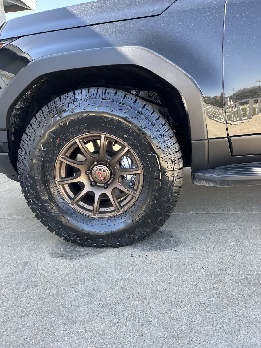

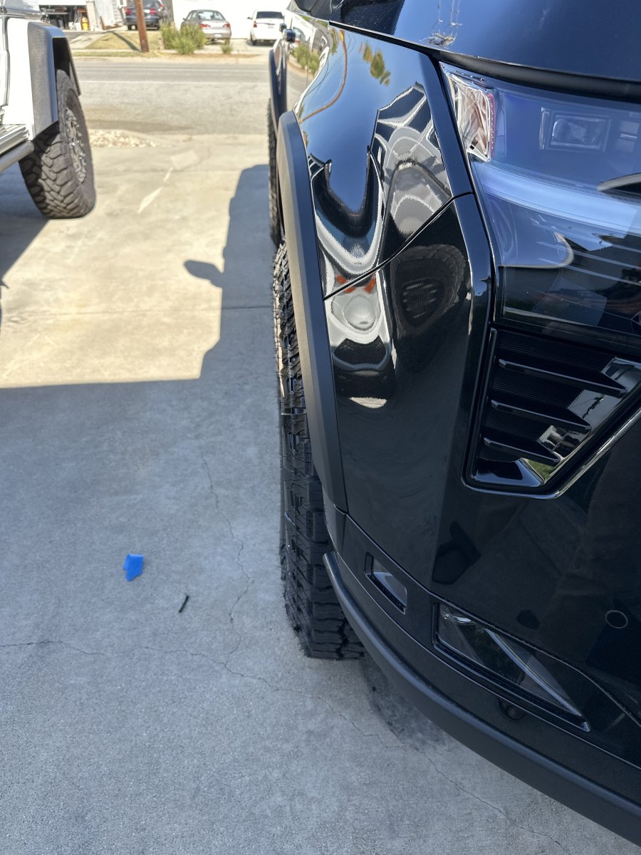

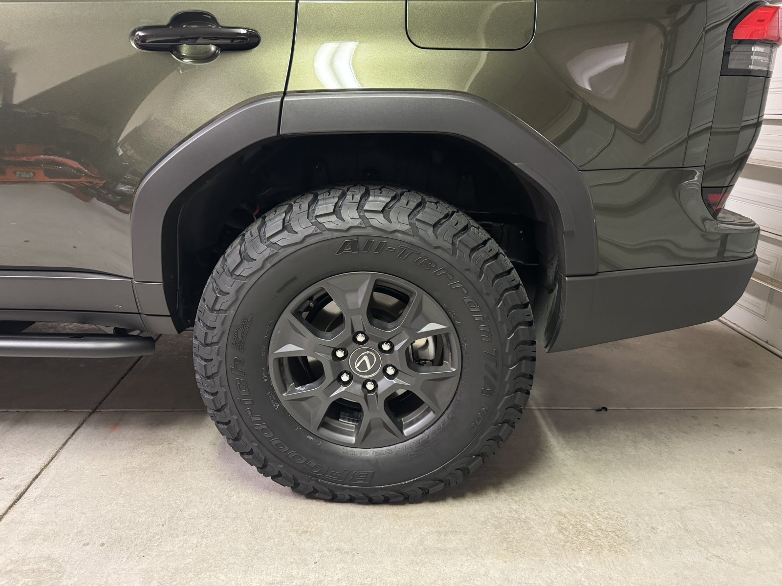

I was able to fit 285/75 R18 on the stock overtrail wheels. No cutting, but did need to remove some brackets in the wheel well. No lift yet. Spare does not fit so I’m still trying to figure that out.

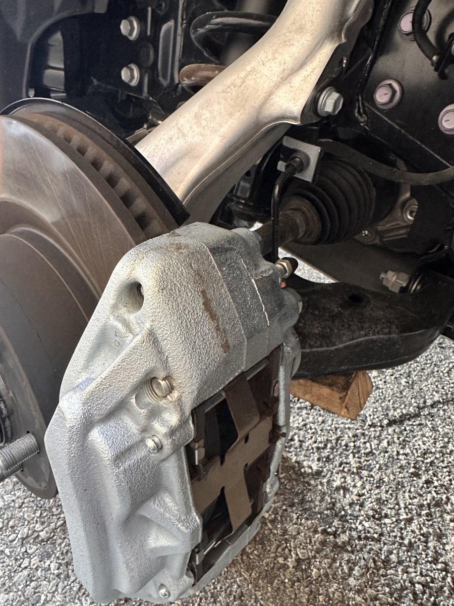

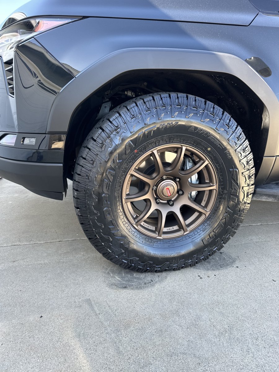

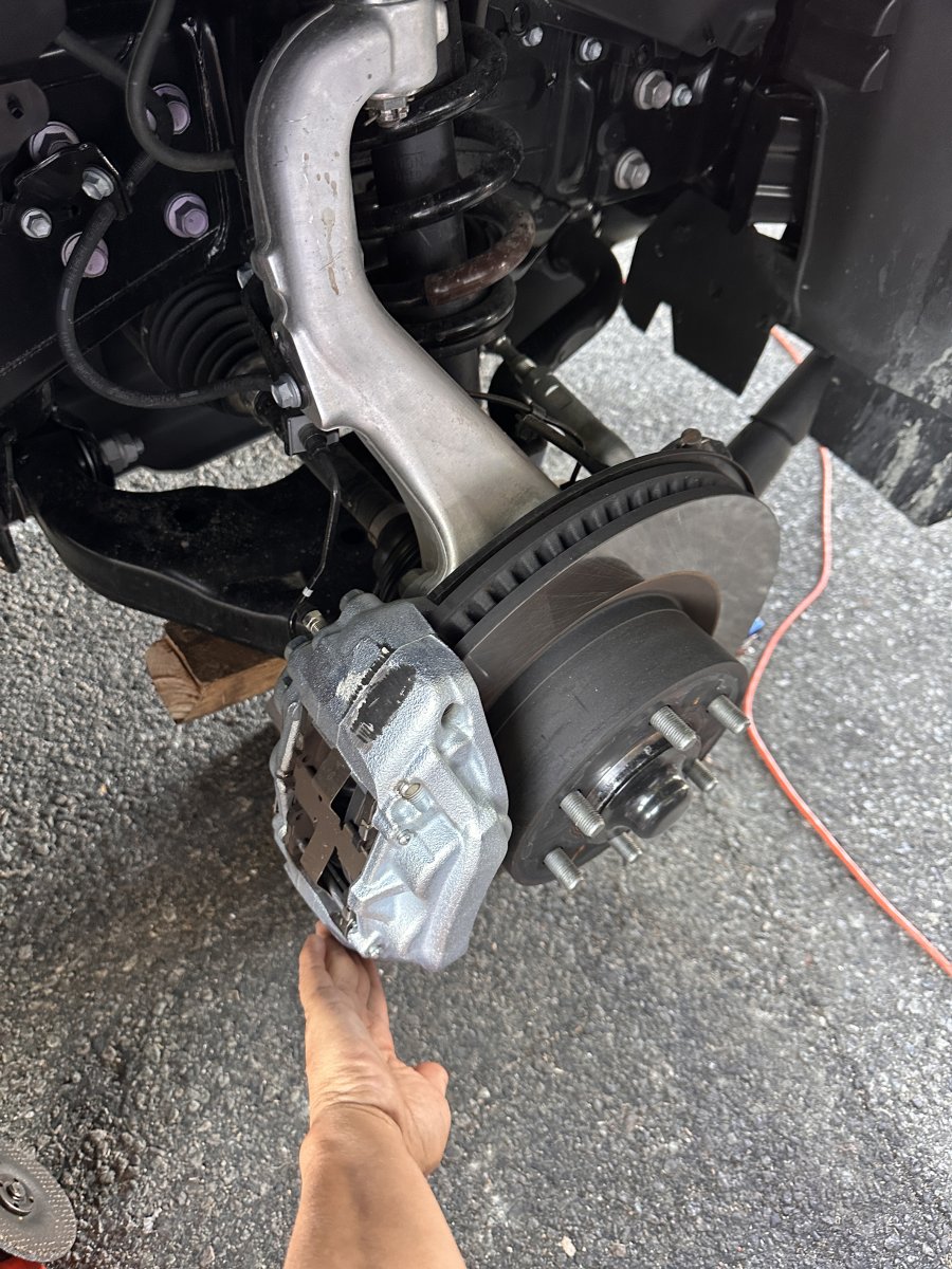

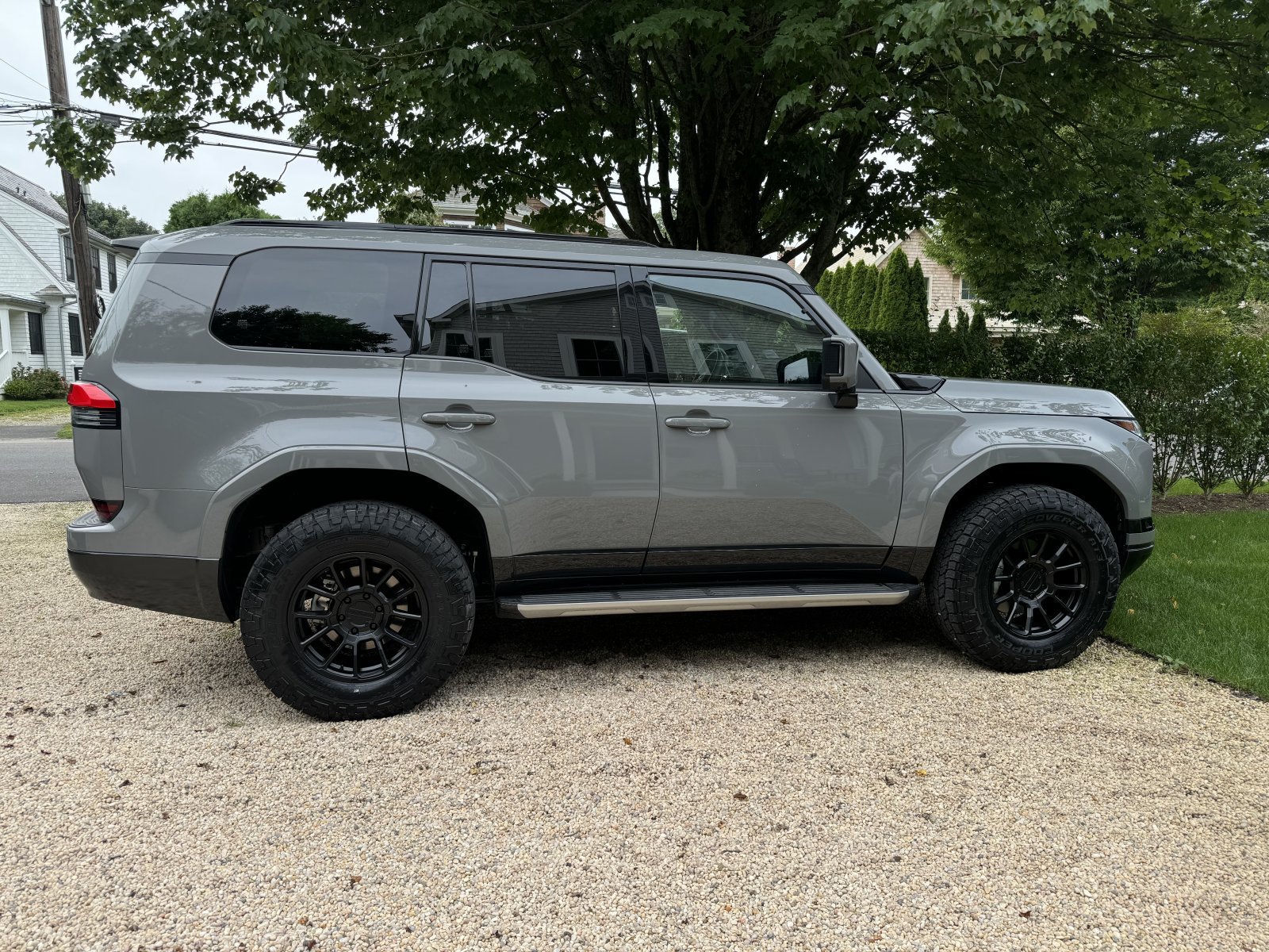

Gram Lights Tranx - Overseas (17x8 ET+20) - 35x11.5R17 Wildpeak AT4W. Definetely need to do all the mods that Wescott Design recommends to fit 35's. Brake calipers had to be grinded down in certain areas to clear calipers from rubbing. This is without the lifting colars.
