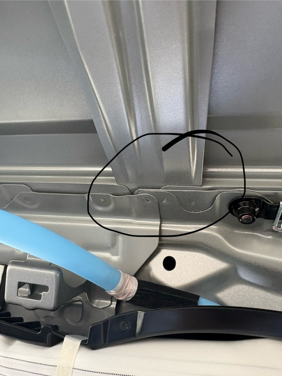

Here’s a picture the Service Director just sent me of the problematic area:

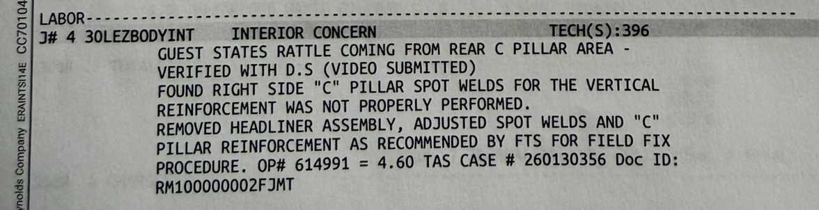

They finally found the culprit of the ticking noise. I had to get the service manager involved, and he was able to dive deeper with a technician and finally replicate the noise from the B-pillar. Annoying part about this was that I called Lexus to open a case and they told me to kick rocks; they can't do anything about it. I had to push the service manager to get something going. They, at the dealership, internally opened something with corporate/Japan (their explanation was that someone from Japan would advise on how to fix it). Finally got the call earlier this week and they found the spot welds in the b pillar was not at spec. So, this whole week, it has been at the body shop getting the spot welds re-welded. I will post technician notes and service notes when I get the car back.
I must say this whole process has been annoying because of the previous rudeness and gaslighting of the service advisors saying they cannot hear anything. But, after over a year later I think this issue can be resolved. Toyota has a serious QC issue with their spot welds, just based on things in here with the C pillar, B pillar, Roof, etc and the LC forums. Other models like Camry and corolla have had spot weld issues as as well. They need to TSB this shit or recall it.

Although mine was intermittent Lexus still performed a “field fix”. Confirmed bad weld in passenger side C-pillar area
