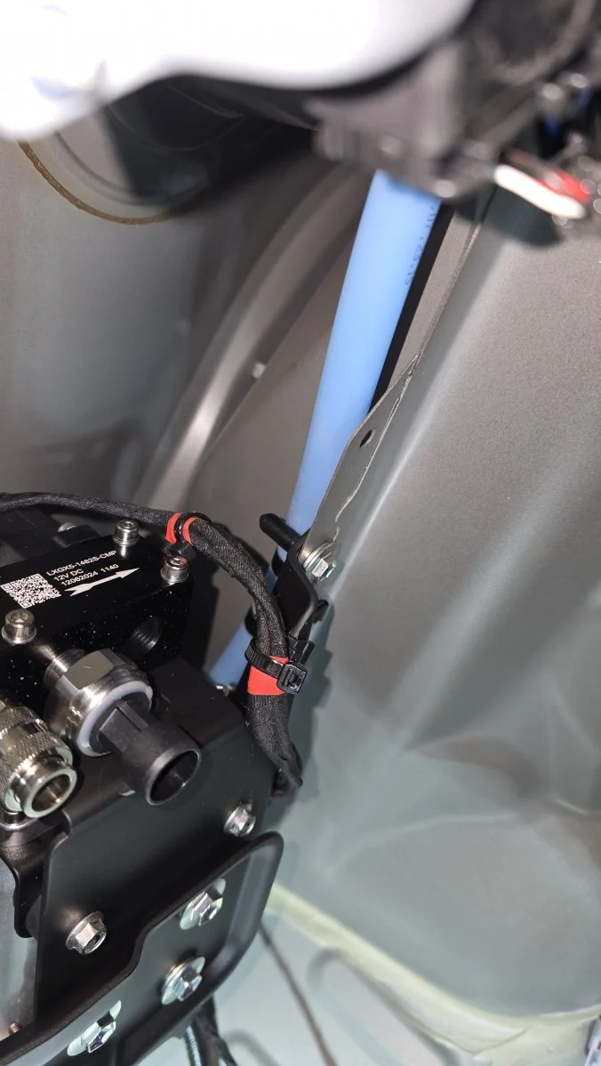

You’re write up and photos were super helpful. Finished my install today. Went smooth, longer than 45 minutes, but I’m maniacal about those trim clips and not breaking them. That’s a big piece of plastic to reseat and took 2 tries to get all the trim clips seated properly.
It’s very elegantly integrated, no regrets…
Any idea where that little black rubber cover/nipple thing was to be installed?
I figured it went over one of the bolts holding the compressor to the wheel well.
I thought there drain hose was a little close to the exposed threads.
