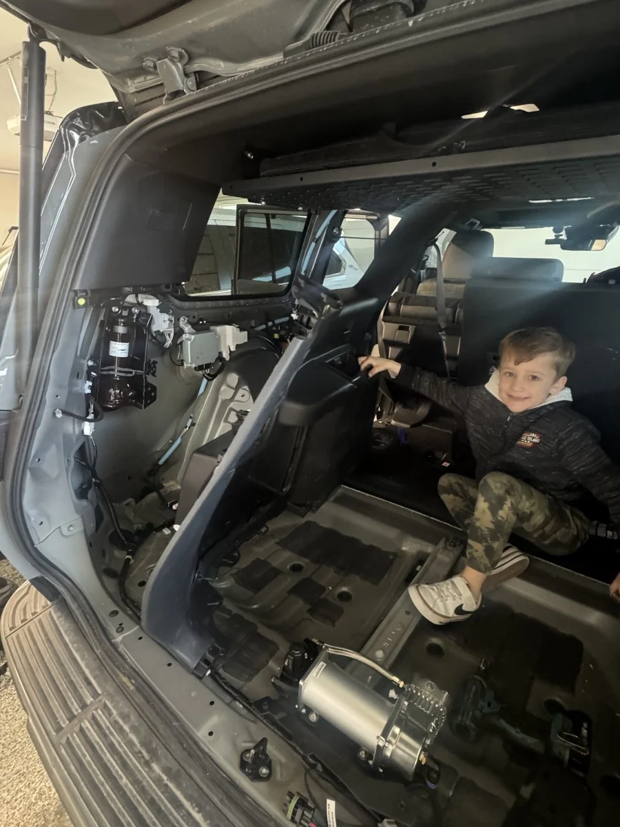

I completed the install today. I couldn’t find a writeup online so I’ll give a quick one.

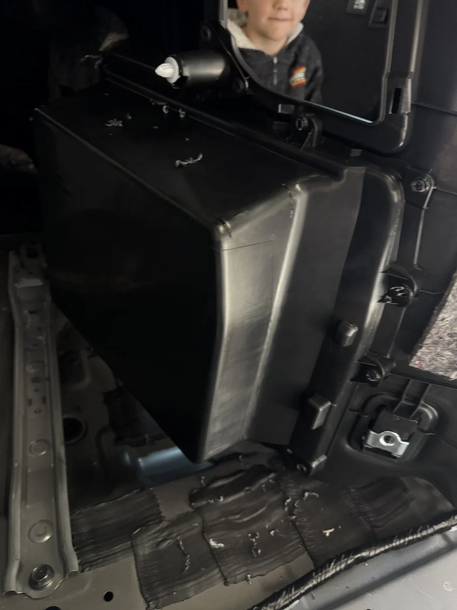

You will need to pull the rear cargo floor first, then remove the entire side plastic panel. Easily completed by removing lower seatbelt bolt and 3 10mm fasteners.
You will need to drill out the melted rivers on the cubby. Do not over drill as it will come through the front of the panel!

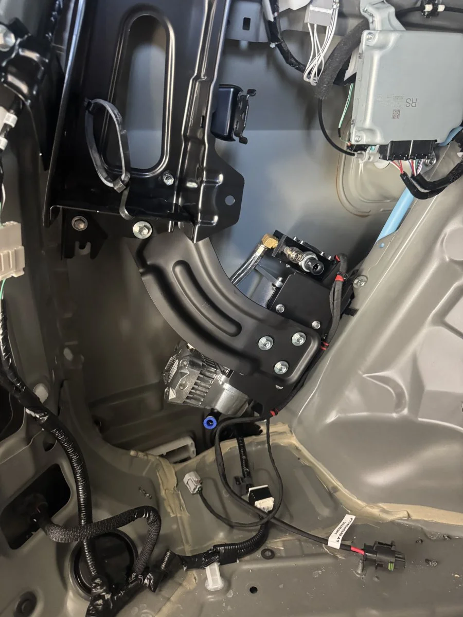

Once removed loosely and install the 3 provided screws to affix the bracket to the compressor. Interlace the nutserts on the right side and bolt the 3 fasteners through the body. The bracket is bolted to the inside of the jack cradle.
There is one plug that plugs into the panel and the rest go between the panel and the compressor.

Thanks for the pics. Was everything needed included with this part number? PT94960240
Yep. Turnkey. 45min start to finish. Also the floor board has a tether below the plastic tub. Another 10mm bolt to remove
