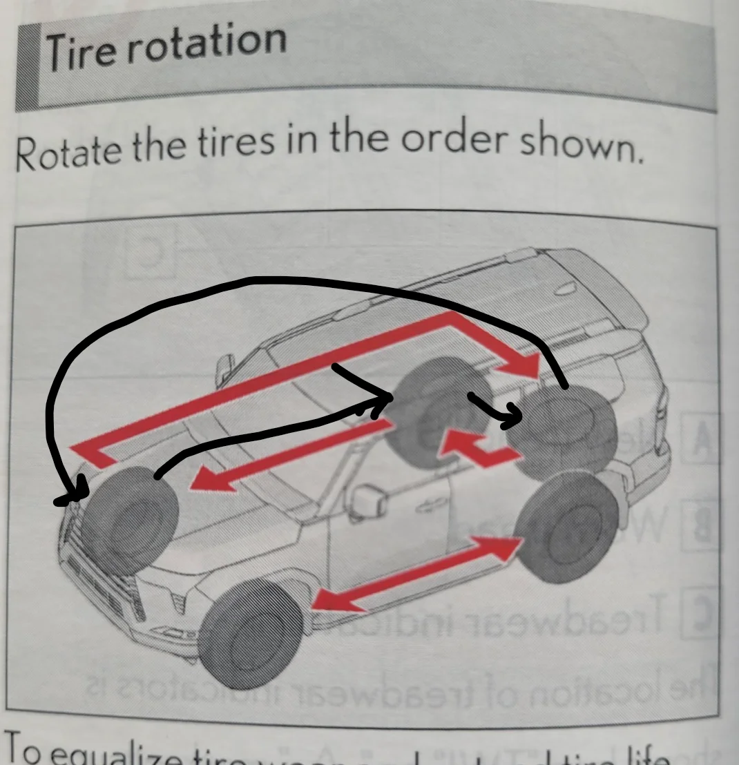

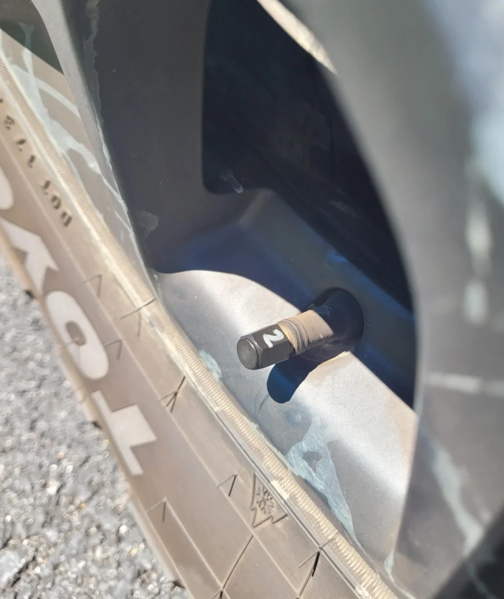

I installed the Toyo ATIII EV version in 275/70R18 about 4k miles ago and they're great. When I recently went in for a Free Maintenance service, which of course includes the tire rotation, I decided to use a metallic silver Sharpie to number mark each valve stem cap so I could verify they rotated and see what pattern. I had to ask for the 5-tire rotation and they admitted they would not have done that. Funny is that they rotated the driver side tires as per Manual (swap front to rear) but on the passenger side they put the spare to front passenger, instead of rear passenger per the Manual, and put the passenger rear into the spare space. Doubt it matters, but would think they'd follow the Manual. They also inflated all my tires to 40 psi cold, when I had them set at 36 psi. No idea why they did that. Seems there's no agreed upon way to rotate tires.

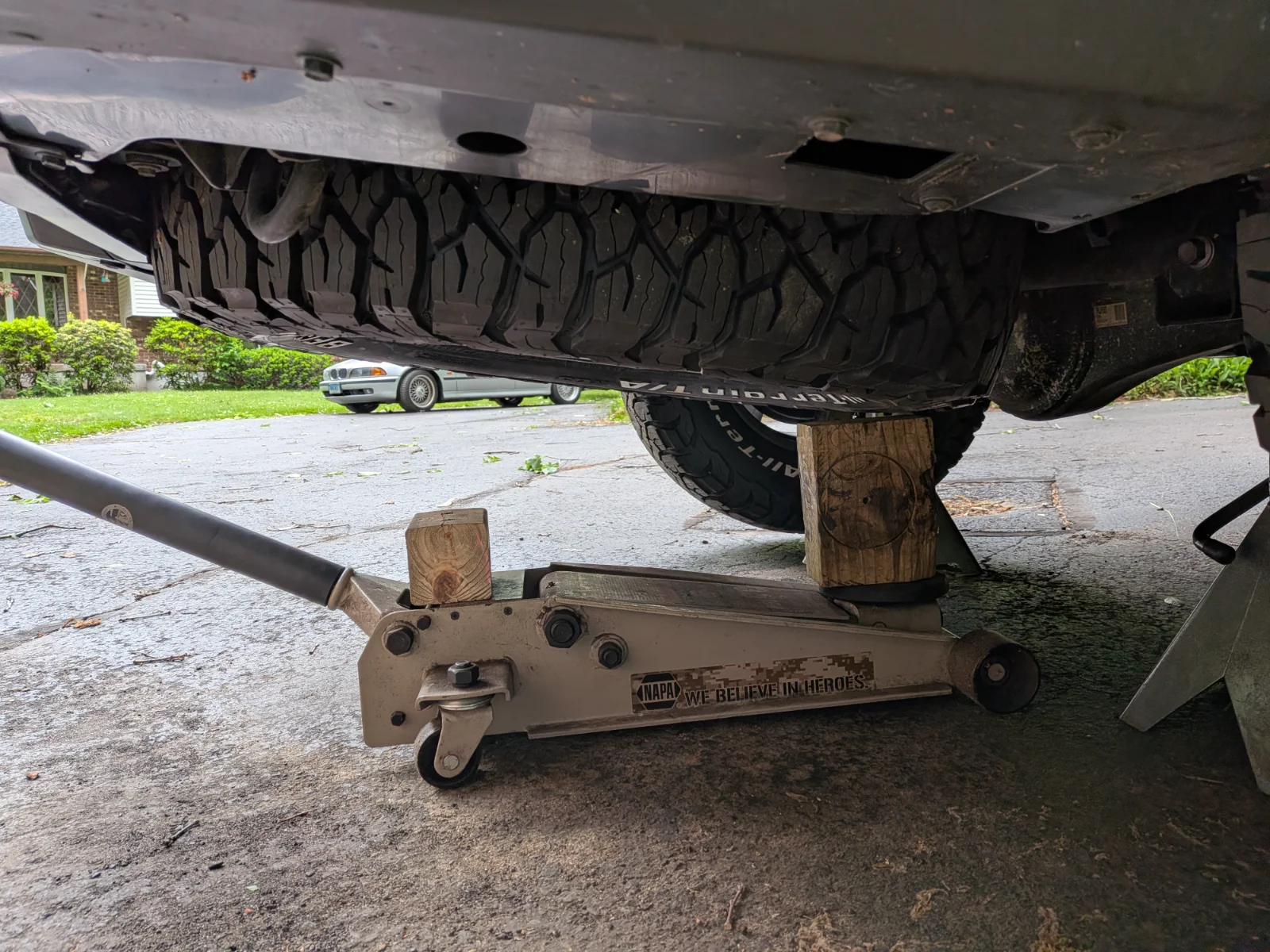

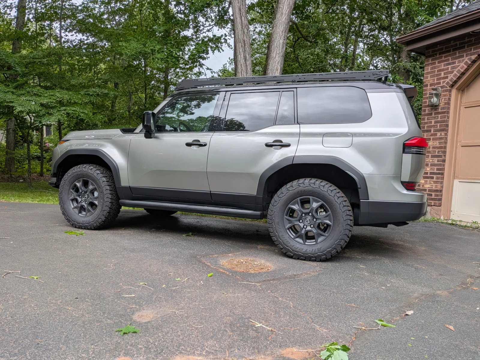

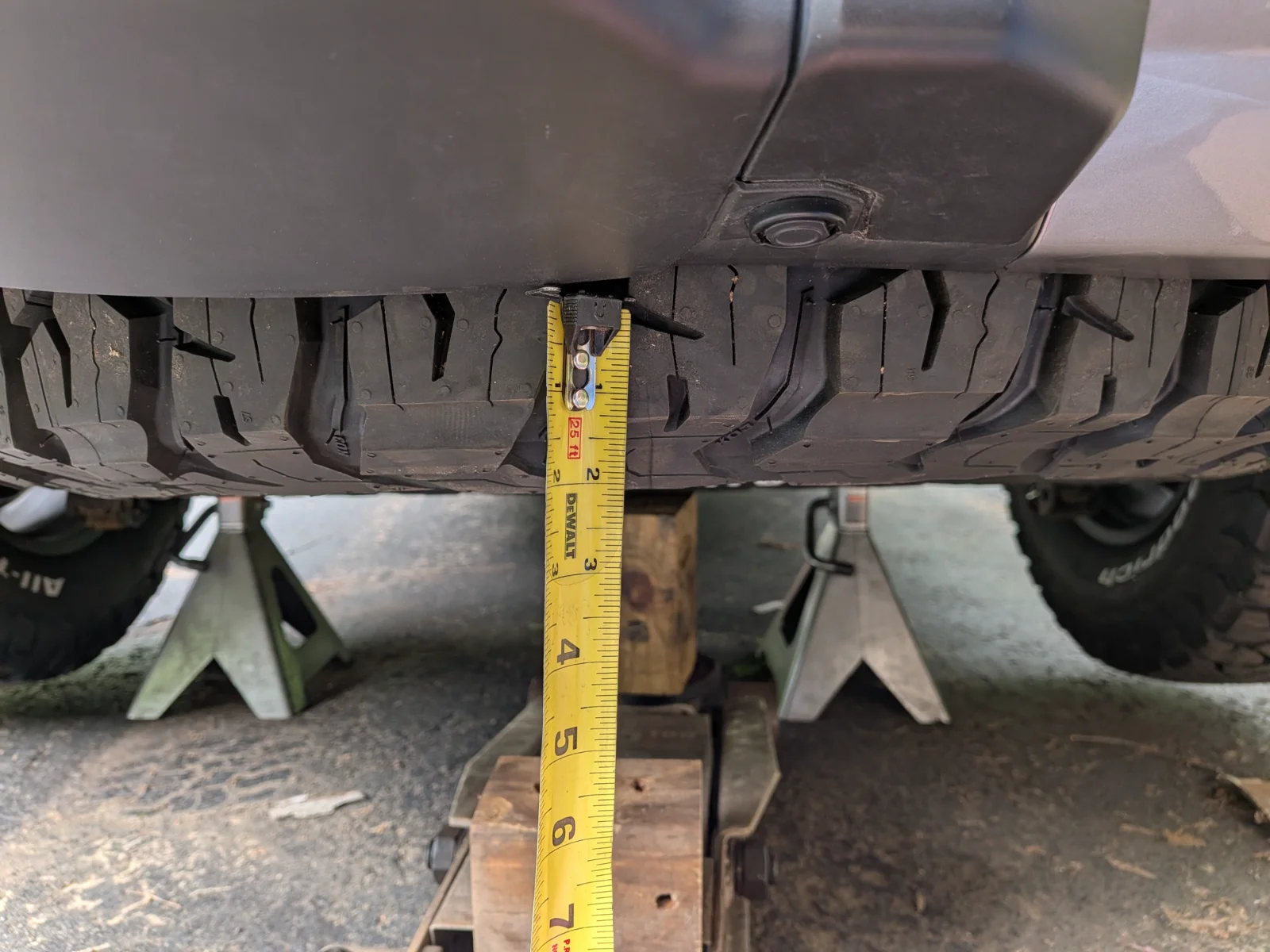

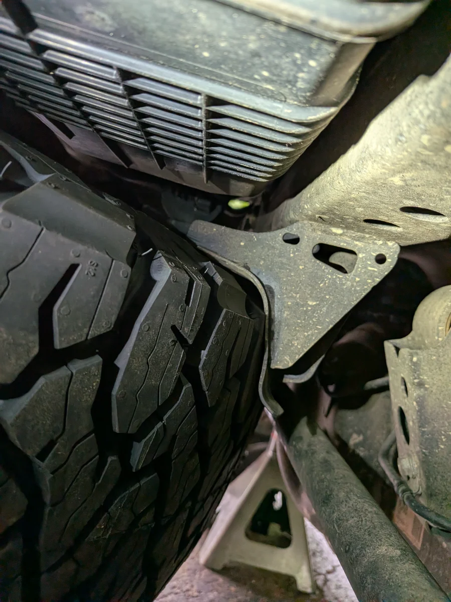

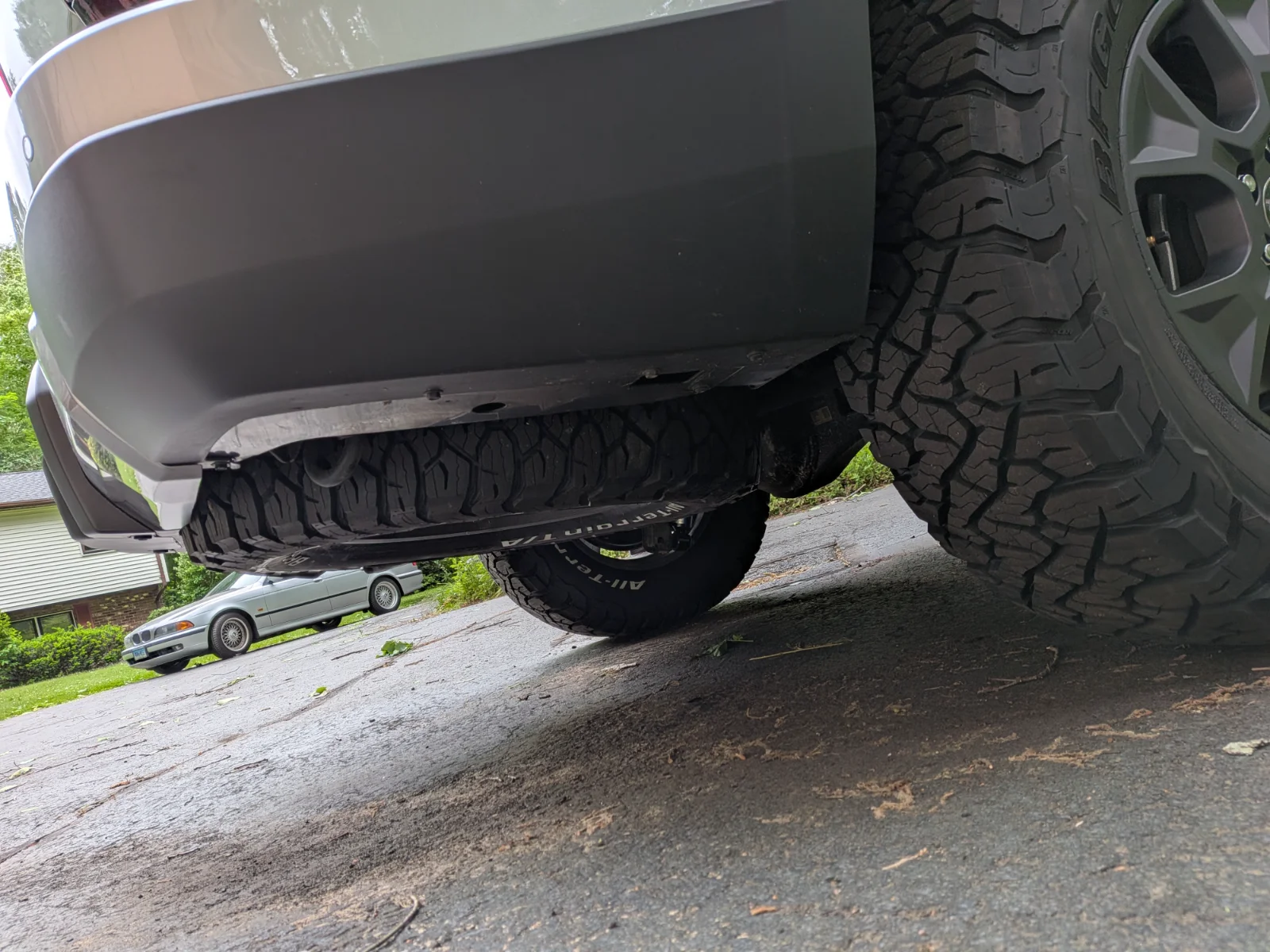

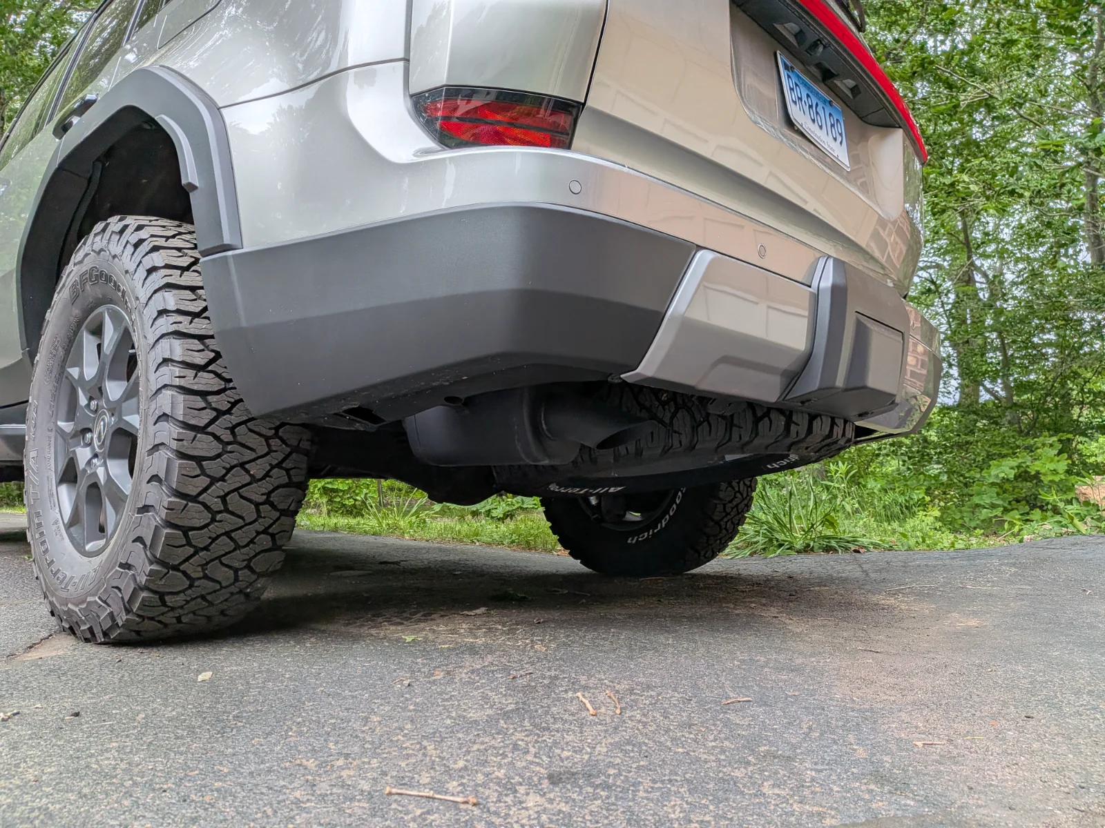

I recently upgraded to 5 BFG KO3'S on stock GX OT wheels. Have a 2026 suspension now as well. No rubbing at any flex or wheel turn. I was able to get the full 34" spare to fit by airing it down and using a jack to push it up into the two brackets before cranking up the tire lift. After up, I airing it to 25psi. May leave it lower since I have the compressor on board. I then reset the air pressure in the system settings to get the low pressure light to go out. Running at 36 PSI and 40 with load. No trailer just gear and full RTT and kit. Aired down to 25 psi on rocky trails to smooth out ride nice. Tire keying at 25 is very good for E range tire. Road noise is slightly more but still less than the side mirrors and rack. I did have to road force tires and return a couple to get balance right. Consistency of tires may be questionable. Vibration was noticable until I got it sorted.

That looks great and nice job fitting the spare up in there!
The high runout/difficulty balancing has been a pain point for BFG since 2000; somehow 3 revisions and almost 3 decades have passed and BFG's are still universally troublesome to balance.
Now that they are set I am very happy with the ride, look and traction. The on line tire shop (Tires Easy) supported a return and new tires which was great. Thanks for the feedback on the rig build as well.
