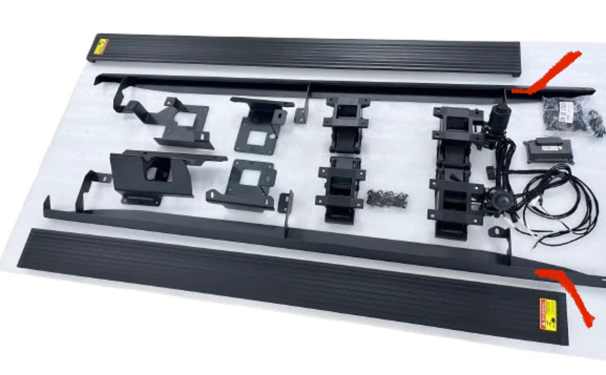

It has this 2 brackets that cover the space between the vehicle and the steps. Makes it look extremely clean (see red marks)
Also check the different brackets, for the btackets (2 on the left side)
Kdss is connected front to back. Do you have an OT? What other purpose could those devices serve?
Are you saying the new power boards are connected to those compressors? Or are they just installed around them?
I know you are out but pics of them installed would’ve really helpful
The are not connected in any way. The big bracket (from the item i sent) are needed to be able to mount the boards brackets to the chassis.

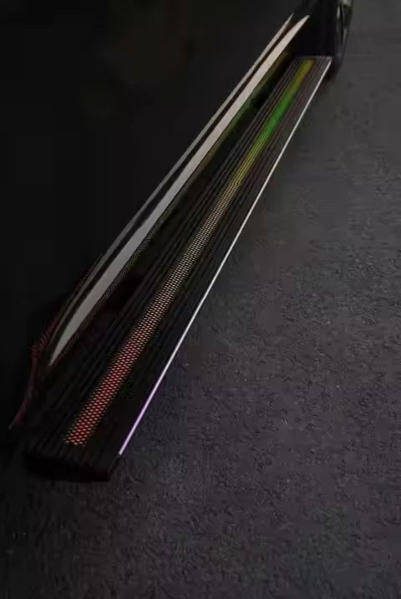

I’m talking to the guy from eBay, vroomify. He must work closely with a factory in China because he gave me two options for led boards.
Single stream and Double stream. I’m going with the Single stream led.

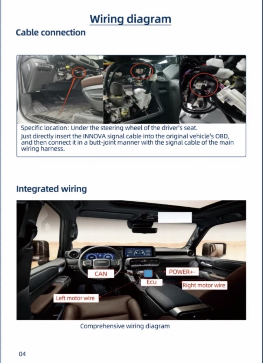

Ask him about
1- Brackets, for the brackets (yes, sounds redundant)
2- If the electrical connection is under steering column or through the passenger connector wires. 100% Easier is the steering column.

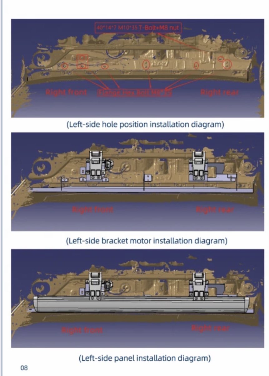

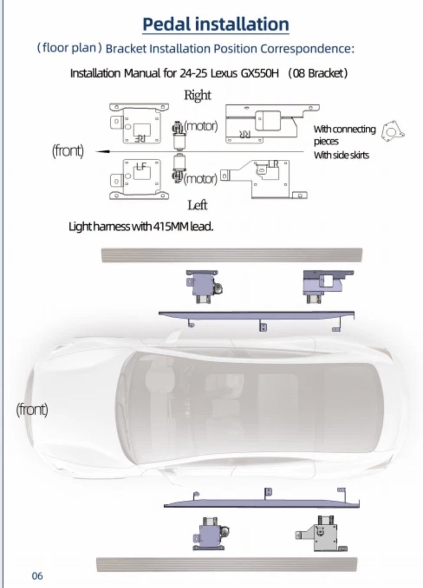

He sent these instructions and diagrams. Very detailed. What do you think?

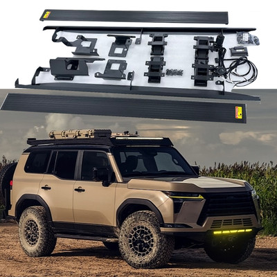

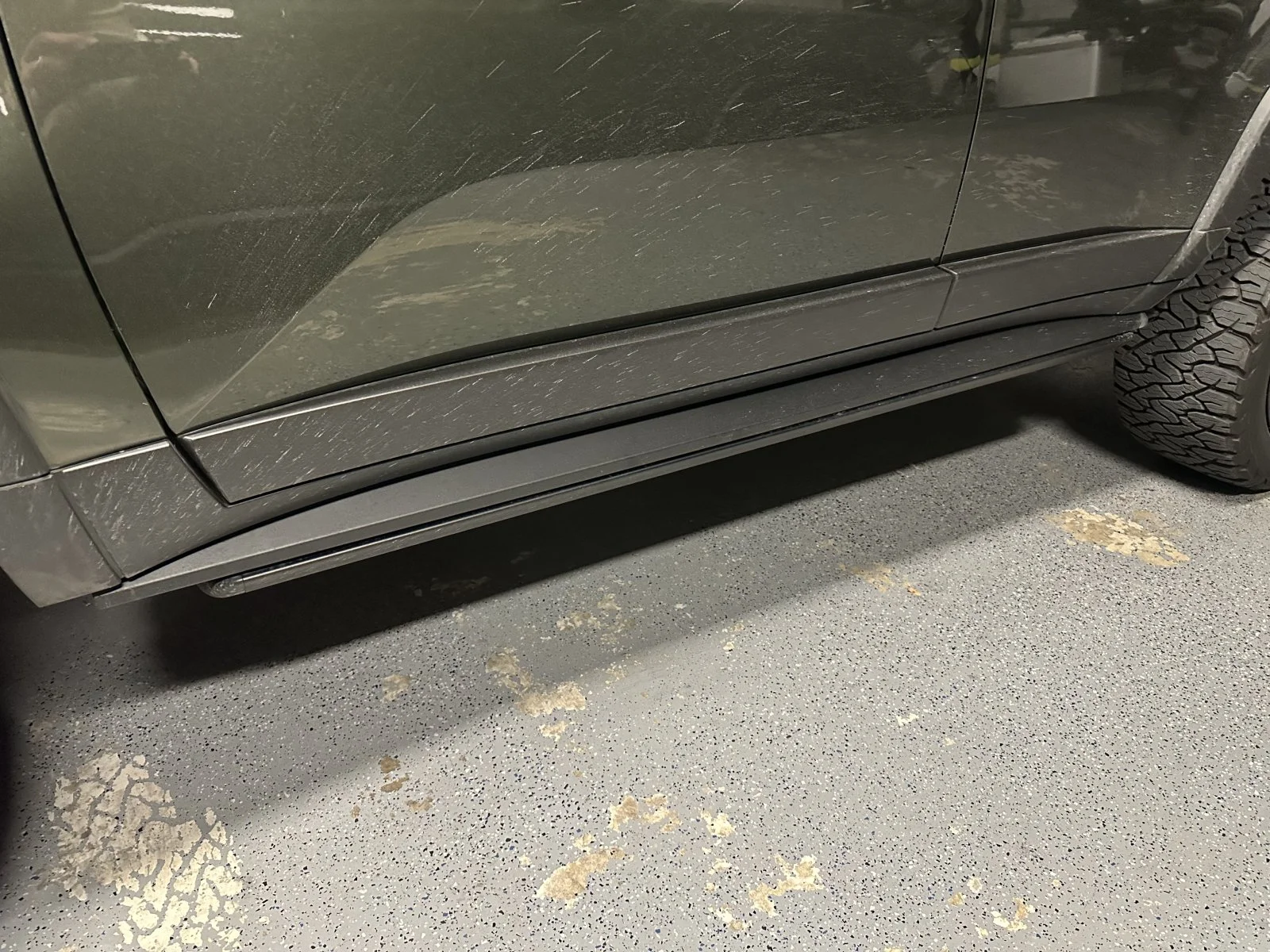

This is a bracket just to cover the space between the board and the vehicle
Looks great in person
(See red arrow in picture)
Thanks for the pic and video! I’m it looks great. My wife is gonna love it. I will post pics and videos when I get them installed.
The bracket driver rear side, install the bolts (bolts for running board bracket) before screwing it to the chassis
Otherwise you won’t be able to put them in.
Install the “cover” as close as you can to the vehicle, try not to leave much space otherwise the boards will rub when they close, and then you will have to make more adjustments.
