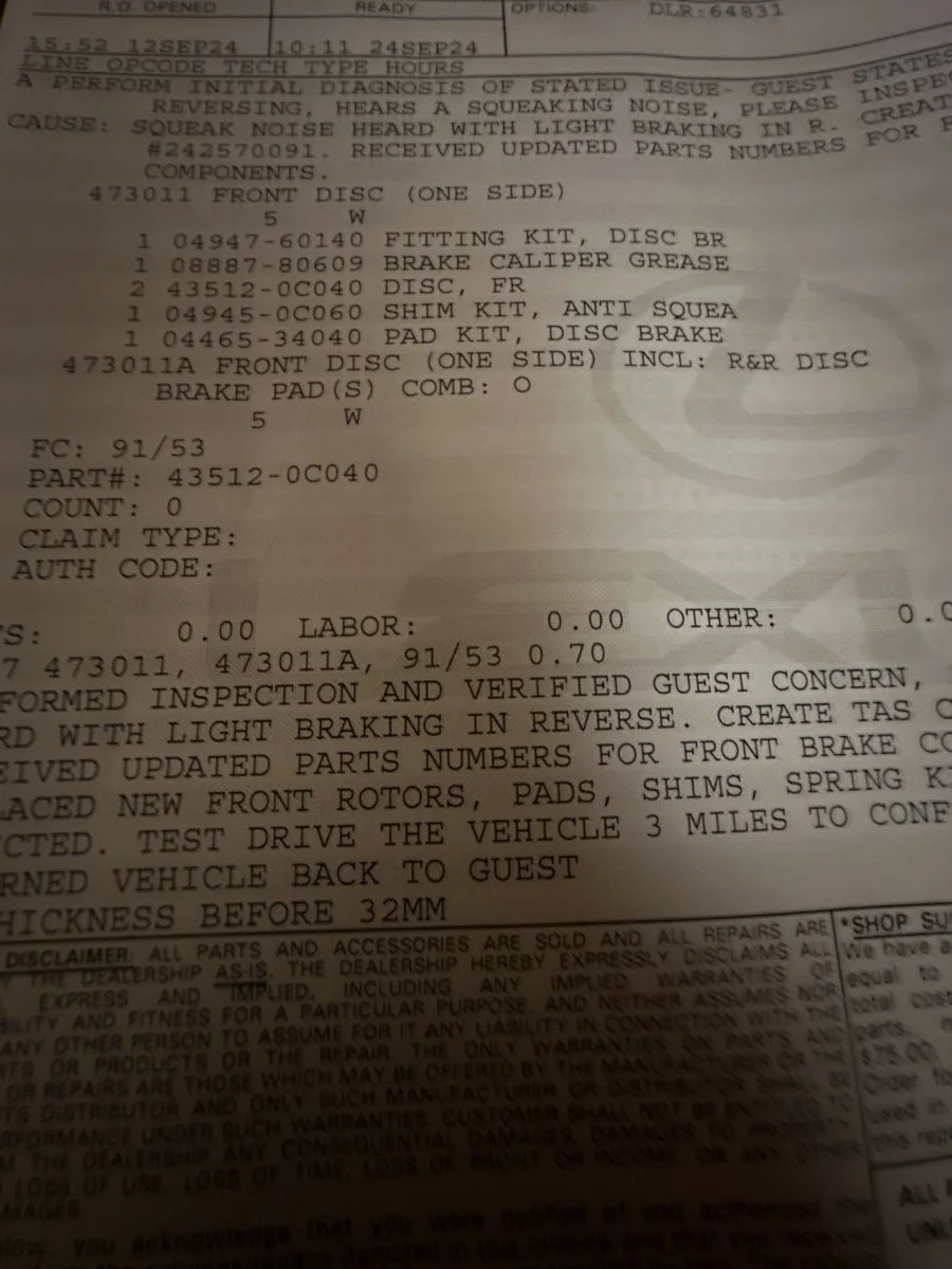

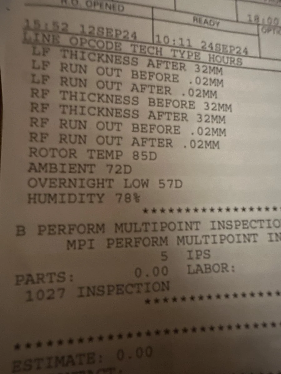

I just pick up the truck and had a conversation with the mechanic, he showed me the tab do tundras and all the parts that they changed, he mentioned that they had the parts order canceled by Lexus due to tundras and sequoias are getting priority.
Since they own a Toyota dealer, they work around and get the parts from their Toyota dealer.
Truck tested and no issues, is being raining all day and no a single problem/noise.
So far I’m pleased, I drove 60 miles and no problems.

Curious what the “fix” was. I have ~500 miles on my LUX+ and experienced it for the first time today (after 2 months of ownership). It was a high pitched squeal only when backing up. It did rain last night so that could have contributed a little to this. That said I’ll keep an eye(ear) on it to see how it progresses.

Confirmed today my brakes are not in fact the updated version (no gold dot). Hoping my local dealer comes through, otherwise will have to wait for the TSB
