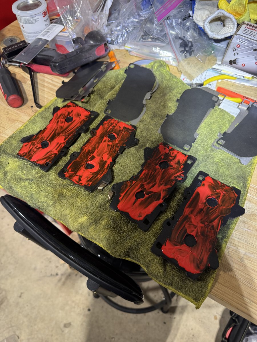

The brakes on our GX started squealing a lot at around 2,500 miles. My dad (Toyota master tech with 40+ years under his belt.) suggested applying some “CRC Brake Disc Quiet” between the shims.
It’s been a week since I applied it and we’ve put around 500 miles/parked overnight in 30-60 degree temps. Happy to report no sounds!
Hoping this can be a temporary (maybe even permanent) fix for those dealing with backorders.

1 MONTH UPDATE: It has been exactly 1 month since we've applied CRC gel. We have driven the GX around 2,500 miles in temps ranging from 15F-60F degrees and have not heard a single squeak. It's been quiet as a mouse in all the conditions we put it through. I'm going to go ahead and consider this an adequate fix for the squeaky brake issue but will keep an eye out for anything in the future! Happy holidays everyone!

Do you have any experience with CRC regarding its long term durability? This is the first time I've used it but I've spoken to multiple technicians and product engineers and they all say it's supposed to last the life of the pads if applied and cured correctly.

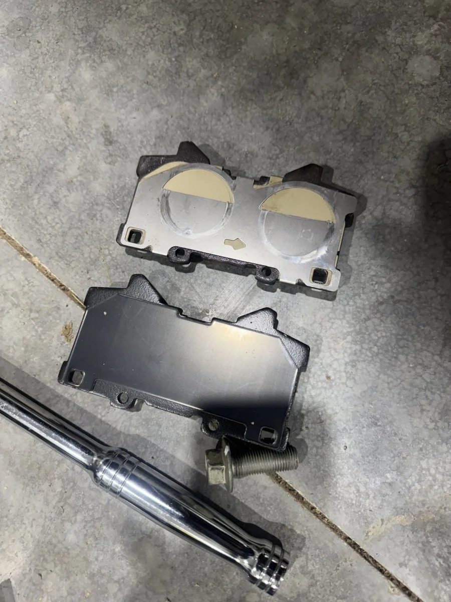

I replaced mine with new pads and rotors. You can see how the OEM pads (Top) are sliding around on the pistons and what’s causing the shrill squeal. Total difference in feel once replaced. No more grab/jerk at a stop and no squeal in reverse
