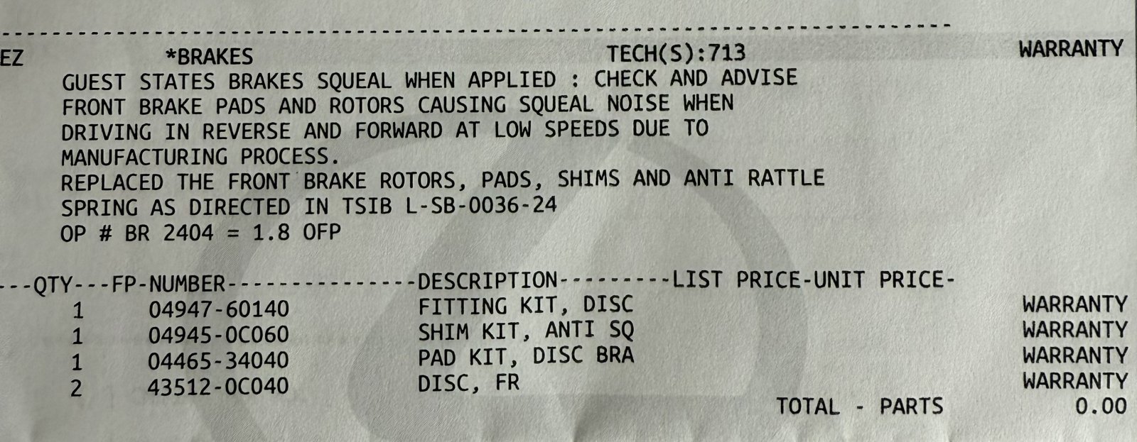

Your dealer should have the info on the brake replacement TSB or recall. Not sure which it is but either way Lexus is slowly getting updated pad/rotor sets out to dealers for replacement under warranty. Taking mine in soon for the same issue.
Has the OP left the building? Would be nice to get an update. In their last post, #40, they say the rear brakes were replaced but other posts said just the front. I'm assuming they just had a typo in that last post.
Its just the fronts. This is my actual work order.
Apologies if the TSB has already been posted. I scanned back through this thread and couldn't find it. The link below is from another forum where the whole TSB for front brakes is posted. I wasn't able to copy and paste the pdf hence providing the link. Hope it stays active for a while.

Mine are getting replaced this week. Thank you for posting this. I now have a better understanding of what is involved.

I was told 4-6 weeks. I’m going to just buy aftermarket. To confirm, it is the front pads and rotors?
