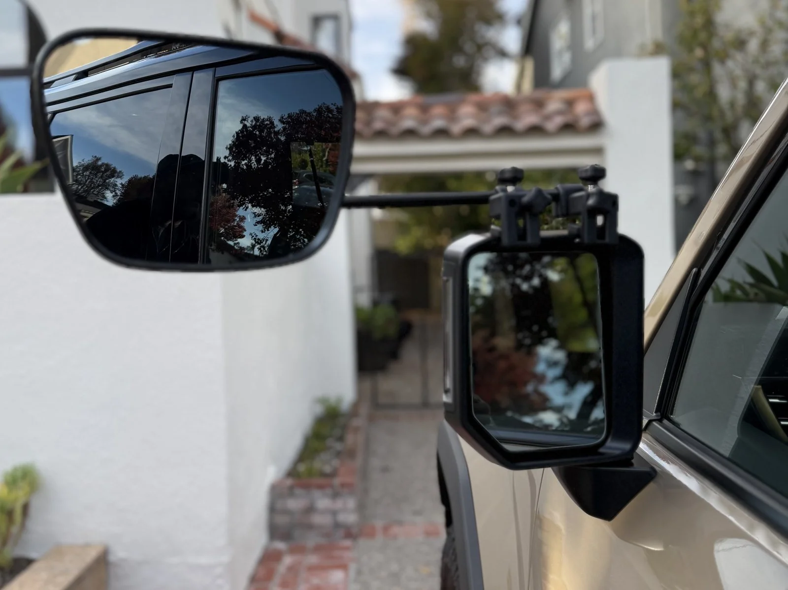

TOWING MIRRORS SOLVED!!!
After several brands purchased then returned, I have a solution that works, extends the mirrors quite a long way for towing a camper, and still allows the mirror to self fold without banging into the door. I’m so excited!
Milenco MIL-6613 Grand Aero Platinum Mirror, Chrome, Standard
Bought from Amazon:
Here is a quick picture of the box and a picture of the left mirror after I installed it. The mirrors swivels into various positions, and feels very secure.
