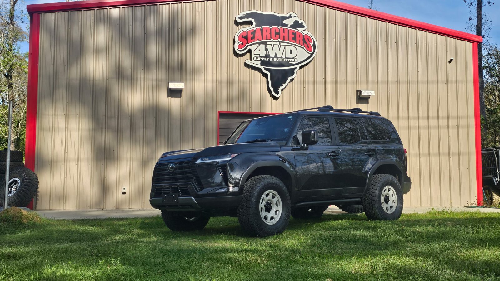

Success!!! I got the Westcott preload collars and Toyo Open Country 12.5 x 35 tires on Black Rhino 17” wheels in Space Grey installed. Used new TPMS sensors from Lexus and kept the original sensor in the spare underneath. I registered these as “Set 2” with no problems. I’m going to run 27 psi in these tires and will reset the system using “current pressure”.
My problem with the snow tires I put on the original wheels turned out to be a broken sensor.
