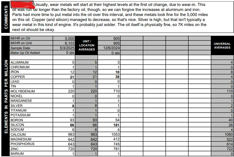

I have also changed all my own twice (@900, 5000) before the 10k service when I let Lexus change the oil. I sent samples to Blackstone Labs (attached) and although the iron, copper, and silver were slightly elevated they its not unusual and the silver was "probably just solder". Kind of wishing I would have done my own at 10k, but oh well. We've had zero issues with our GX besides the brake squeal that was corrected quickly and love the hell out of it.
Getting ready to do another 4k round trip back home to PA with it over the holiday and I'll change the oil when we get back and send that one in. Is what it is, I'd buy this thing again 100 times over even if we do end up with recall, although I'd maybe try to trade in for a '26 with the extra 1" and hopefully not the cool box.
