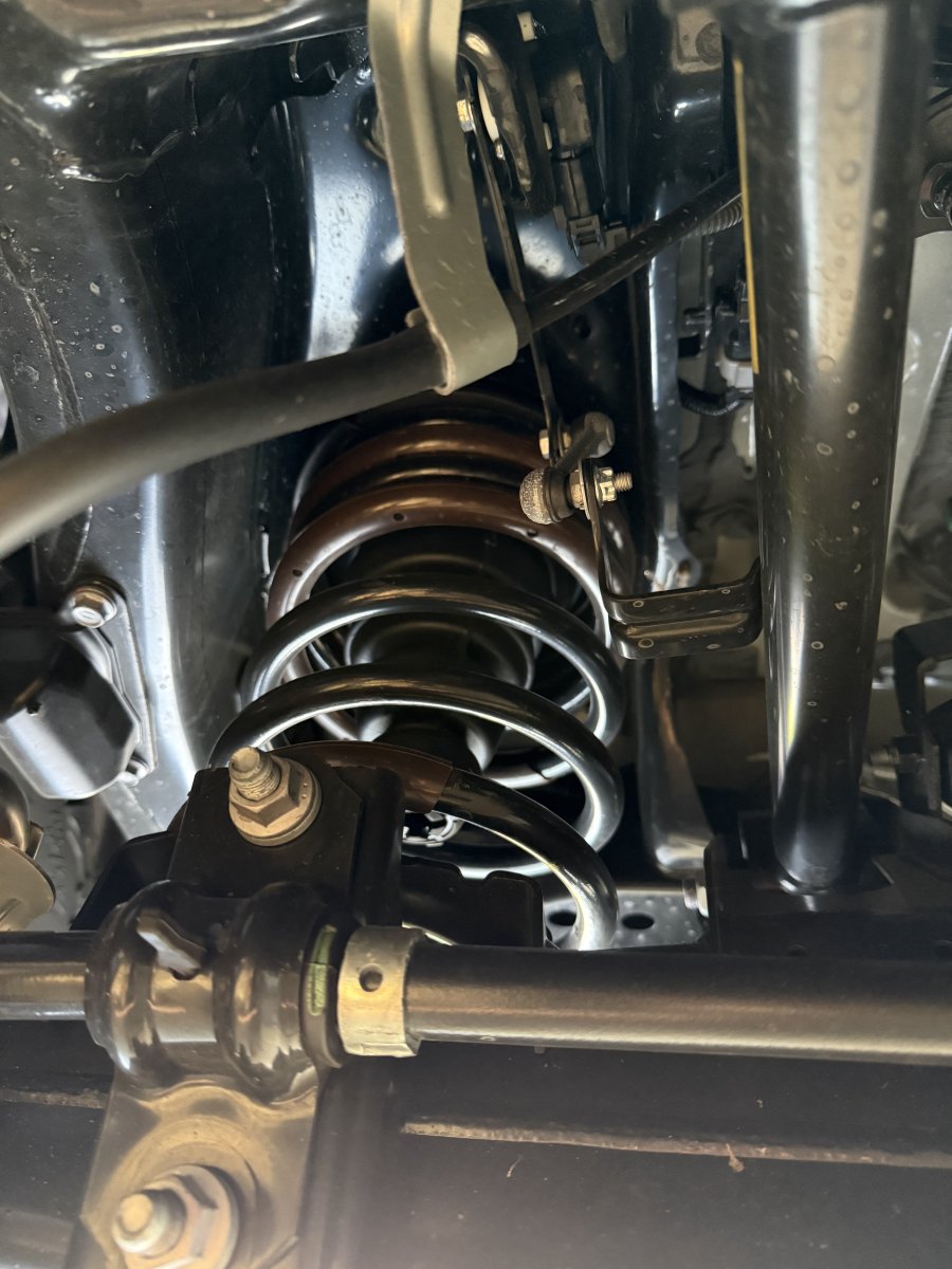

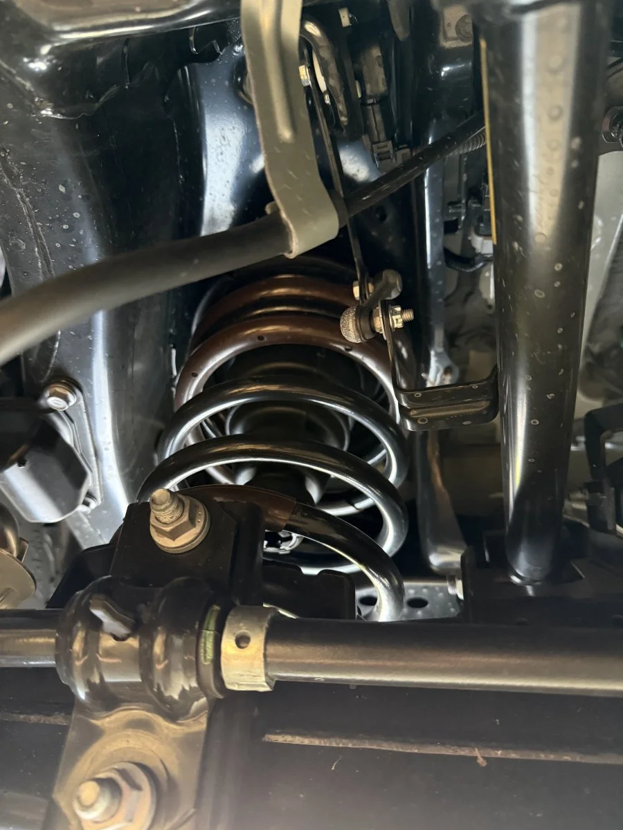

Pass side rear sway bar mount.
Take close look at lower sway bar mount nut - you’ll notice it’s backed almost off, and see where washers are loose.
Can we see this without our truck on a lift? Can we self tighten? Can anyone circle the exact spot ?

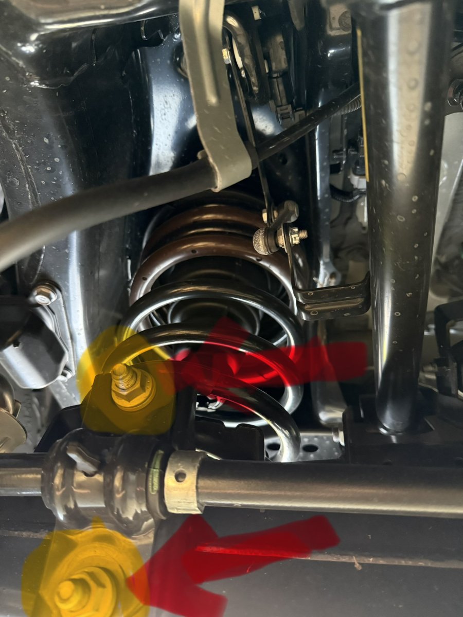

This view is w/ vehicle on the ground/laden
  • this is passenger side from under vehicle looking forward
  • red arrows show you the nuts that need to be checked
  • 2 yellow dots are what need to be tightened on each side
  • *** Notice on lower nut there are no threads protruding as the nut is about to come off, & washer/spacer behind it is loose & you can see pretty clearly where it is supposed to be sitting normally

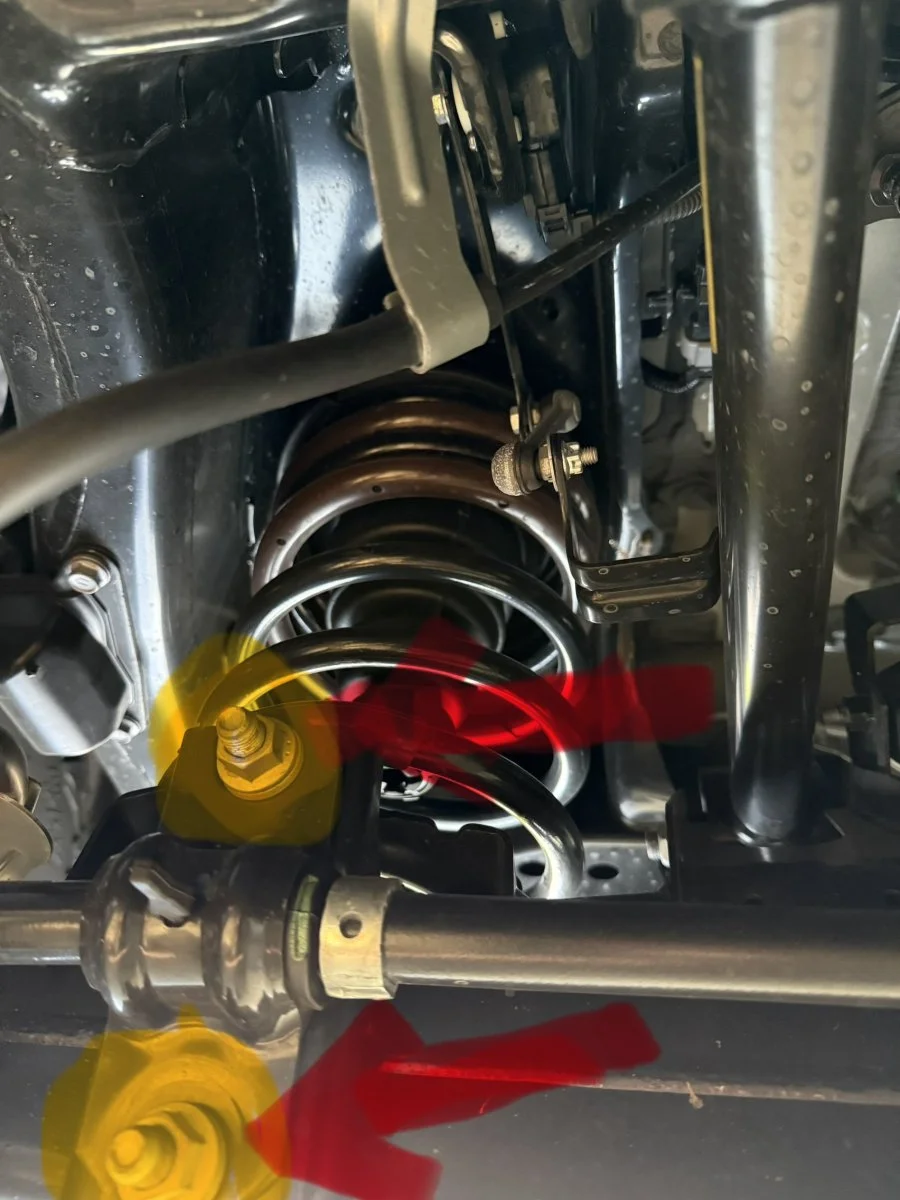

  • 2 yellow dots are what need to be checked on each side
  • * notice on lower the nut is about to come off, & washer/spacer behind it is loose &you can see where it is supposed to be sitting normally

I had a Westcott lift added at time of purchase. This happened around 6 weeks into ownership. Vehicle got very squirrely while driving.
Didn’t know Westcott says all of the parts have to be re-torqued after 500 miles. Check while the vehicle suspension is on the ground, not just unladen up on a lift.
I just learned the same thing from the shop that installed the lift that came with my OT+. They said they tell all the customers to re-torqued and realigned at 1000 miles. They were surprised the dealer didn't tell me that.

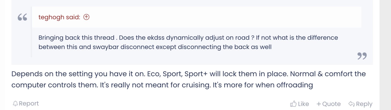

Clunking/loose fitting front suspension problem solved. I came across a thread that explained how to lock the EKDSS in place and switched the mode to Eco and sport mode and it’s now all good. All the research, crawling under the car to look for what other suggested and it was simply a turn of the knob. One of the joys of getting older. Anyways for anyone else with EKDSS and you hear clunking or a loose feeling front suspension just switch the mode.

I would be very interested in knowing what you find out. It seems better when in sport, sport + or eco mode as this apparently locks the KDSS. I plan on taking mine in when I get to the 1k mark and like you hope they can come up with a fix. Maybe thats just how they are or not. Let us know because others have the same issue, not many but some.
