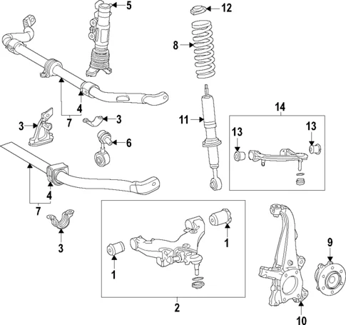

I don't have an EKDSS car, but sway bar end links are always the first place I start when investigating a suspension clunk, followed shortly by sway bar bushing mounts.
I'm sure there are all sorts of weird forces on the EKDSS sway bar, especially as those end links seem to be mounted to the control arm via a bushing, rather than a ball joint, maybe leading to more compliance / flex in some directions than a ball joint would have. I wouldn't be surprised if a few of those fasteners needed to be re-torqued or torqued to a slightly higher spec.
I'm going to do an early oil change hopefully this week (just hit 2k), and I'll take a good look at these components with the skid plate off. Suspensions aren't really in my wheelhouse but I'm hoping I can get my bearings (and bushings!) under there.
edited to add image of OT suspension from here
Once it's safely on jack stands, give each part a good shake in all directions with your whole body weight. If you still can't find it, try jacking one tire (careful!) or one control arm (safer) up and see if you can hear any faint pops or clunks.
