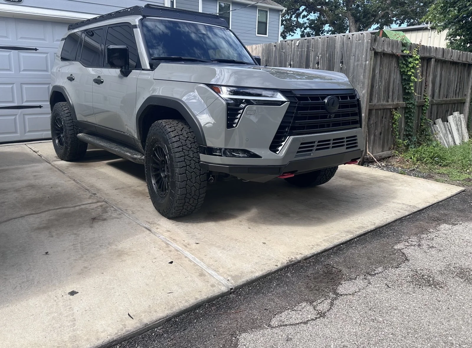

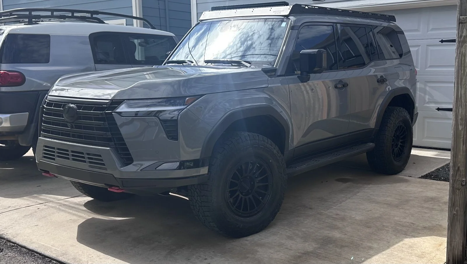

Hey folks, was able to get my coils installed last week. I opted to install Peak’s 1.25” front leveling kit while I was at it. Results are exactly as other have stated (plus the added leveling kit increase).
Wheels are Method MR314 (18x9 w/ 18mm offset)
Tires are Falken Wildpeak AT4 285/70/R18
Fitment note: These are a true 34” diameter tire and I definitely got rubbing w/ the MR314 offset that required additional trimming even w/ the increased lift. Not that big of a deal as I have the NYTOP bumper that required trimming anyway but know that it is TIGHT w/ this larger tire. Other 285/70/R18’s, like from NITTO, are less than 34” and probably would have been a better choice in hindsight.

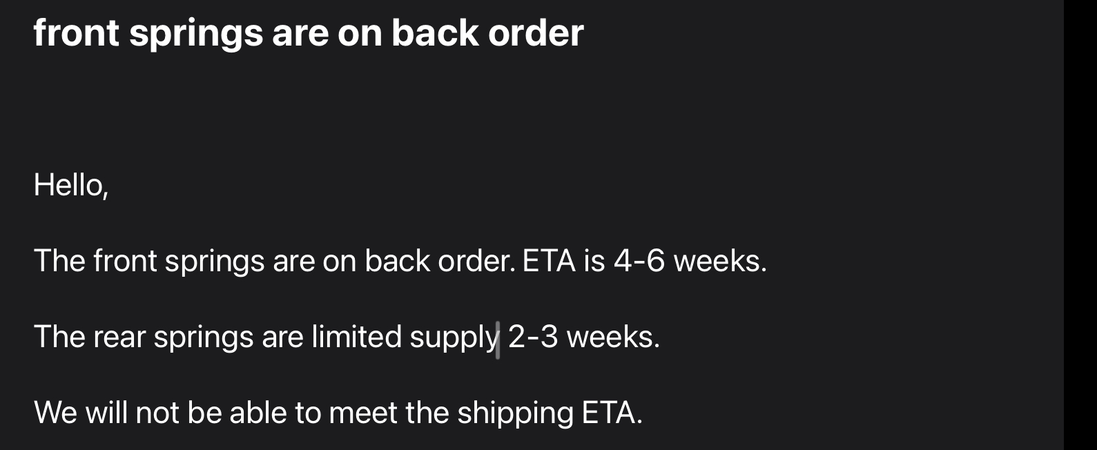

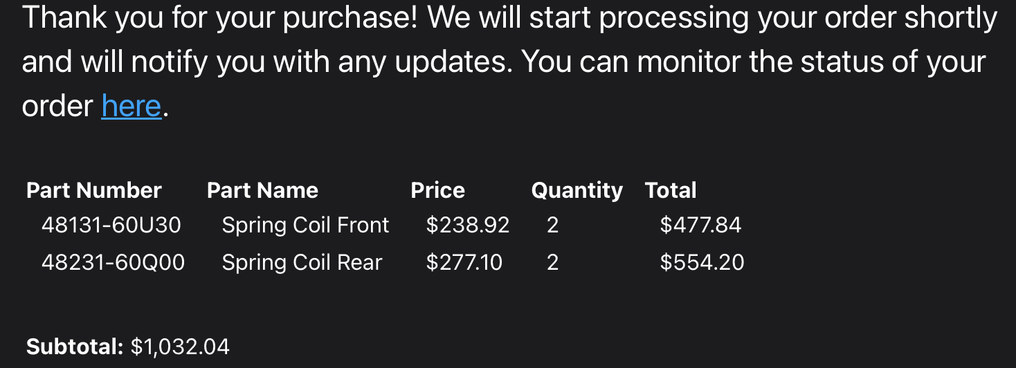

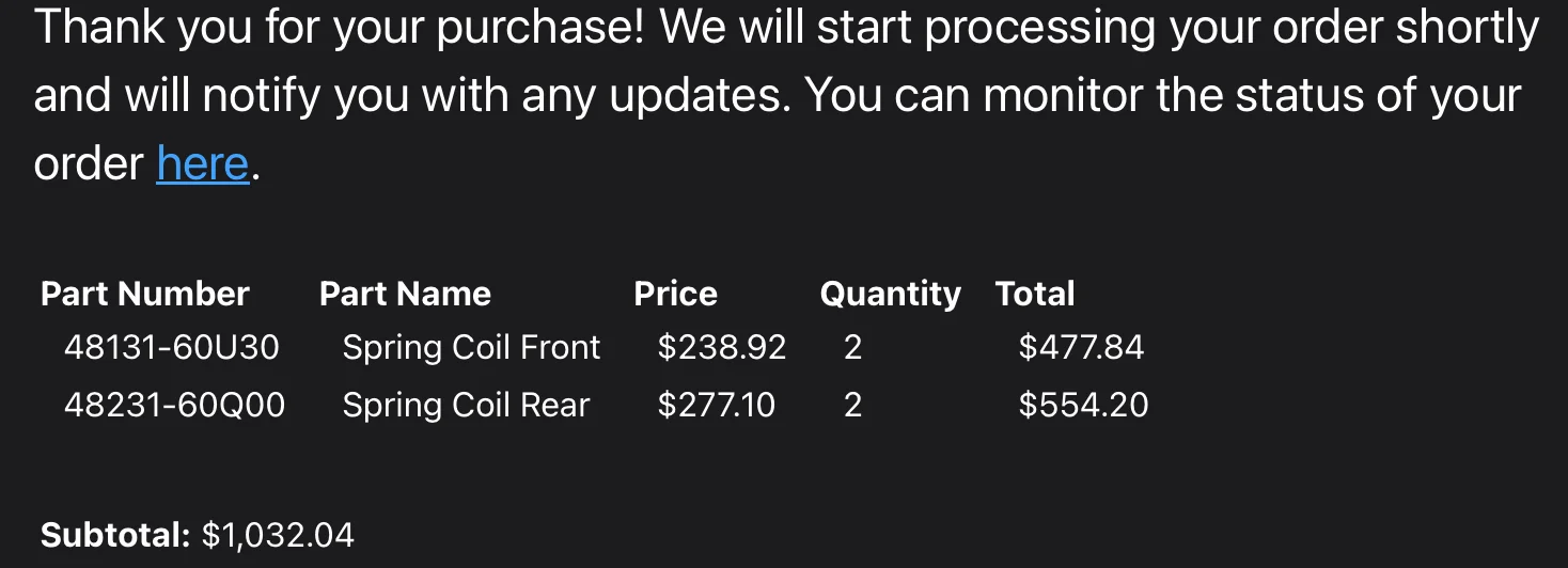

Sharing as an FYI on 2025 coil spring availability/shipping/price.
Ordered from https://lexus.oempartsonline.com/. Order will filled by Lexus of Stevens Creek.
I kept my order in place and asked them to ship when all parts received.
