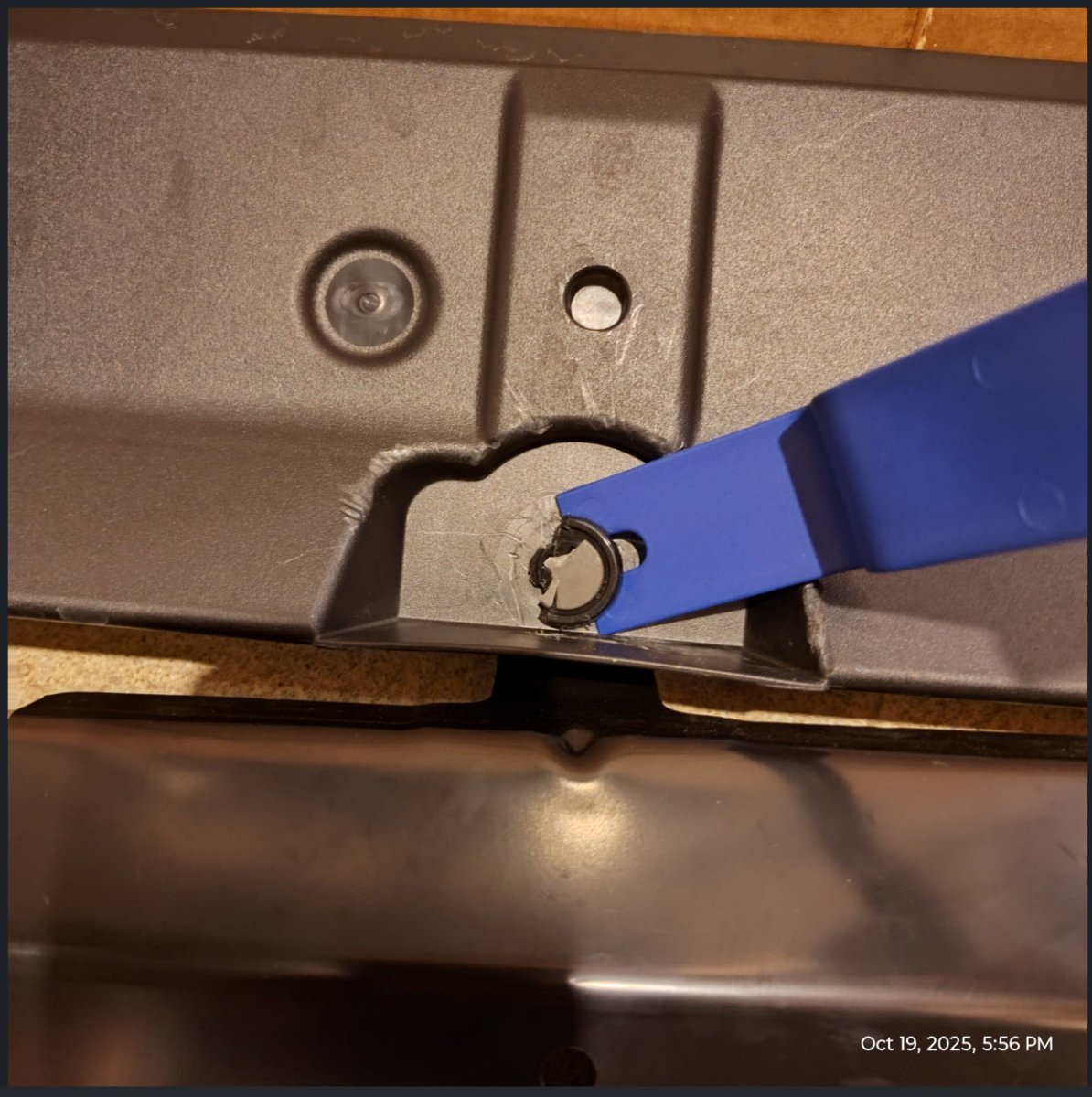

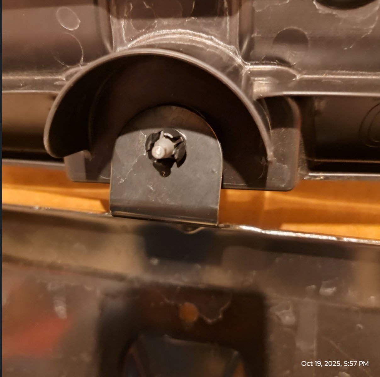

I did an 500 mile oil change today. I have one part-piece that caused, and is still causing, an extreme level of frustration.
The plastic "pop out" fastener connecting the front air dam and the skid plate, I still have not gotten it out. I had remove both the aid dam and skid plats with that plastic fastener still connected.
Attached pictures show some of this.

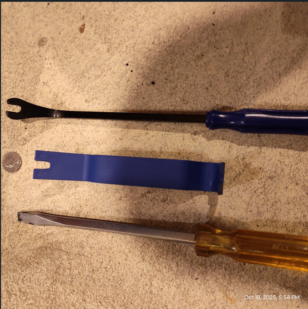

I tried four different tools to try to pop it out. Two flat-hear screwdrivers and two pry tools. I backed off when using the plastic pry tool, because it – the tool -- was about to snap (break). I destroyed about half of the flange-head of the fastener (see pic) using the metal pry tool.
I haven’t reattached the two plates, yet. The pics show them on my garage floor.
I want to remove the fastener before reattaching both plates to the vehicle, but I can’t think of a way to remove the fastener without destroying it. Any ideas on this would be really, really helpful right about now.
It’s possible I am missing something in how this fastener should pop out. I looked closely at the video, at 03:42 you mention pop out with a flat head. Other write ups on here, and on club lexus, all say the same, it pops right out. I suspect I am the unfortunate 1 out of thousands that runs into a problem with this simple part.
My tentative backup plan is maybe use a Dremel tool to drill out the fastener body, or just cut the plastic if I can do so without scratching the paint on the metal skid plate (future rust). Then remount the two pieces without the fastener in place, and separately get a replacement fastener and pop it in place.

It looks like you're prying the outside flange that is black.
Pry the inner grey piece first. It should pull out about a half inch, then the black piece will be able to be removed.
Yes - the grey inner piece is what locks the pin - it spreads out the black locking fingers that you show in your last photo. The grey inner piece should come out easily - you might even be able to do it with your fingernails. Afterwards, the remainder of the black circular pin should come out easily.

I totally missed that. I feel like completely dumb. Thanks.
You should be able to get a replacement clip for pretty cheap at your local Toyota or lexus dealer - part number 90467-09227 I believe.

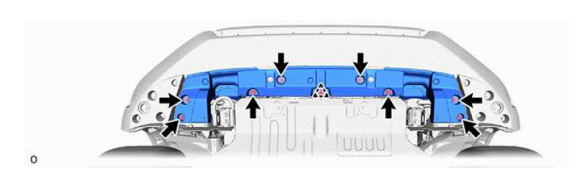

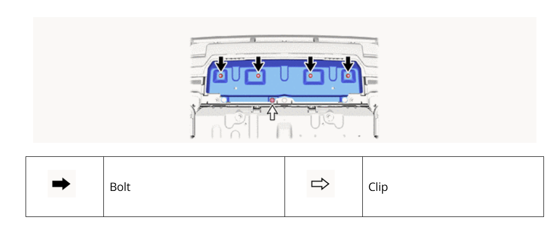

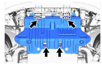

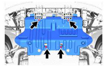

I suspect the words being used (skid plate, air dam, etc.) to describe the various pieces are messing with all of us. That being so, I've been meaning to post some notes, so here goes.
It's worth noting for OT models here are three different covers (plates) to remove. For Prem and Lux, there are only two covers (plates) to remove. This statement and the part names and images in the following list are from the Toyota/Lexus service manuals (thread) I have access to via my local public library.
The video in the original post in this thread shows a Lux model, so two plates not three, and the OP only removes one of the two (he leaves the Air Dam on).
Common (slang) NameFull, complete Lexus-Toyota part name from service manualIllustrationNotes
Skid PlateNo. 1 Engine Under Cover (for Off Road Package)
On OT models only. The Toyota manual uses the words "for Off Road Package only."
Air DamFront Bumper Guard Base Cover
Made of soft (ish) plastic-vinyl like material, light in weight.
Skid PlateNo. 1 Engine Under Cover Sub-Assembly
Rigid Metal, 4 fasteners. Two small tabs on the front side, small-dashed rectangles in the image, make it easy to hinge (swing up & down) and re-attach. The trade-off is these tabs make it hard to detach without taking off the Front Bumper Guard Base Cover (Air Dam).
A skid plate should be there, if not it's missing.
Skid PlateNo. 1 Engine Under Cover (for Off Road Package)View attachment 16951On OT models only. The Toyota manual uses the words "for Off Road Package only."
Air DamFront Bumper Guard Base CoverView attachment 16950Made of soft (ish) plastic-vinyl like material, light in weight.
Skid PlateNo. 1 Engine Under Cover Sub-AssemblyView attachment 16949Rigid Metal, 4 fasteners. Two small tabs on the front side, small-dashed rectangles in the image, make it easy to hinge (swing up & down) and re-attach. The trade-off is these tabs make it hard to detach without taking off the Front Bumper Guard Base Cover (Air Dam).
