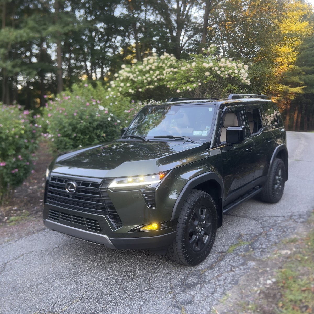

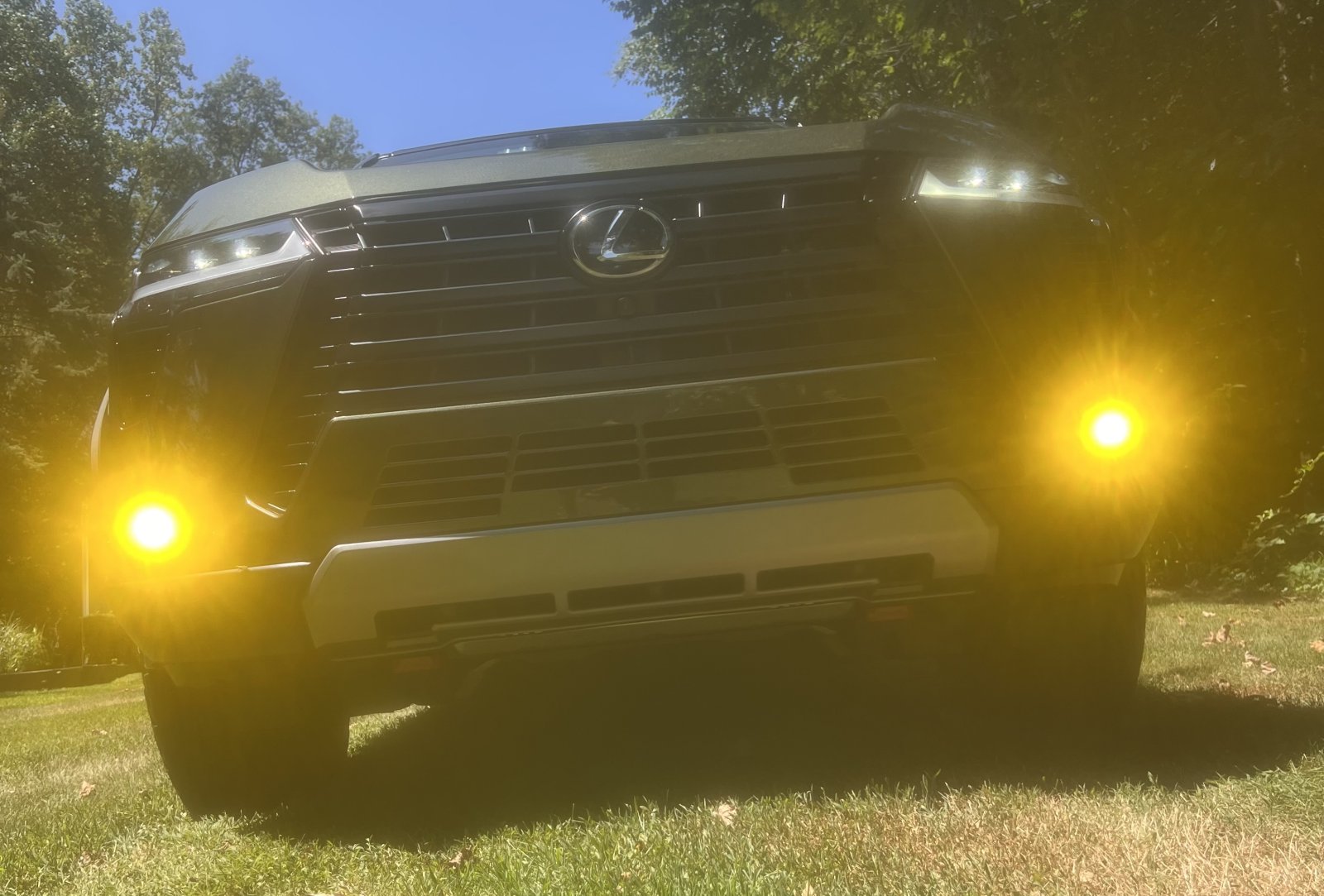

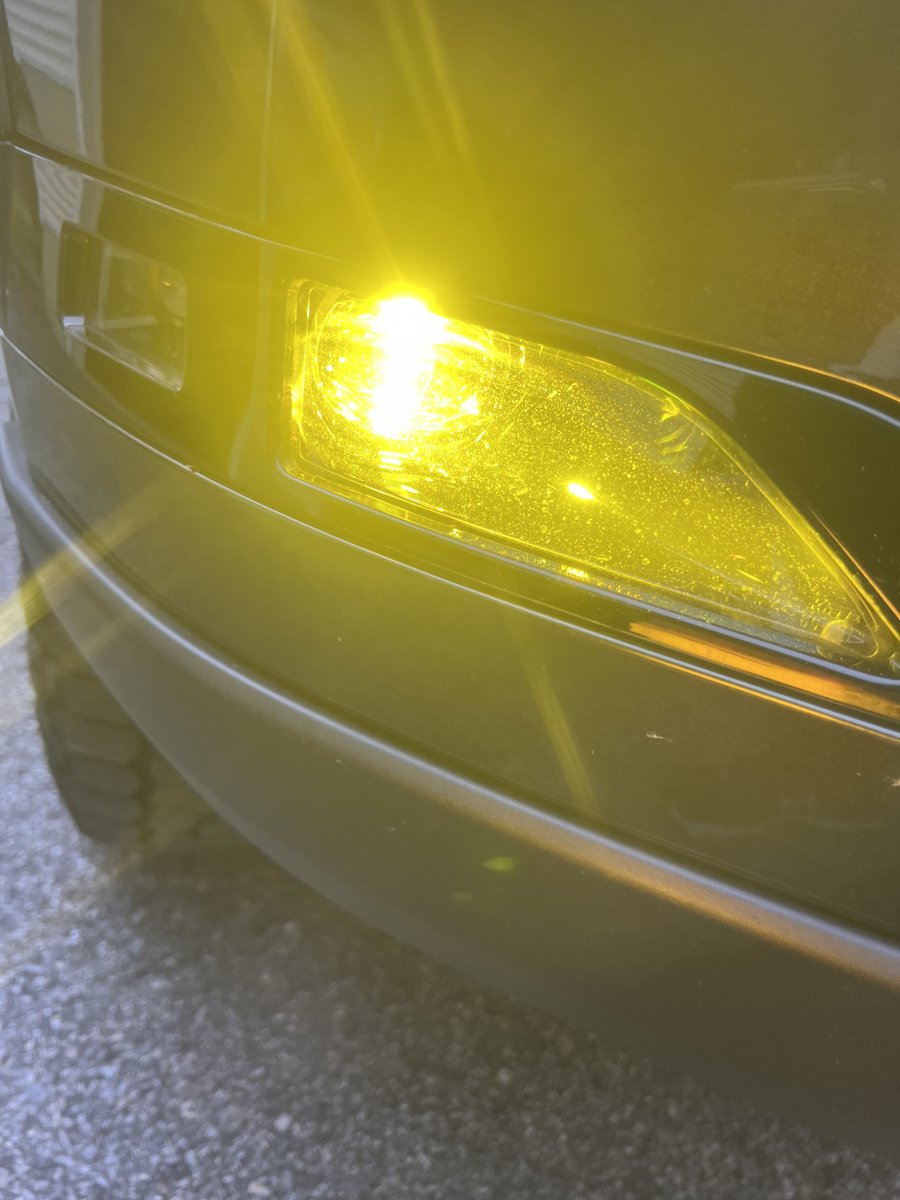

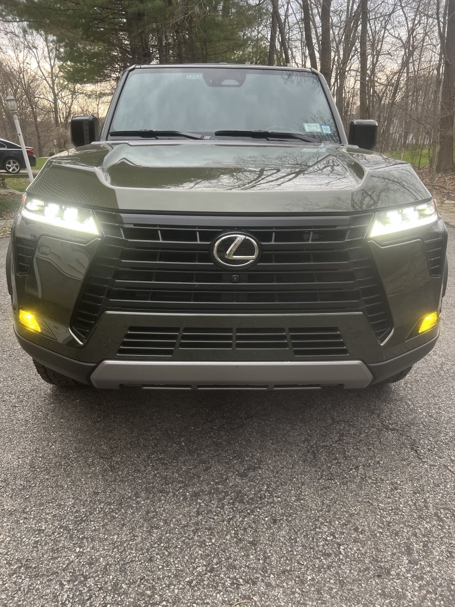

The lights are fantastic - easy to install. Would fully recommend -
I went with Yellow + Yellow. The turning lights only come on when you make a very sharp turn, typically at slow speed, so it probably doesn't matter a lot which color you choose. They also fade in and fade out so its not distracting when they come on. Frankly, they are not very useful. I am thinking about modding them so they are always on when the fogs are on.
Also, I went with the IPF brand because I thought they would be made in Japan, but it turns out they are made in China.
I love them…especially on foggy mornings.

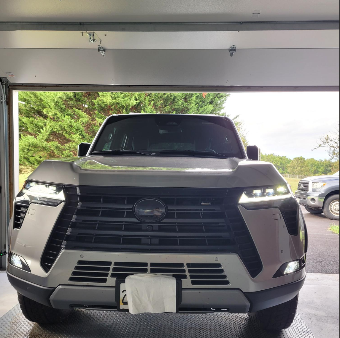

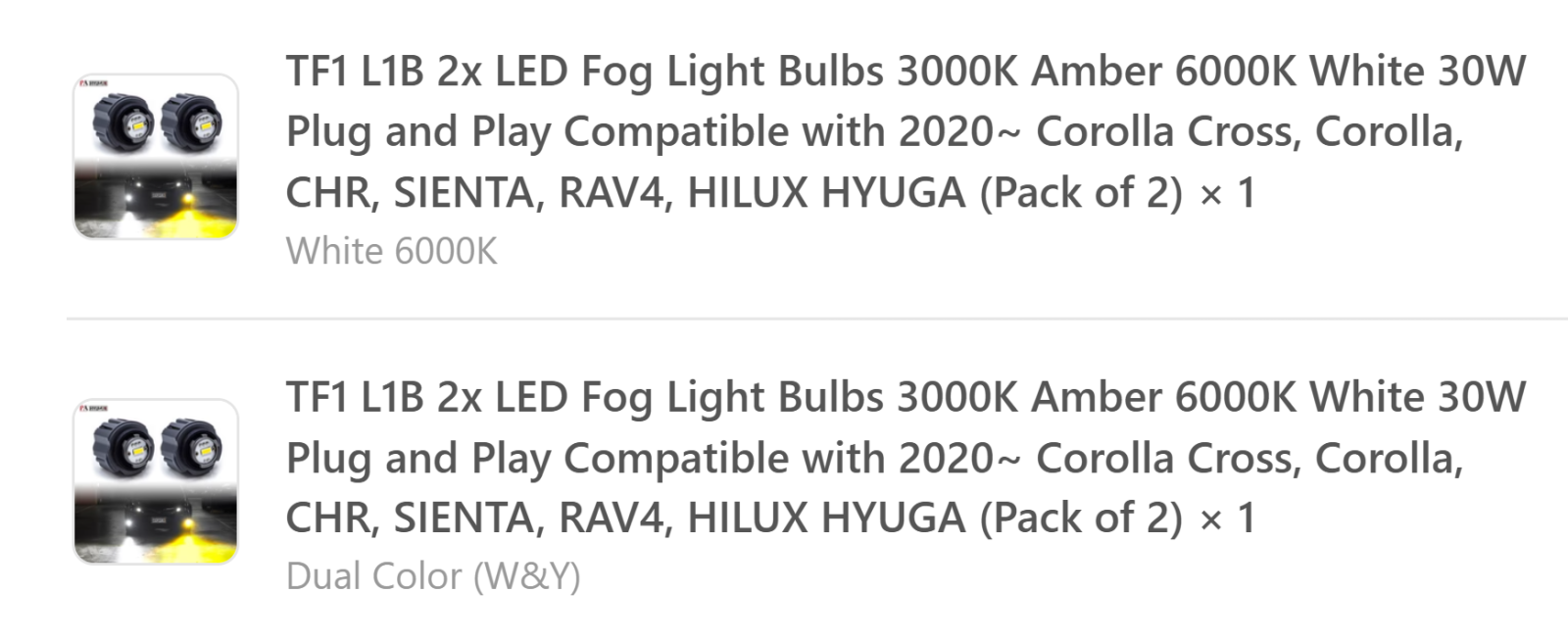

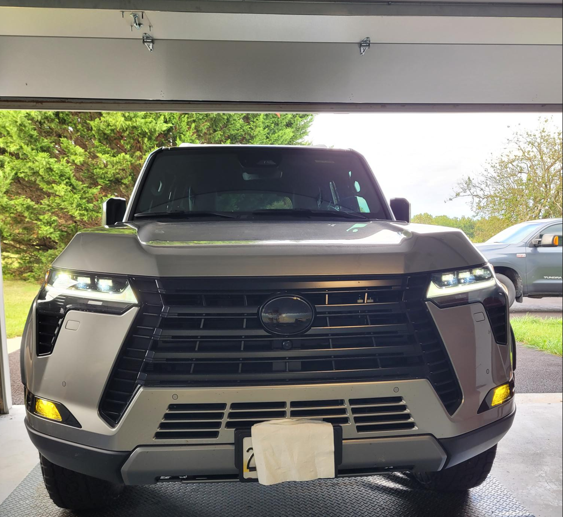

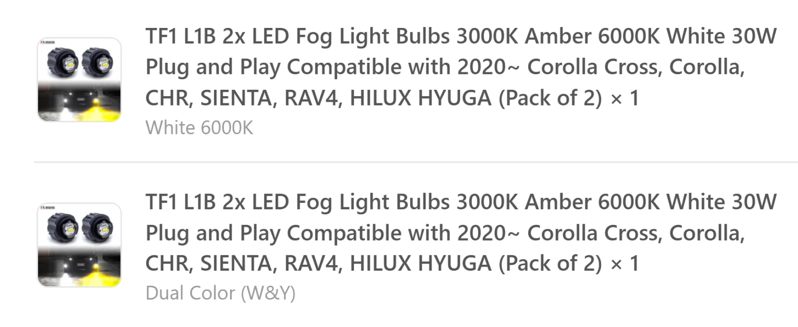

I just installed the HYUGA fogs and turning lights on my '25 OT. It was easier than changing bulbs on some of my other vehicles, took about 15 minutes. Other posts cover the process and show how these are much brighter than OEM. But I wanted to share something had not seen before on this Forum, as when I ordered them I saw they have an option for dual lights, white and yellow. I bought the dual white/yellow for the fogs, and the white for the cornering lights. When installed the default setting for the dual lights is white on. To change to yellow you can simply flash your high beams, or toggle the headlights on and off. It's easier when driving to just flash your high beams to change fogs to yellow or back to white. We'll see how long they last, but at about $65 not a big deal to me if I change again. I also left the lower air dam valences off, truck looks better without them and I'd prob damage them anyways. Cheers.
