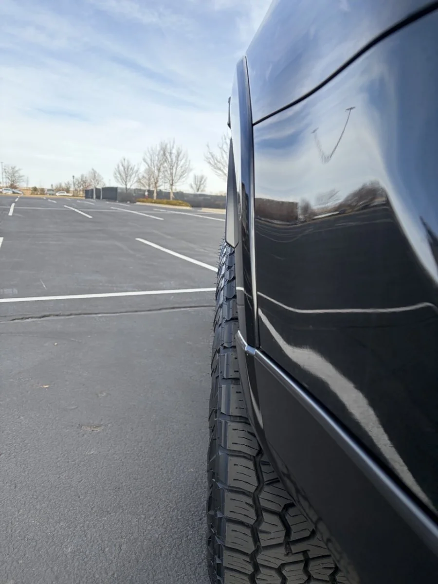

Do you have a side view to see how flush/poke it sits?

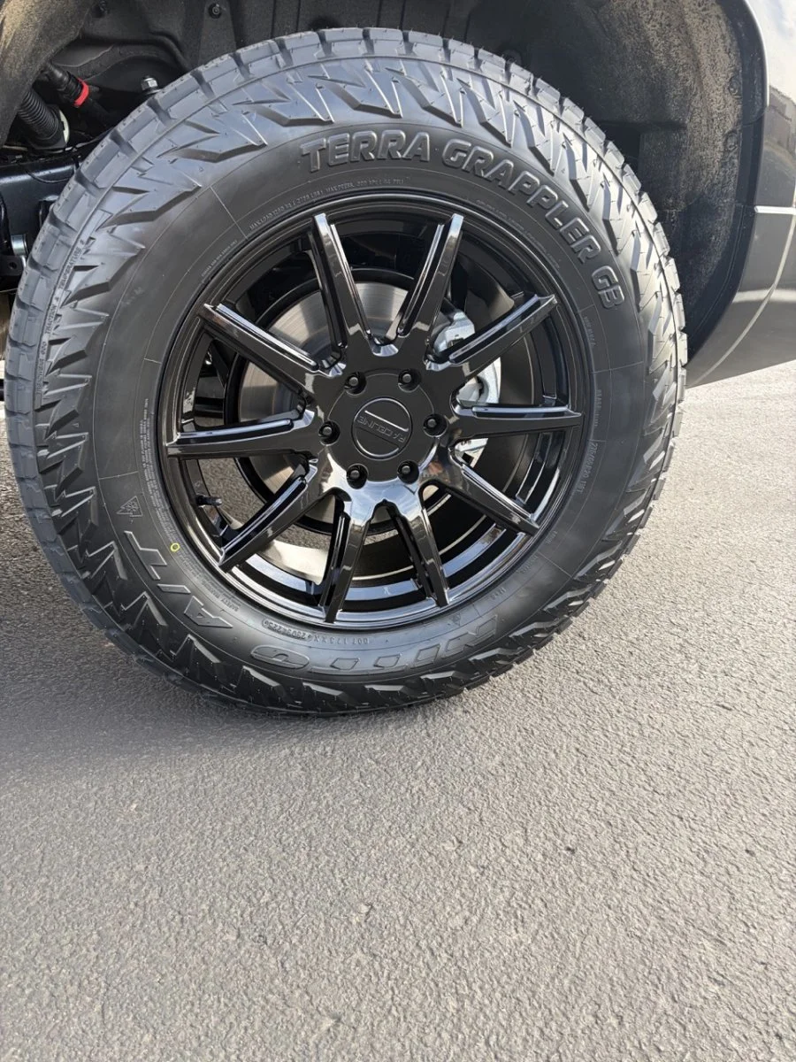

This is great look… any lift in this or just a front leveling kit?

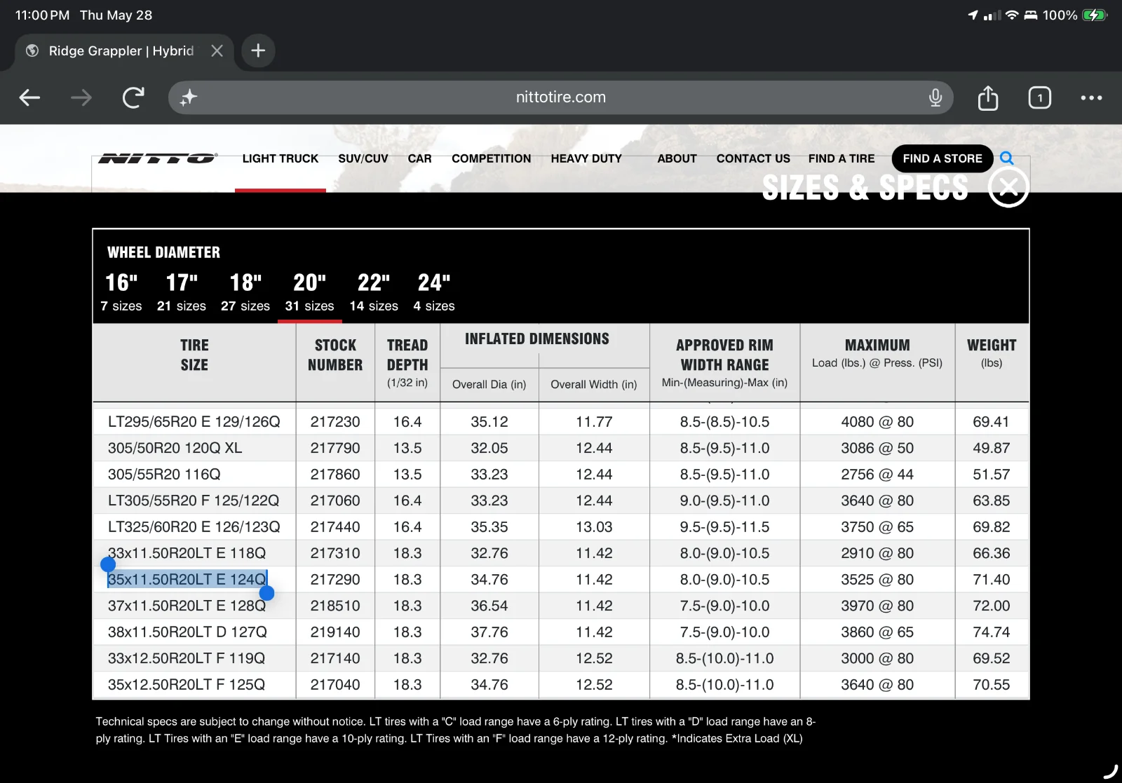

Just discovered this thread after pulling my (nonexistent) hair out trying to find quality 20" +35 wheels for my GX550L+. For the life of my I cannot figure out why they cripple this trim level with the 22" wheels.
Recently acquired the vehicle, my last LC being a 1986 FJ62 inherited from parents who purchased new off the lot. This vehicle will see very moderate off road use (we live on a long dirt road, fire roads, some through fields) and live mostly on pavement as my daily driver. I also have a Silverado with a Cognito / Fox / Deever stage 2 which I do not intend to make this vehicle compete with. That said, I do want more sidewall (torn between 20 and 18 x 8.5-9) and have been frustrated by the lack of high offset options in the aftermarket in anything buy 22 and 17 options.
Also, I run Falken Wildpeak AT4 on my truck and have run BFG KO2's in the past. I was thinking of going with the Pirelli Scorpion's to avoid the class E ride as the additional stiffness is not required. Any thoughts or feedback welcome.
Did you have to trim at all? If not, do you have any rub at full lock? This looks great.
Nope no trimming needed. I have a splash guards on the front that on one of the sides i just needed to heat up and slightly bend as it would occasionally rub at full lock in reverse. It appeared to be slightly deformed right out of the box. The other side was fine.
