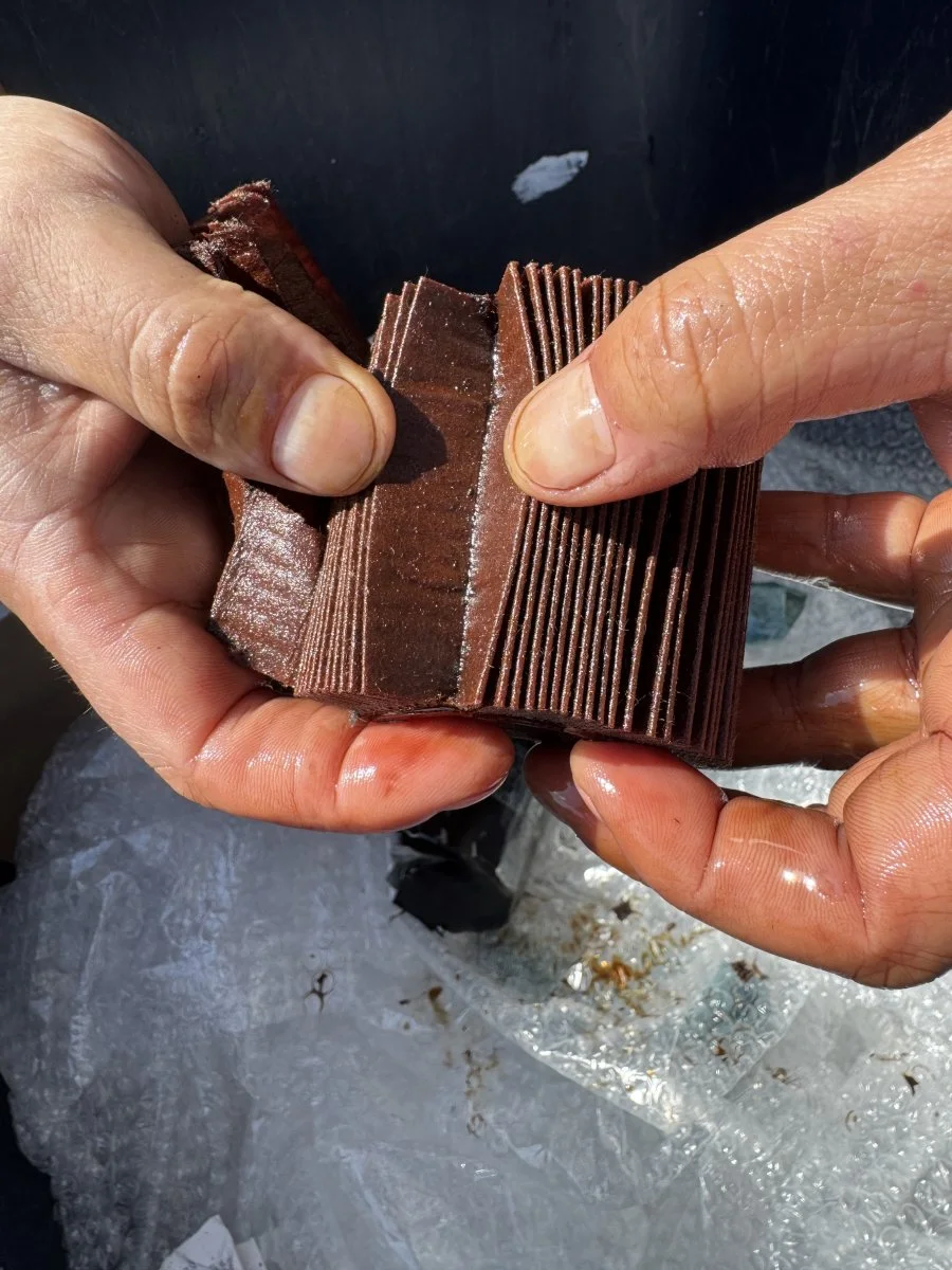

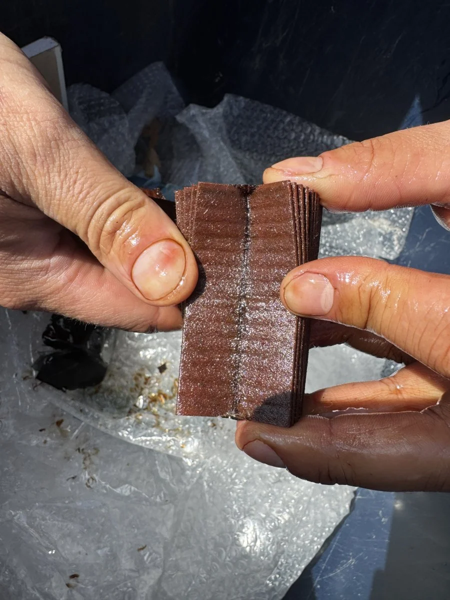

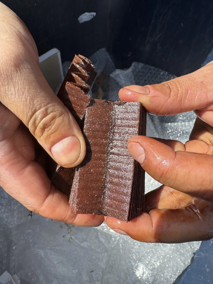

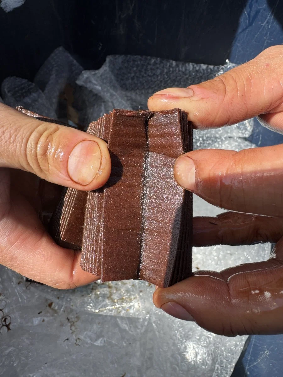

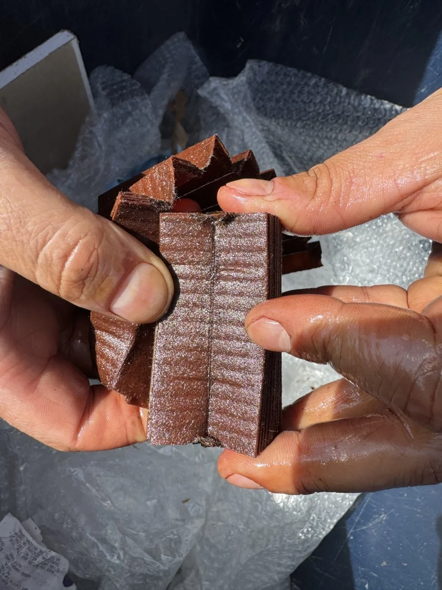

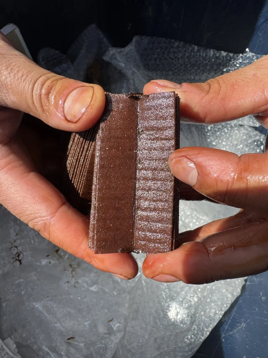

Did my first oil change at 4,300 miles, was curious what the filter media held so I used a filter can opener to take a look, was concerned by the mount of metal I found. Interestingly, there is a fair amount of red “glitter”, be curious if anyone knows where that comes from? You have to zoom in on the pleats to see what I see. The glitter alone doesn’t concern me, but the size of some of the metal pieces does.

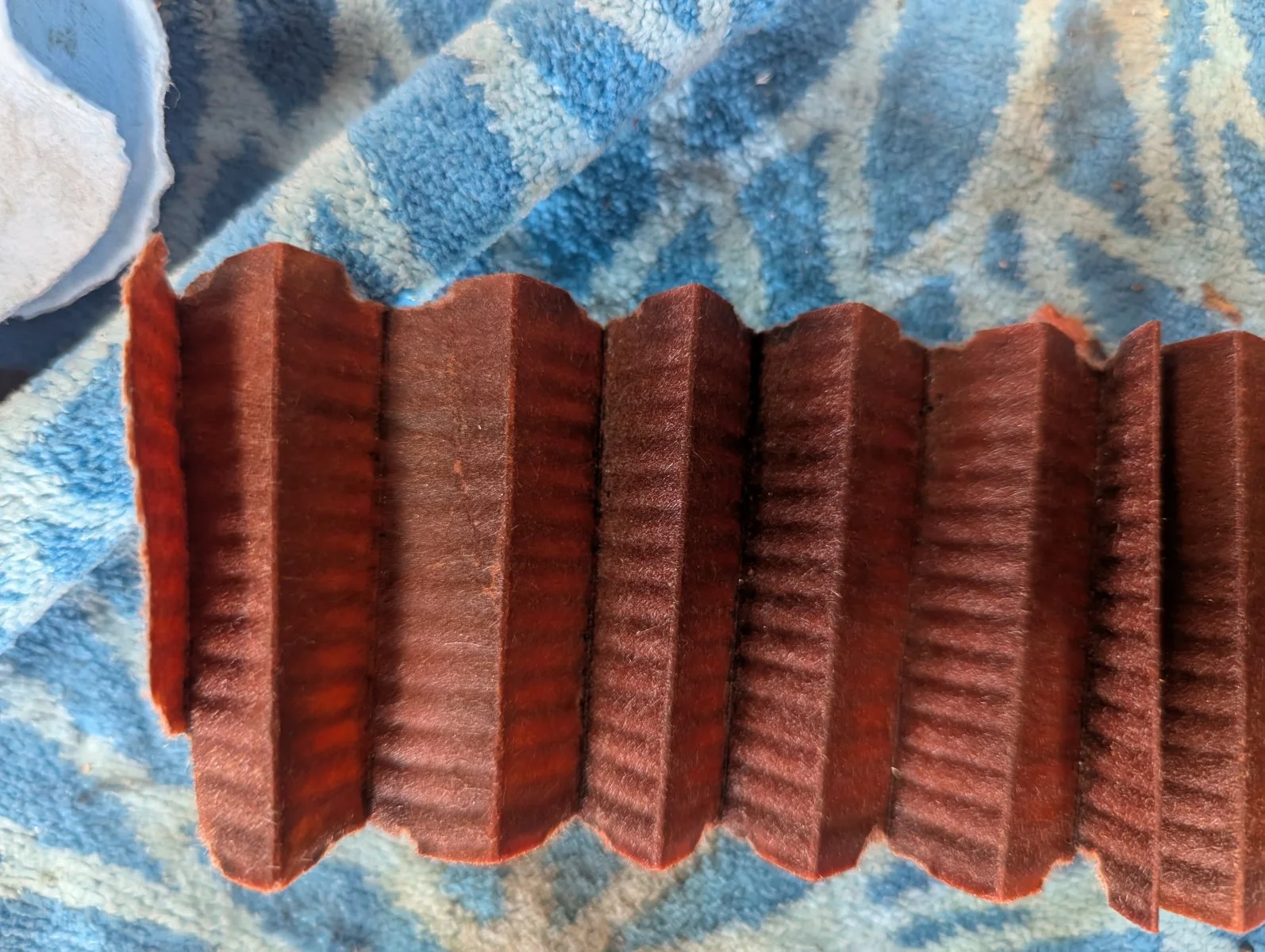

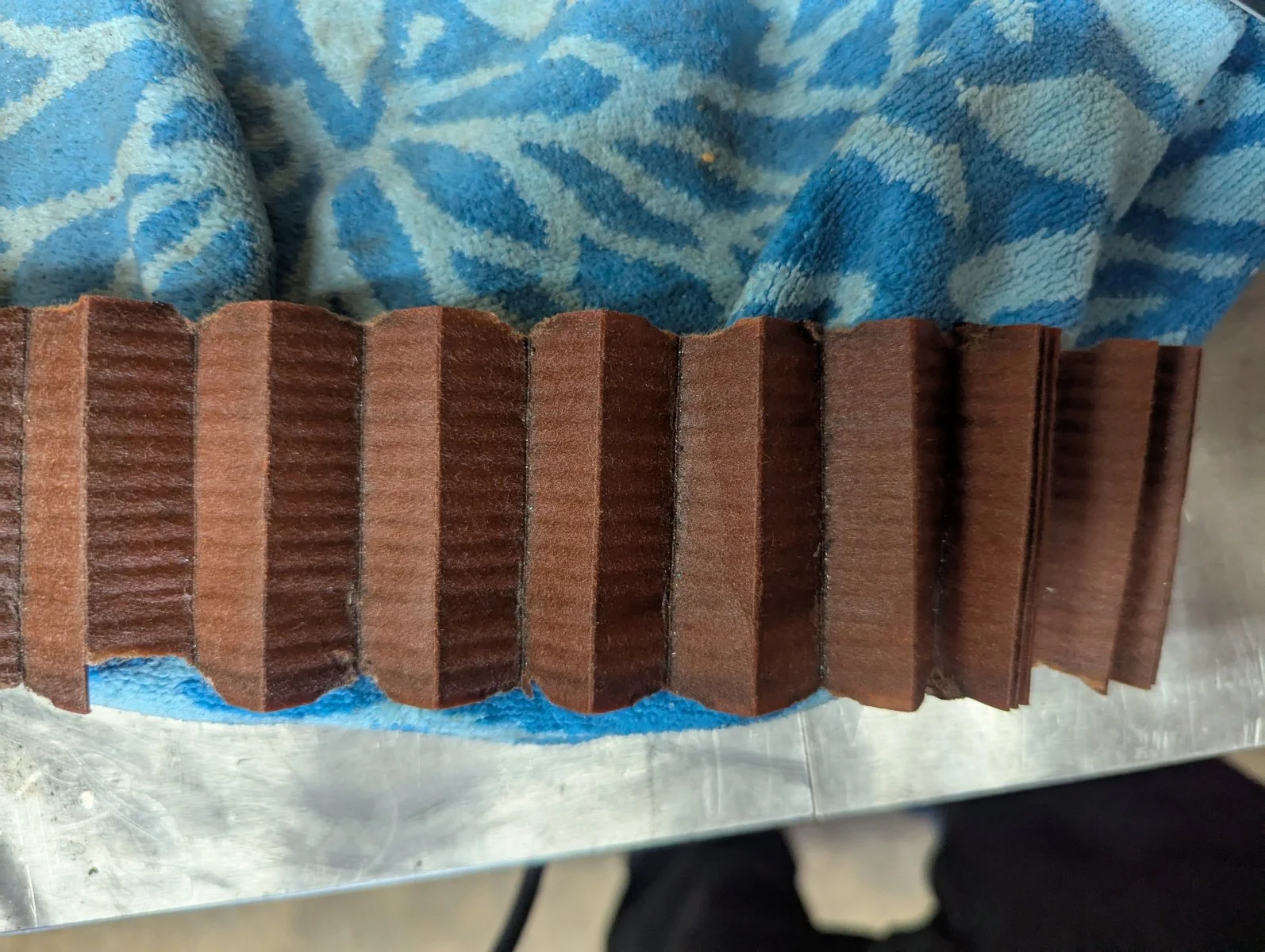

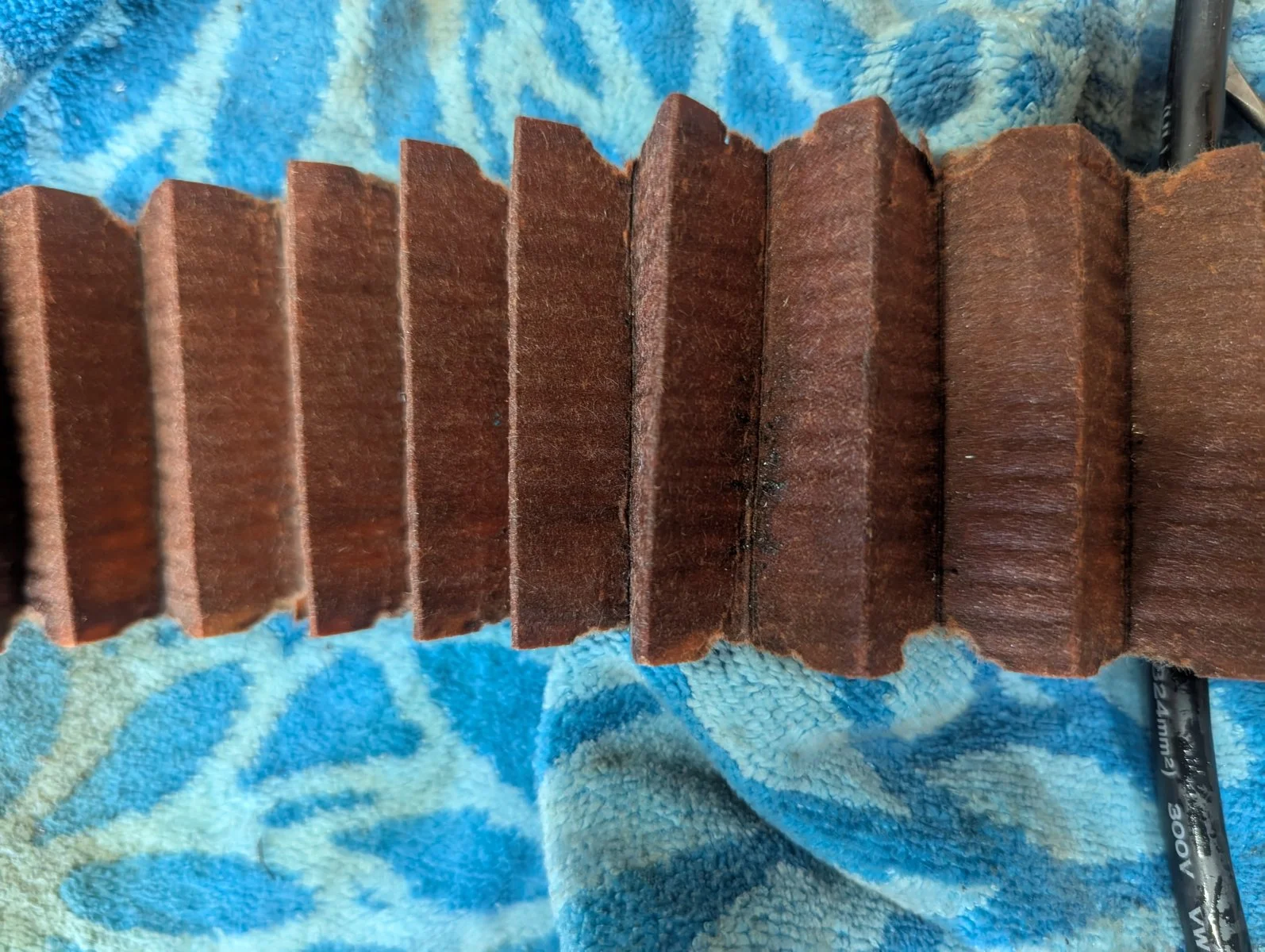

I just did my oil change at 3,300 miles. Here is what my filter looked like.

Thanks for sharing, looks generally consistent. Anything over 50 microns / .002” isn’t good in my experience. Just surprised the validation process didn’t catch this.
