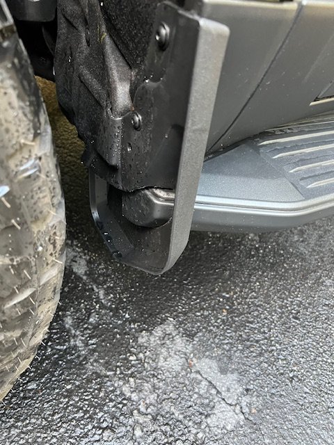

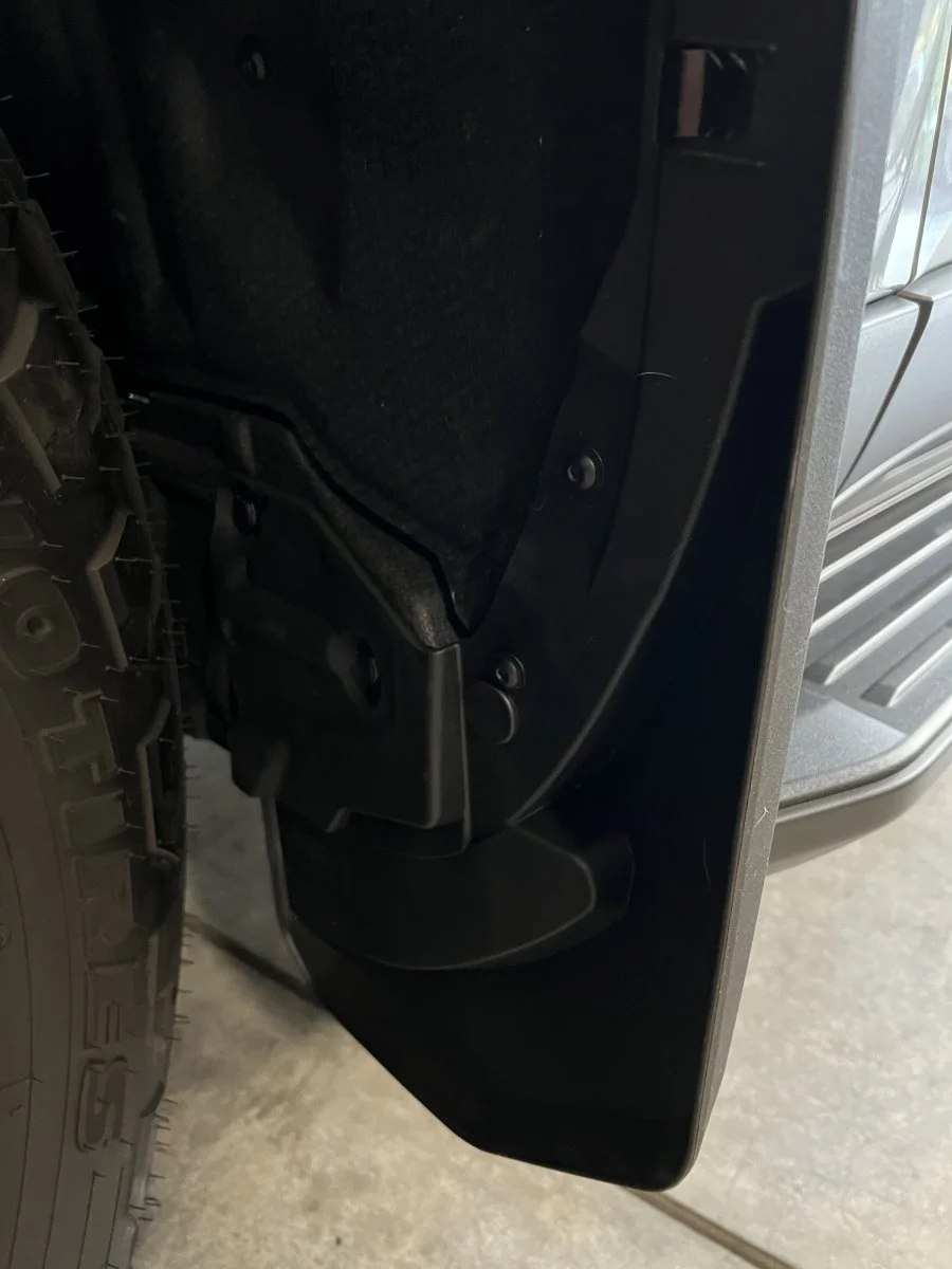

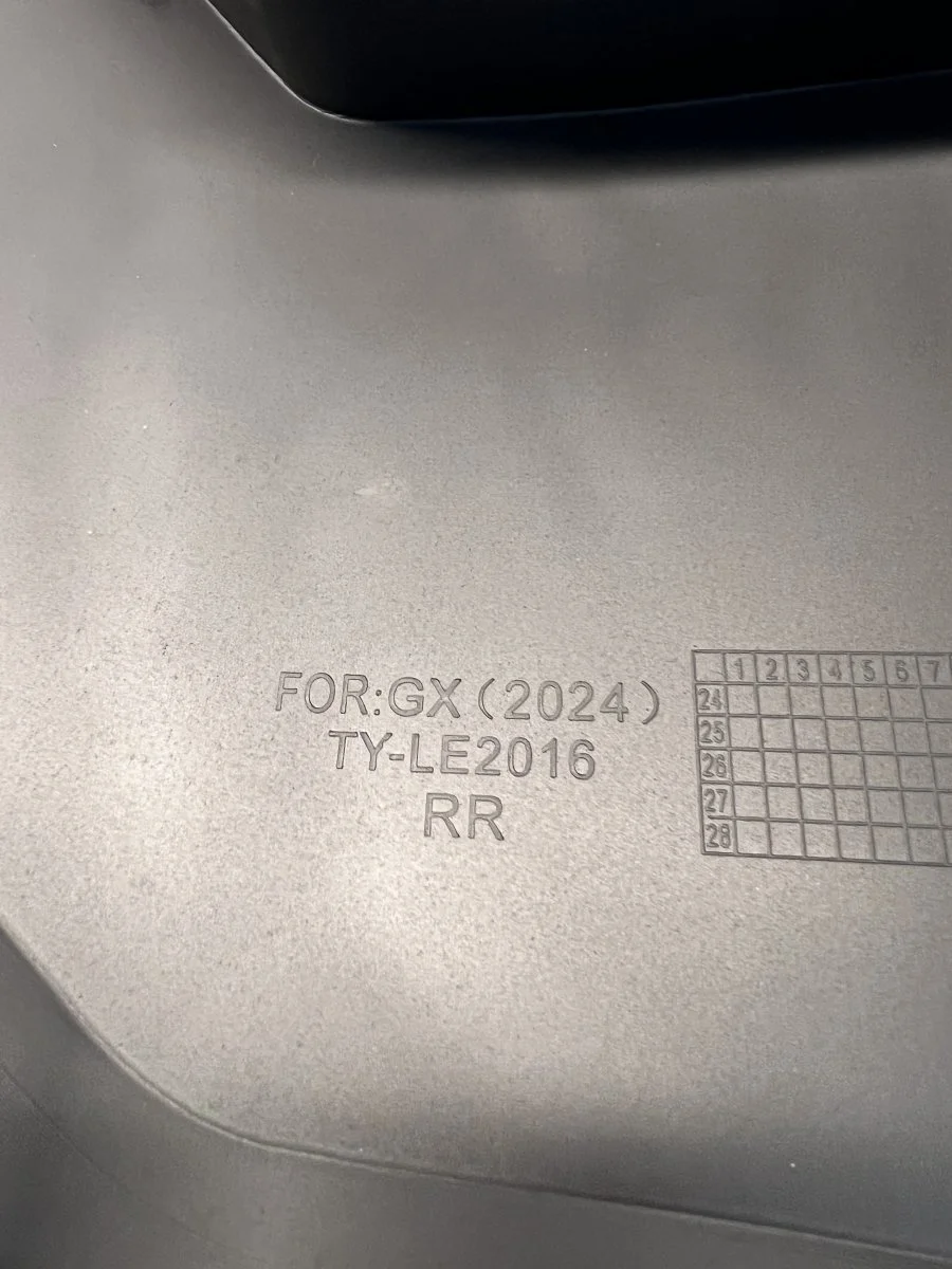

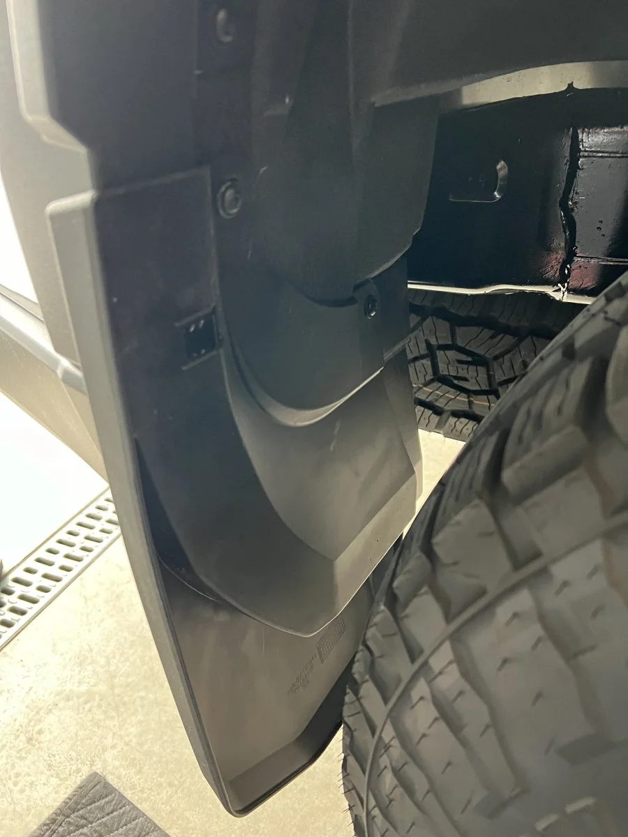

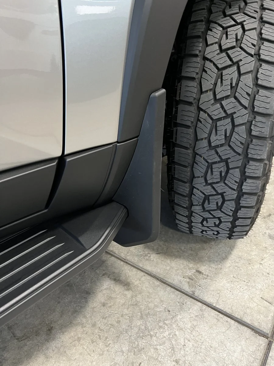

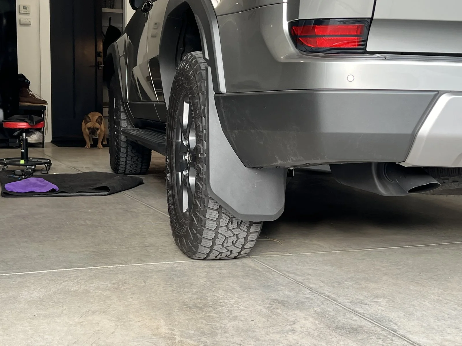

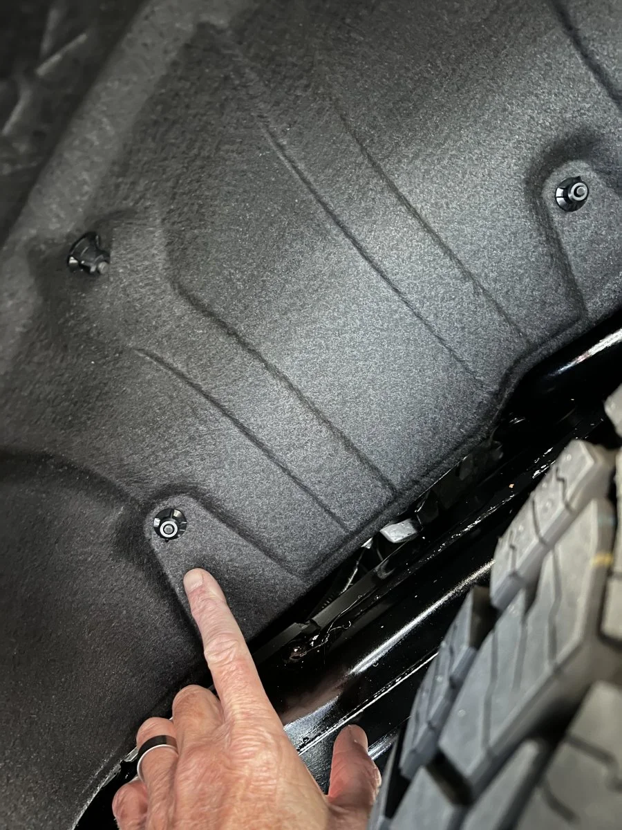

Installed el-cheapo China mudflap set from ebay. $40 shipped was hard to pass up. Couple notes: Check your plastic threaded retaining nuts holding the rear "felt liner" in place. See 1st. pic. Mine were all completely loose and needed several turns to snug up. Otherwise this was an easy install and the fit and quality is great for my needs. Zero offroading and only looking for snow and winter road grunge protection.

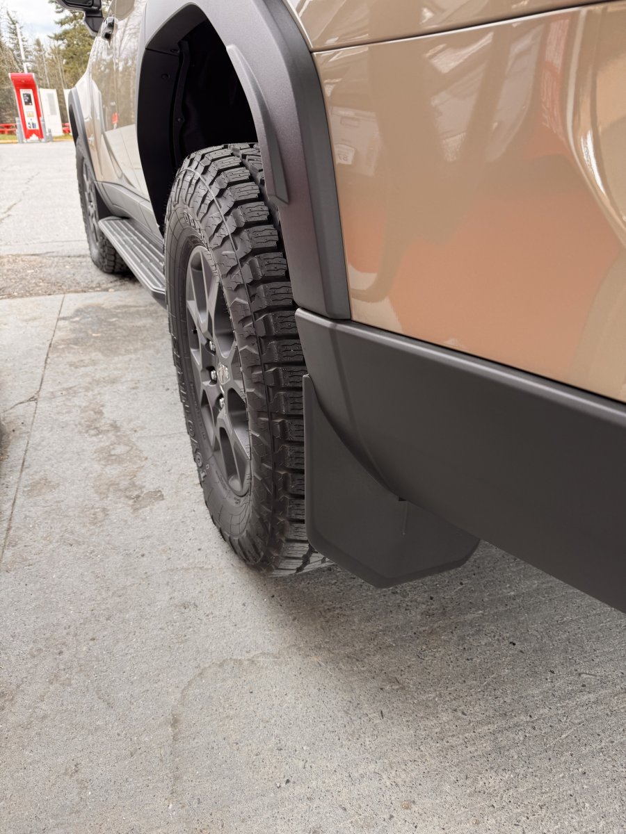

So. Weird thing I noticed….
My OT+ has mud flaps lol
Not sure if it’s a Canadian / cold weather spec thing ( I also have a built in block heater ) or if it’s just something my dealer threw in.
Noticed it filling up today.
Yea it’s a small one basically just keeps crud off the side steps

I would be careful ordering those. I ordered a similar kit for my Premium+ and while the fronts fit, the rears did not. I believe there is a difference between the OT and non-OT rear bumpers after doing a little bit of research.
Thanks! I want a perfect fit (OEM like). I don't want to drill any new holes, etc. The item description does say it's for Overtrail too, so I believe there may be indeed a difference in design.
Thanks! What challenges did you encounter?
They include longer plastic body rivets which are necessary but they were larger in dia. Than factory which requires drilling out the hole. Zero room to drill unless the wheel is turned full lock or removed. There’s a clip that looks like it should have a threaded hole but it’s simply a clasp used to secure the flap to existing molding. Threaded clasps all had to be drilled out as they were undersized and were requiring to much torque to tighten. Typical cheap hardware kit but if you take your time and tweak a few things it all goes together fine.
Thanks for the additional info. I will wait for the OEM like version. This seems too much adjustment. FYI I submitted an ask to WeatherTech for them to produce those. Hopefully either they or Lexus will do soon.

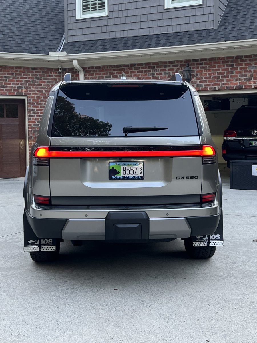

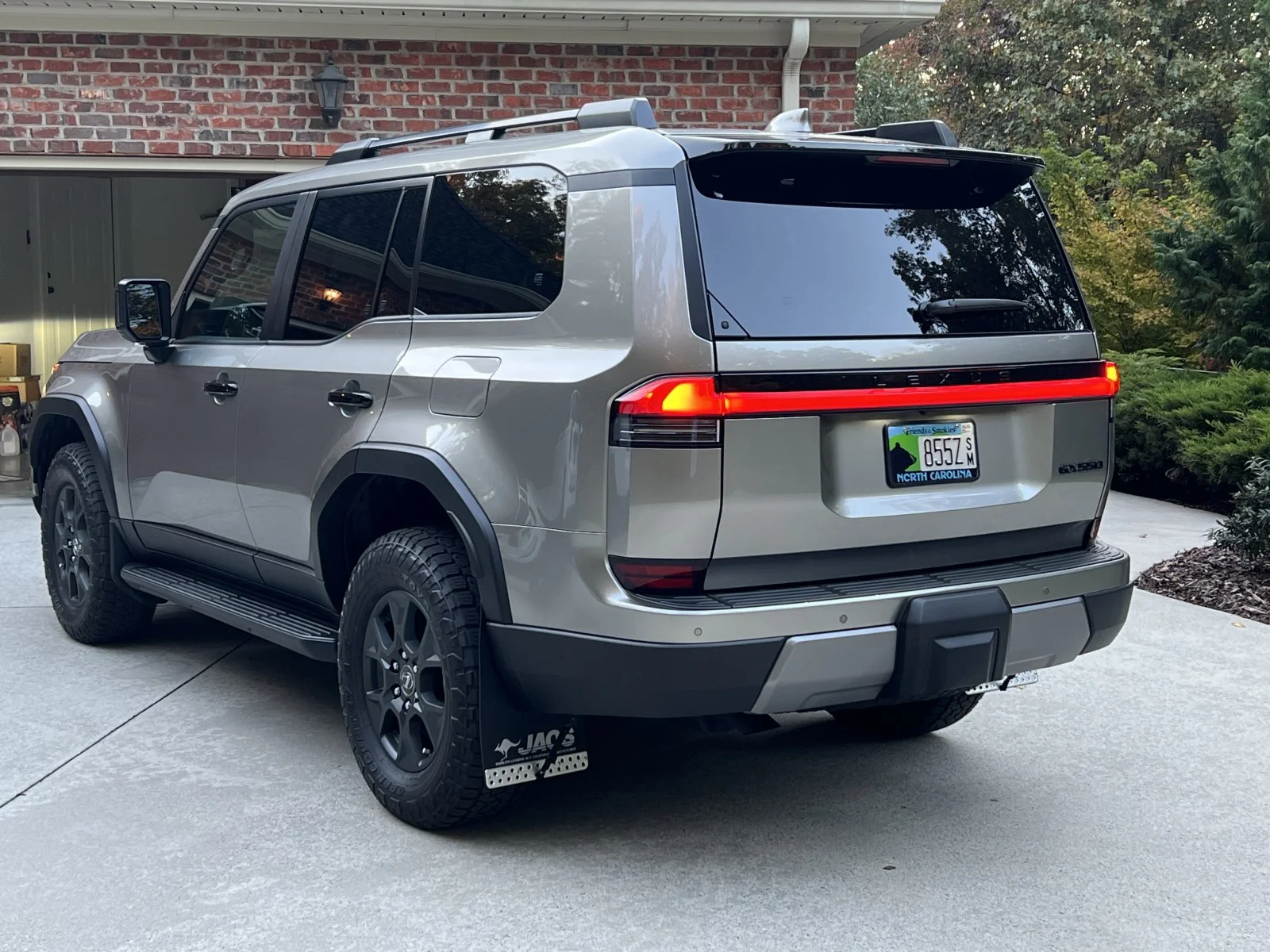

Finally got the Jaos installed, I like them!
Are these theLandCruiser/Prado BlackHawk Jaos? have these on both front and back?? I have the dark caviar paint color so this might change the contrast effect too much yet the splattering from the front on my rock rails is severe. the Jaos look more effective?
