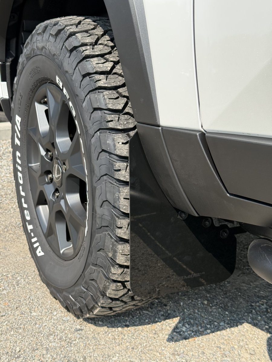

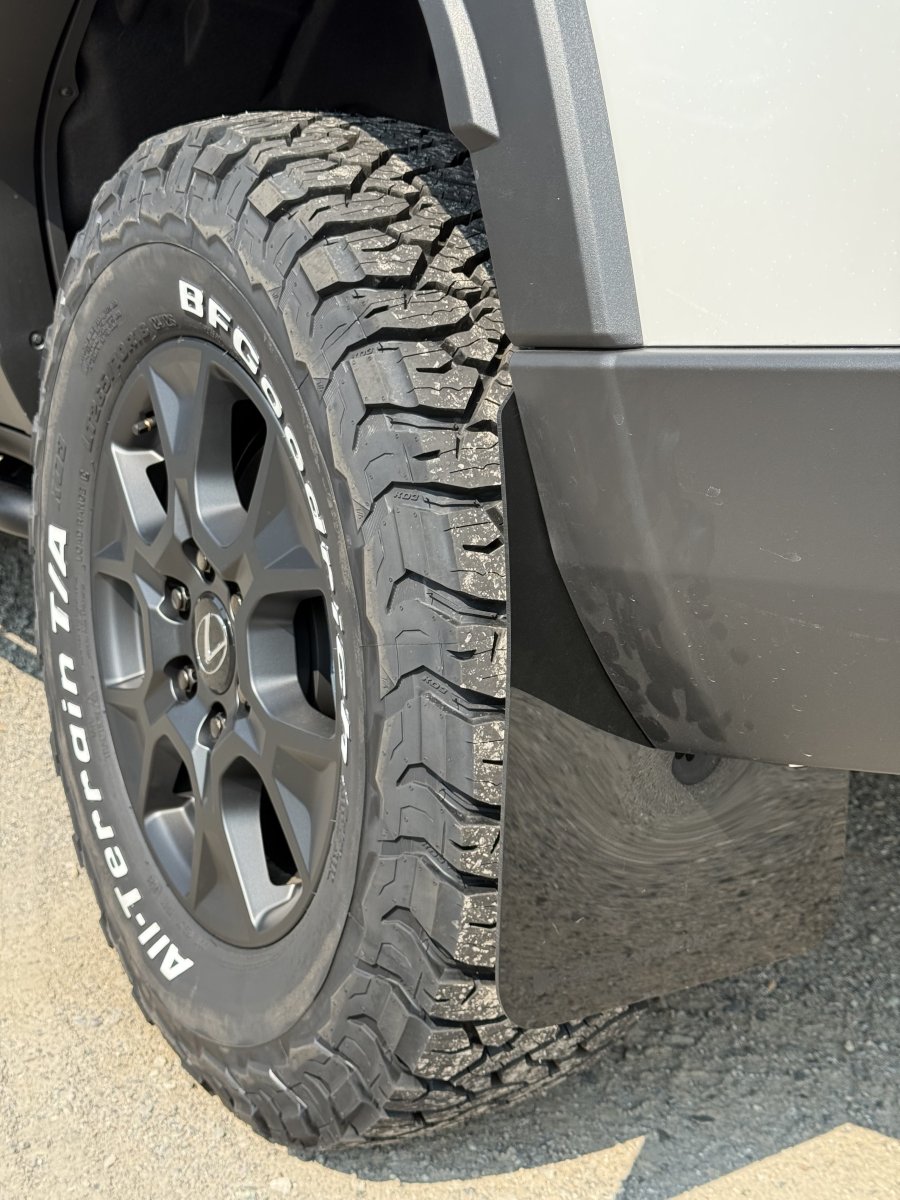

My dealer installed the Rally Armor mud flaps on my 2025 GX550 Overtrail+ this morning and I’m very pleased. The service technician said the installation was straightforward and the quality of the product was very good. They are flexible when pushed/pulled but remain relatively rigid while driving (including at freeway speed).
Thanks a ton for the report and pics. Can you please post pics of the other side of the flaps, showing how they are mounted. I have an aftermarket rear bumper (victory4x4) and am not sure how the rears would mount.
I will post pictures that show how they are mounted as soon as I return home from a brief business trip. They are “no drill” and are designed to work with the stock fastener pattern of the Overtrail/Overtrail+.

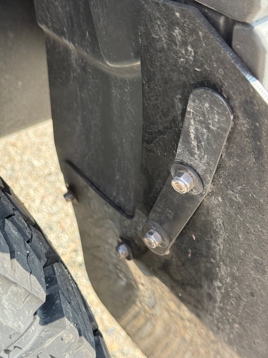

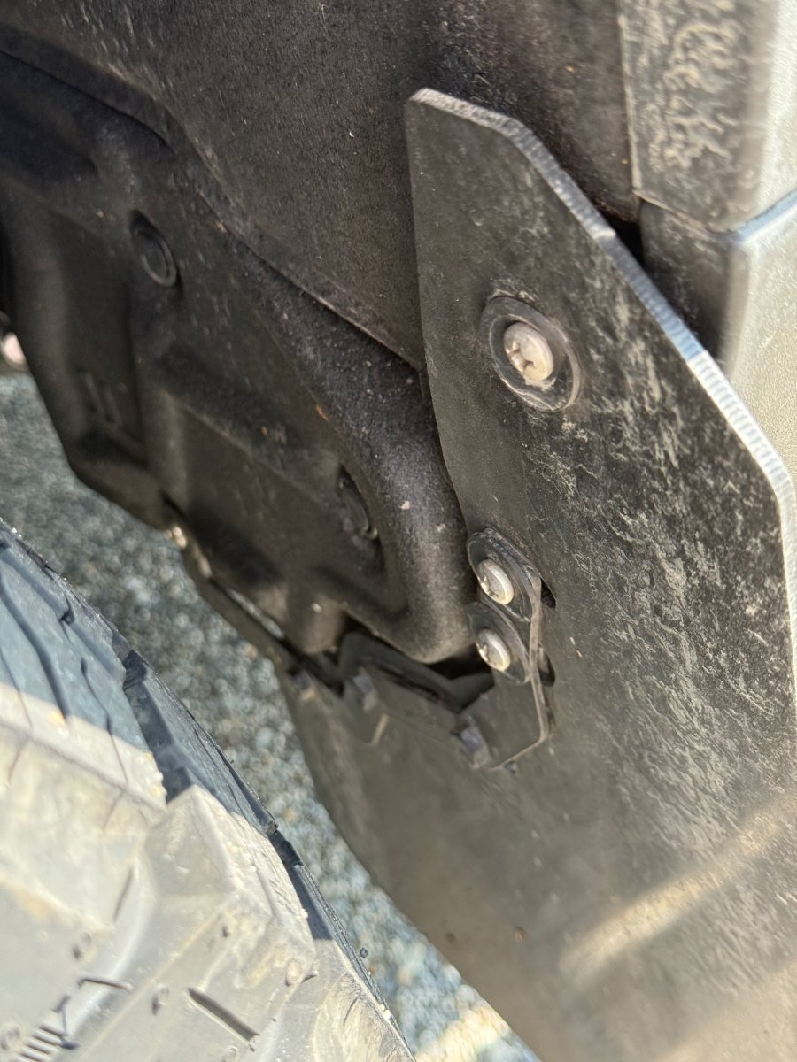

Attached are the photos of the mounting hardware inside the wheel wells for the Rally Armor mud flaps for the GX550 Overtrail+. I had the dealer install them for me and I'm going to take it back in to have a few things squared up a bit better. I'd do it myself, however, given the fact that I paid for them to be installed I'd prefer them to take responsibility for it in the event that there are issues in the future. So far the mud flaps are working very well and protecting the lower portion of the doors from rock strikes. It really is amazing how exposed the lower portion of the doors are with the rock rails as opposed to the side steps.
Let me know if you have any questions or need any additional information.
