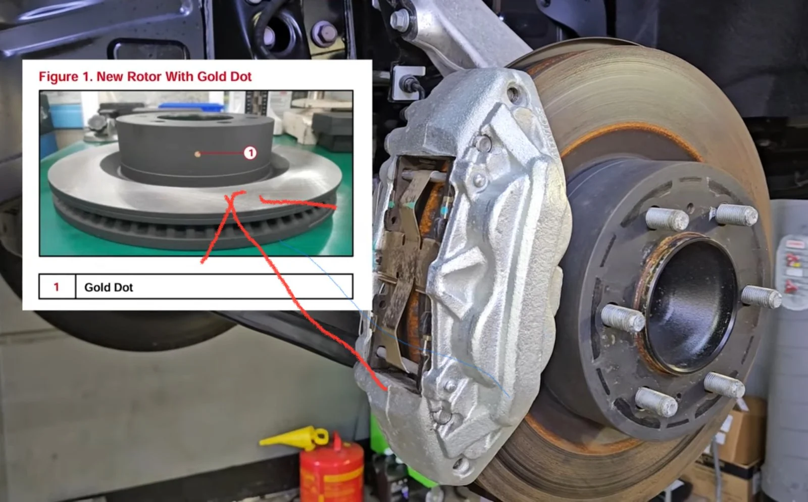

Check to see if your rotors have this gold dot. This would likely indicate you have the new rotors.
Thanks for sharing!! Looking at the parts from the video, I see the fitting kit includes an "anti rattle spring." Can this be related to the vibration issue?
IMHO no but the rotor could be the culprit if they were warped from the get go. The shim and anti rattle spring updates would more likely address the squeal.
