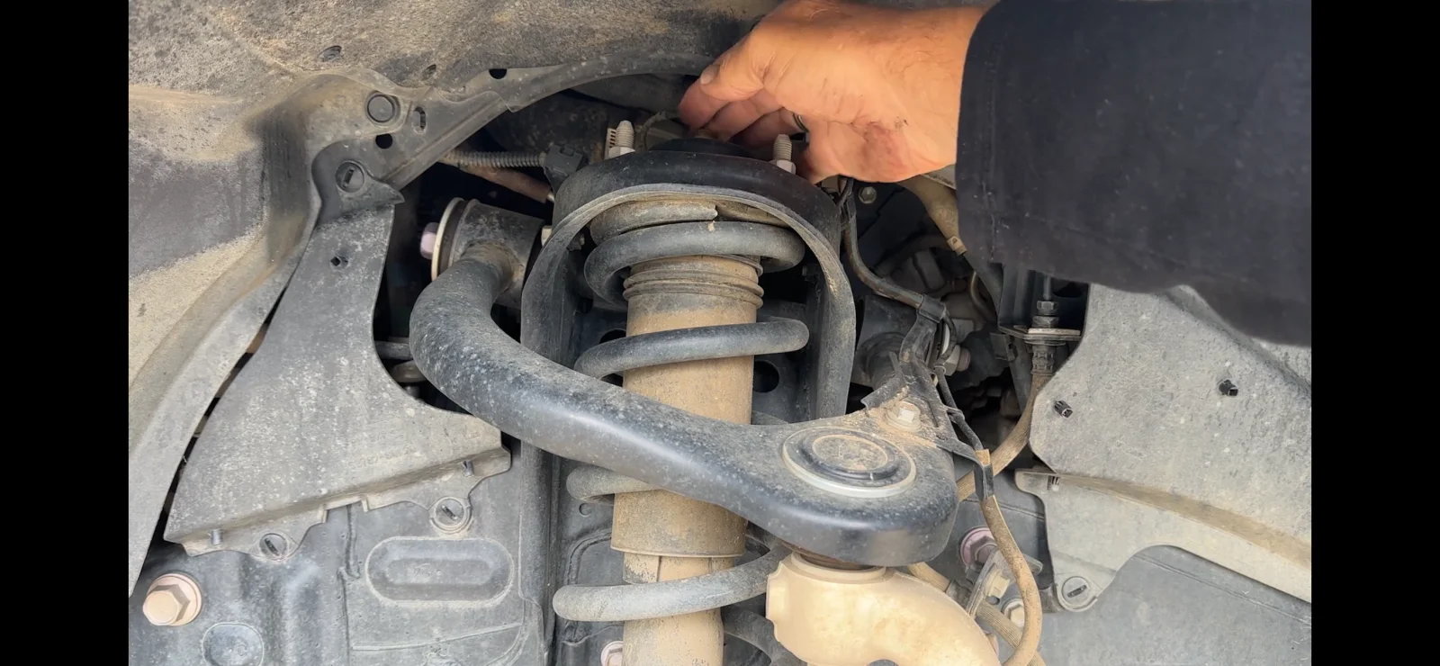

After doing more digging the shocks themselves do not have variable damping and current KDSS is only affecting sway bar disconnect and is fully automated. Not seeming like it has any bearing on ride quality other than increased articulation. My next thought is to pull and test each shock for proper function. It would be a compression vs rebound related issue that would explain the bone jarring type vibs. PITA but obvious next step. Fairly certain the shocks are made by Hitachi and are the Tokico line.
Sorry, first vehicle with KDSS or AVS. I thought the OT and OT+ came with AVS, so wouldn’t they have to have dampers?
Actually you’re correct! further research found this: https://www.caranddriver.com/news/a61162471/2024-lexus-gx-suspension-tested/#
Clearly the model Tokico shock on the OT is adaptive. Now we’re getting somewhere. This the most likely culprit for the rough ride being experienced by a few. See in the pic below the wire coming from the top of the shock.
Anyone with the issue should take it in and have the AVS tested. Hopefully it can be handled by a re-flash or module replacement vs all new shocks. Hope this helps…
Thanks for looking into it. I was going to reset the ECU first to see if that helps with anything. I saw somewhere to disconnect the battery and pull the ETCS and EFI 1 fuses, and see if that does anything.
