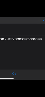

After three weeks the dealer gave up on it. Said they could make it ride a little better, but the chatter was still too noticeable to be acceptable. They gave me a trade in on a Sequoia that rides 1000 times nicer. Here’s the VIN for my GX that they couldn’t fix.
