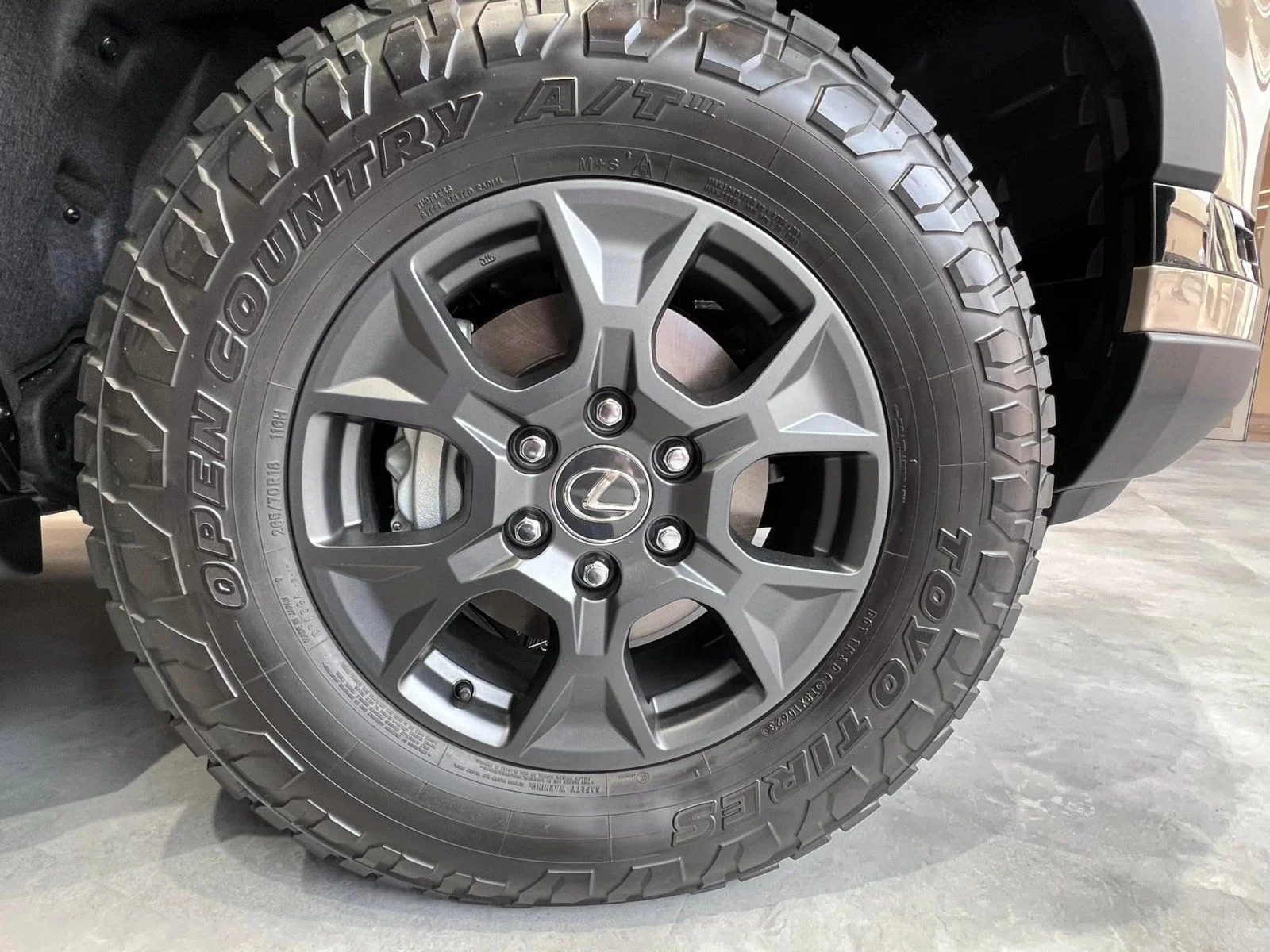

Long shot theory - I read somewhere that the Overtrails ship with BFG K03s which are a brand new product from BF Goodrich. Could it be possible that the BFGs are defective? All the tooling is probably new in the manufacturing process so who knows?
They are Toyo Open Country A/T III

Interesting! Mine has Toyo Open Country A/T 3, and one was replaced at the dealership as they believed it was defective. I didn't notice a change in the ride following the replacement.
