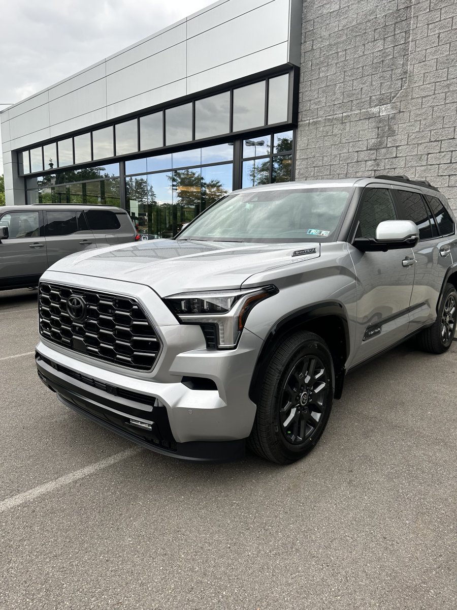

My dealership tried to fix my GX for 21 days with no success. It was not a tire pressure issue. I gave up on it and accepted a trade for a Sequoia Platinum.
I thought you were in a loaner TX?
Yes. Had a loaner for all three weeks Lexus tried to fix my suspension issues. They admitted it was not fixable and corporate mechanics needed to get their hands on it. I told them I just wanted to trade the GX on for a Sequoia that didn’t ride like crap. So no more underpowered TX 350. And no more chattering GX.
That's unfortunate! I have a '23 Sequoia TRD Pro that's fully-built out and it's a freaking beast! It's an incredible rig. Obviously nothing is perfect, but I've been really happy with it. Actually going to be selling it soon ;)
