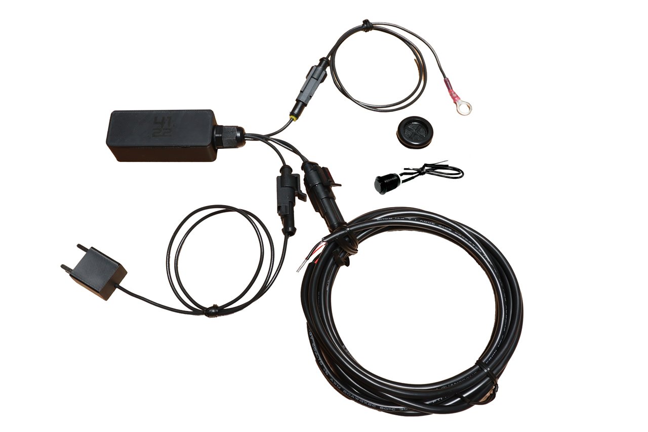

I read about this on the LC forum. Nothing is 100% effective, but any thoughts on this device?

That's pretty slick. You can also just pop out the relay, but who wants to open the hood and get to the relay whenever they want to park with protection? $108 is worth the convenience in my opinion. One problem is that you need to mount the button somewhere convenient to the driver but hidden - not so easy because the thieves will look under the dash for a kill switch with a flashlight and probably find the button pretty quick once the truck doesn't start. If you mount the switch in an incredibly hidden location then you'll never use it because it will be inconvenient. It will also suck when this device stops working....but you can always just keep the stock relay in the glove box (which tells the thieves your secret).

I like the remote-button starter kill switch. I don't like the idea of a battery kill switch because it starves all the electronics, which I just don't think is a good idea. I just changed my battery yesterday and I was surprised that I didn't lose all my radio presets, but I still don't like the idea of shutting off all power via a battery kill switch.
Maybe mount the starter kill switch under the seat where you can reach it from the driver's seat and know where it is from memory, but it's impossible to see.

I plan to install an easily accessible hidden lockout switch for everyday use and will also pull a relay when parked overnight in sketchy areas.

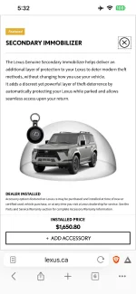

Lexus Canada provides a secondary immobilizer that I believe is a fob. If the fob is not with your key, your GX won’t start. Available from Canadian Lexus dealers. Last time I checked, USA Lexus dealers did not offer this.
