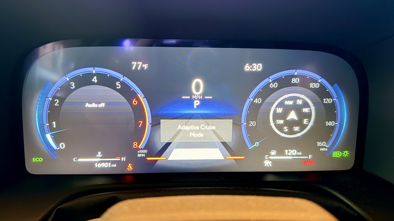

Whether in Park or Drive, or rotating the Drive Selector Control, I’ve never had any warning lights, flashing codes or anything on the driver or center screens. Have the MT64 upgrade since 7/29. I routinely still use the drive modes Eco, Normal, Sport+ for whatever power I need.
I’ve also played around in 4Lo, MTS modes, lockers; nothing.

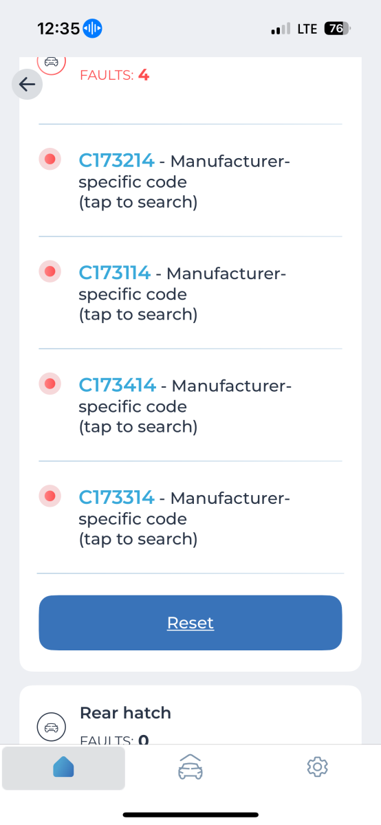

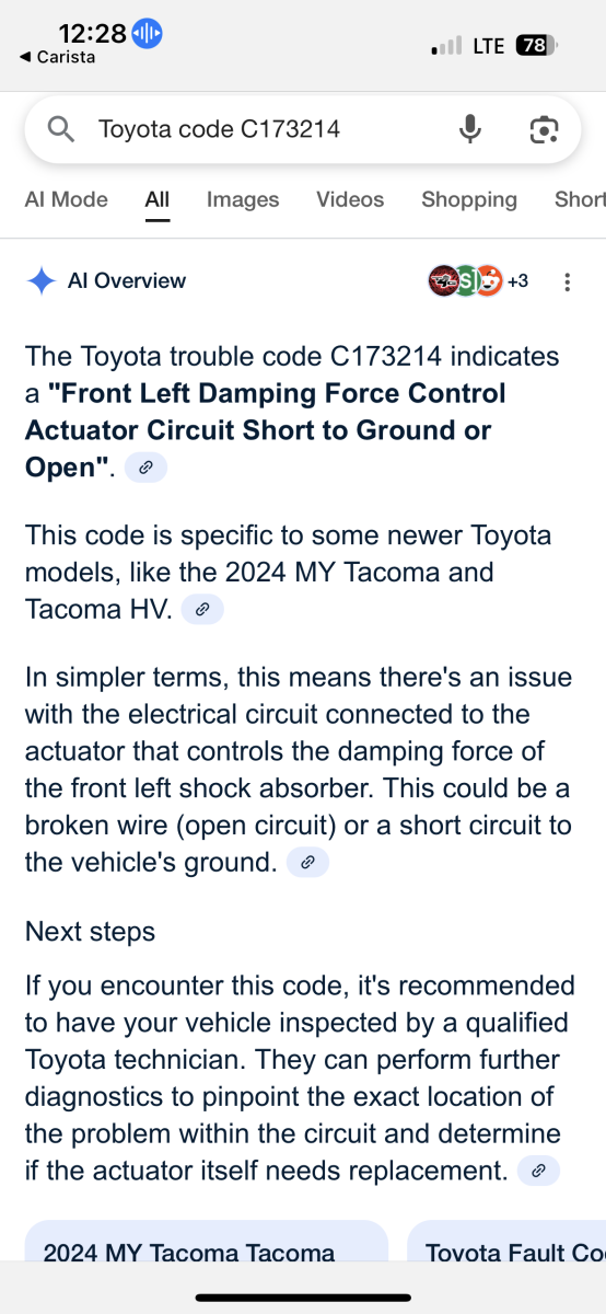

I haven’t recently checked my Carrista OBD, but previously it did show the 4 codes, one for each corner:
They each read basically the same:
I did reset, clear all 4..but haven’t checked to see if they reappeared. I just made the assumption they always will.
Either I ‘got lucky’ (doubtful), or my Slee Offroad installer knew what to do, or the ARB response above is not entirely detailed enough to be correct. Not sure which.

The lead tech at my dealership confirmed that AVS error codes/faults/failures do not display on the dash. I had a faulty AVS sensor on one shock and it was only found using Techstream
