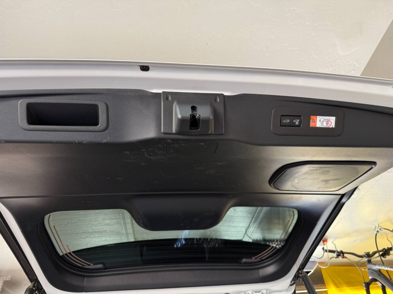

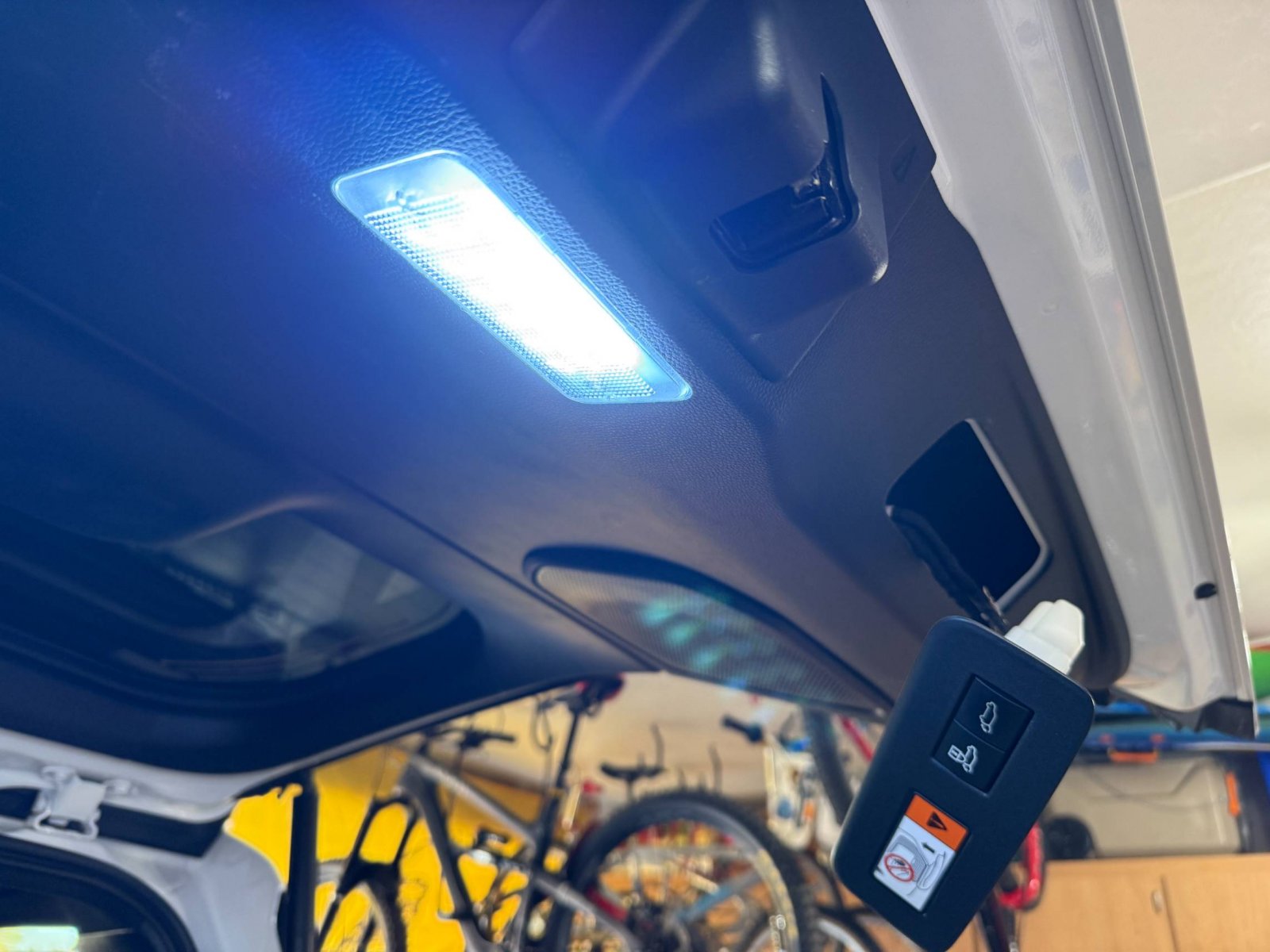

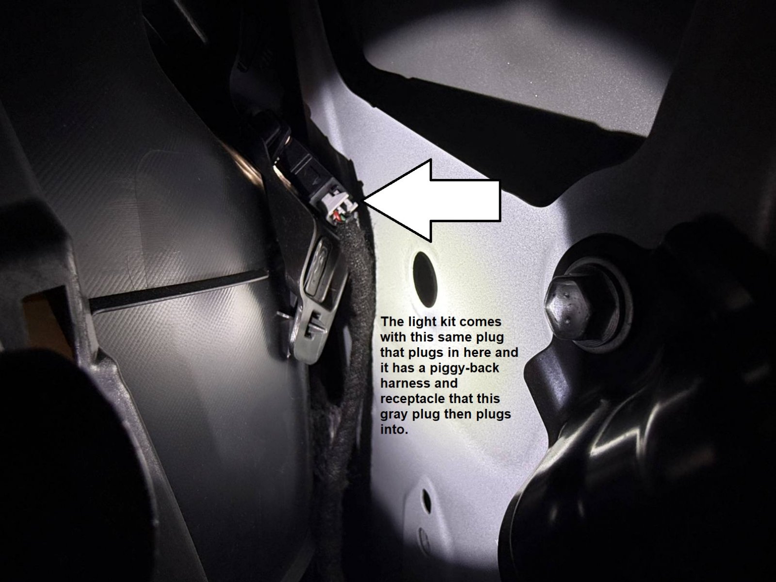

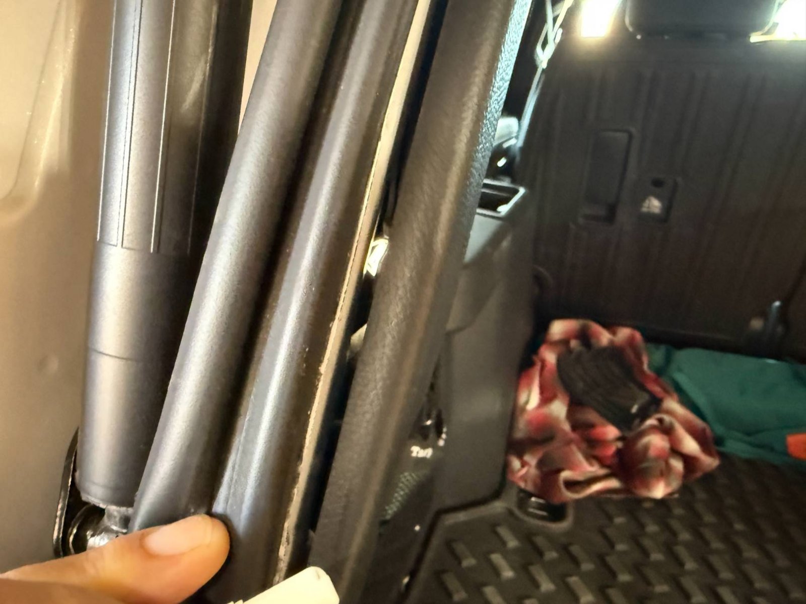

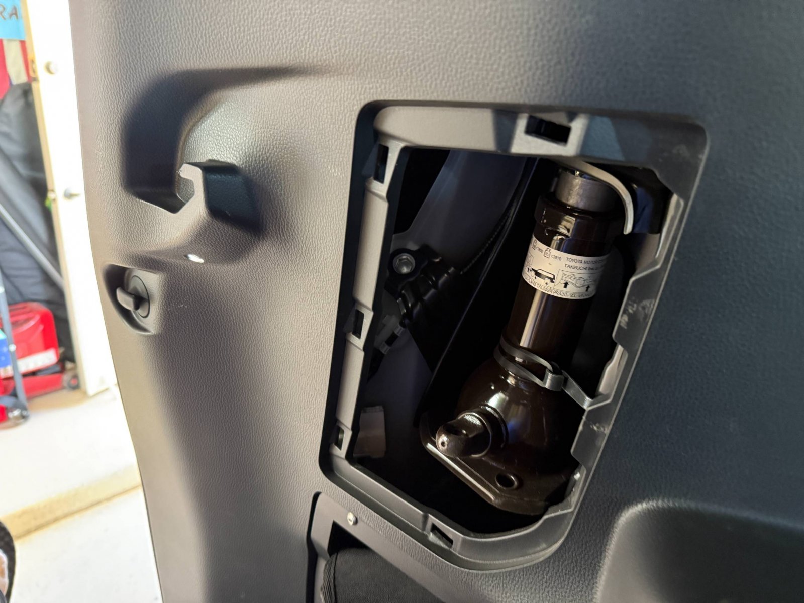

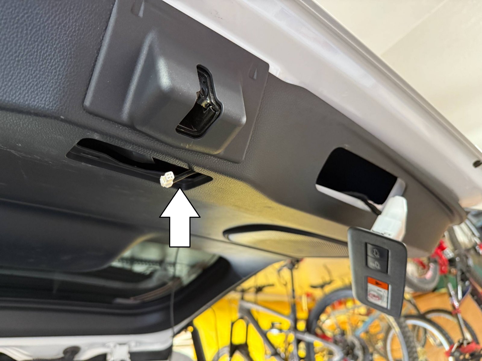

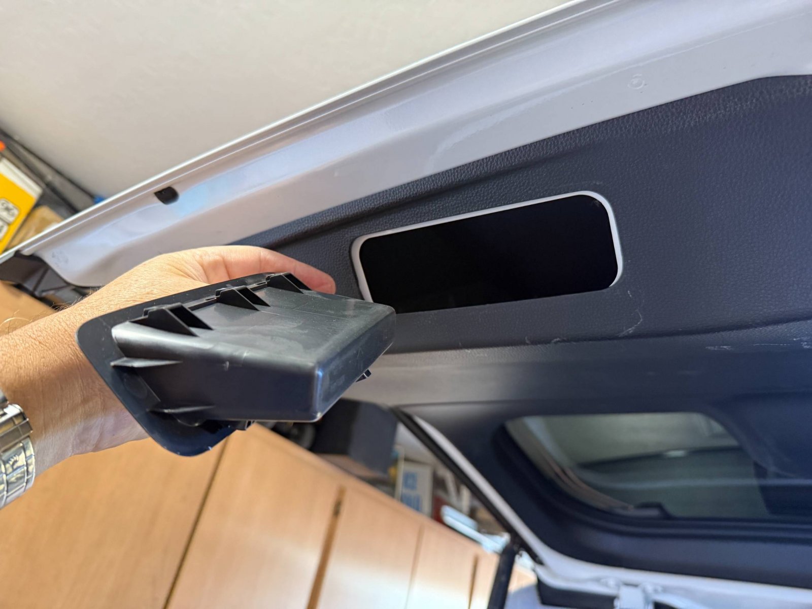

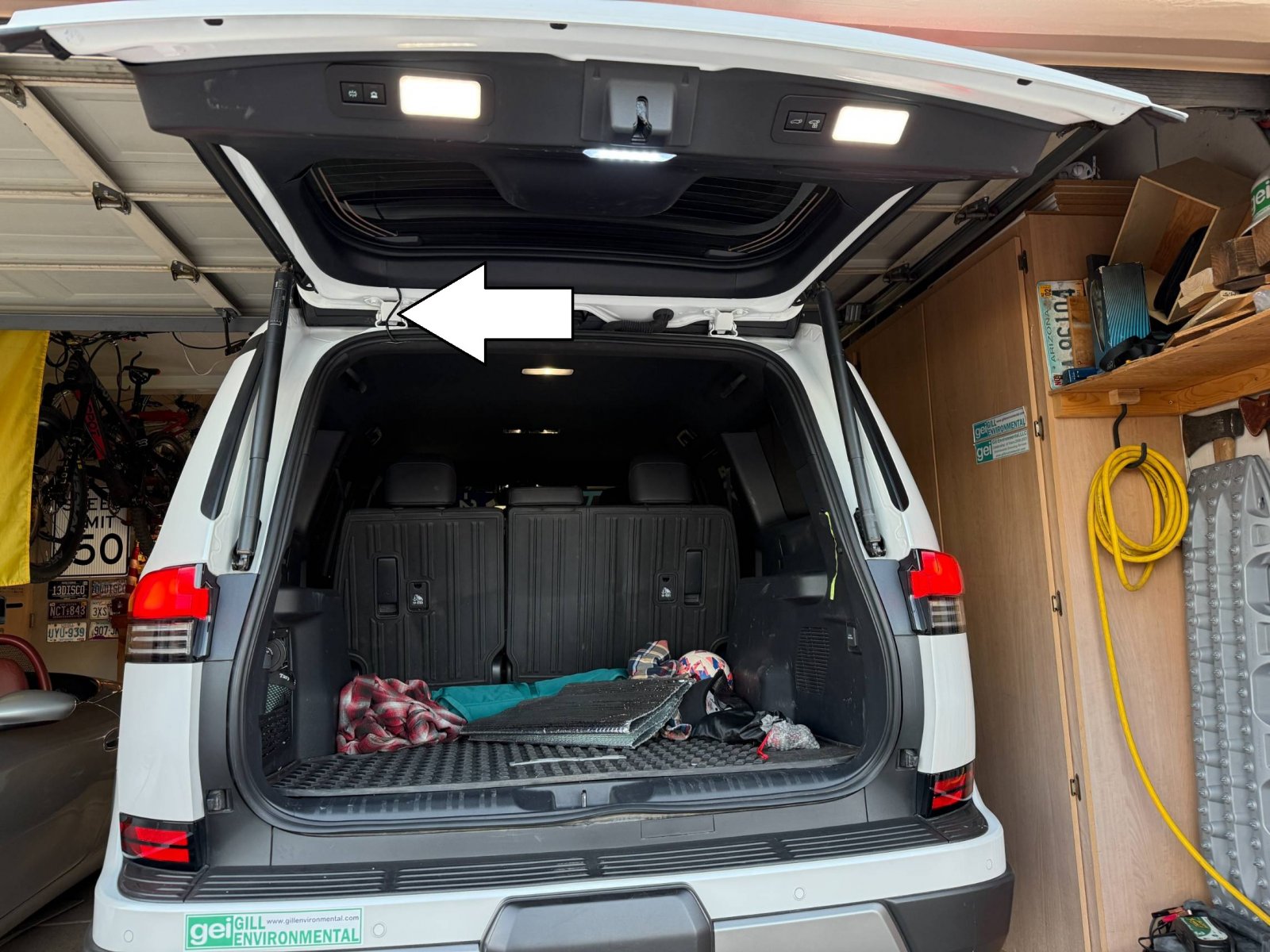

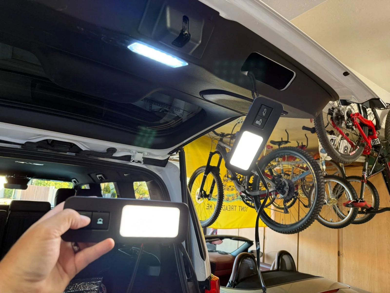

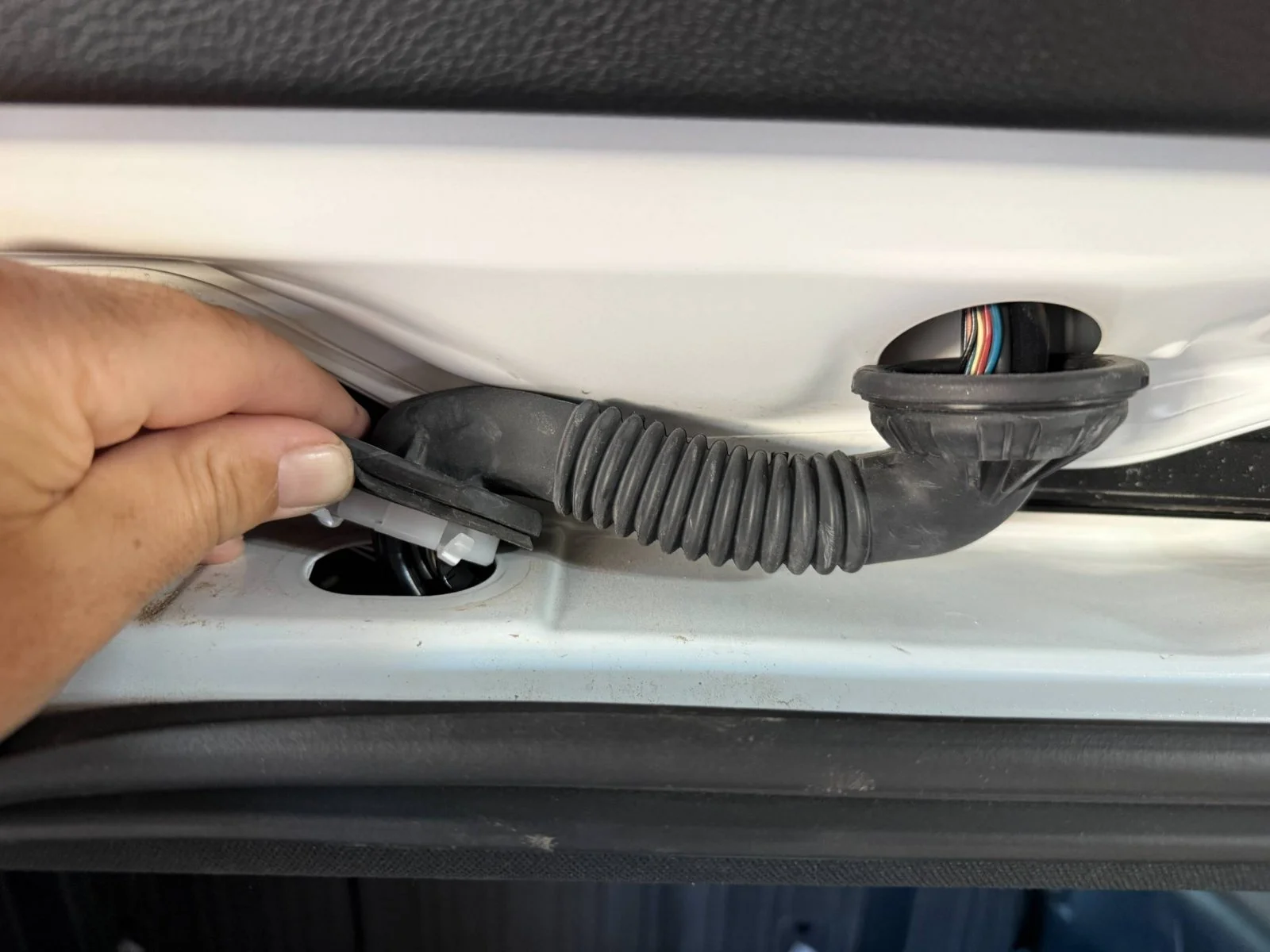

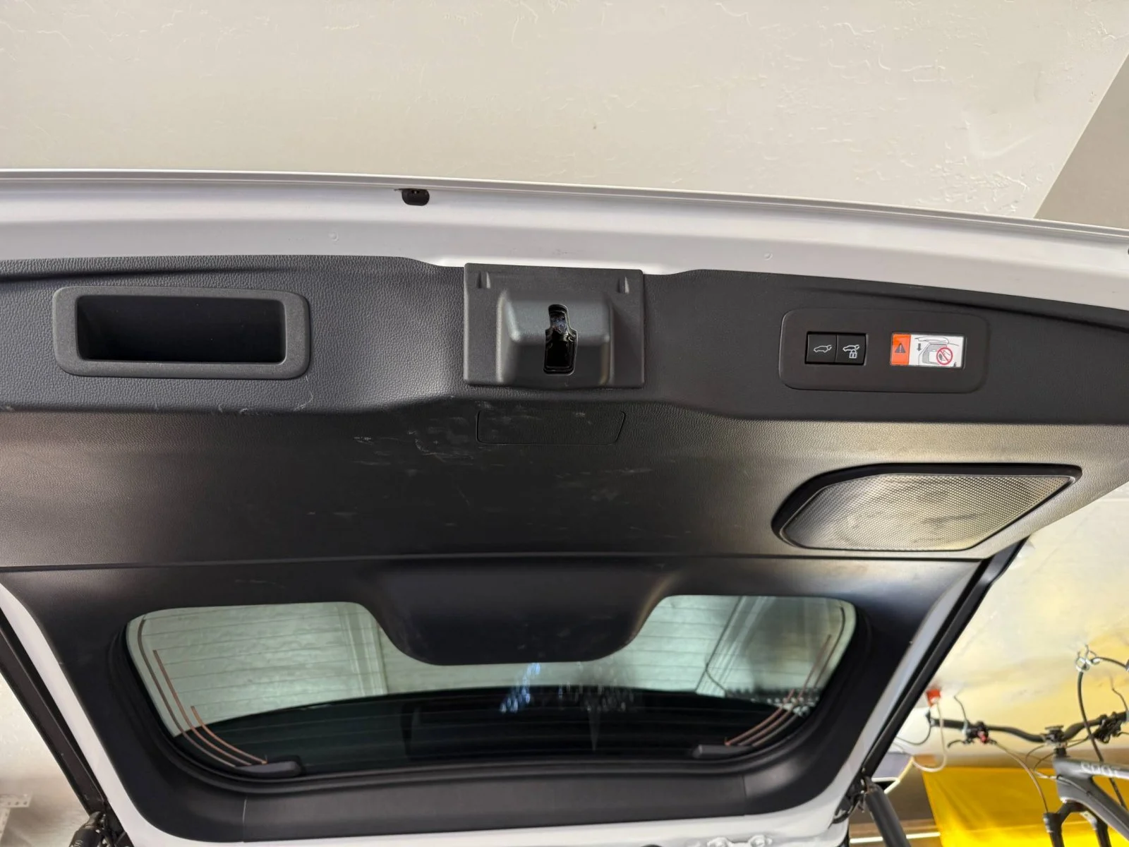

Installed the new tailgate lights. What a total PIA. I hate working with body panels and interior panels. I installed the single middle LED light on the underside of the tailgate first because this one came with directions and I knew this one had to piggy-back off the little tiny LED on the left side near the jack (there're 2 tiny little LEDS on the left and right sides of the cargo space). The Amazon directions show this single light piggy-backing off the tailgate up/down switch but the kit they sent had to be routed all the way to the little tiny LED by the jack. So I had to run the wires from the jack area up the inside trim on the left side, through the rubber weather-proof wiring protector (this was a really special PIA), and then down the right side trim, across & behind the cargo door trim by the subwoofer, to the middle space where there was previously a black blank plastic piece. What a pain. But this new LED is bright and it will make a difference. Of course, the $80+k truck should have come with a friggin' light there in the first place.

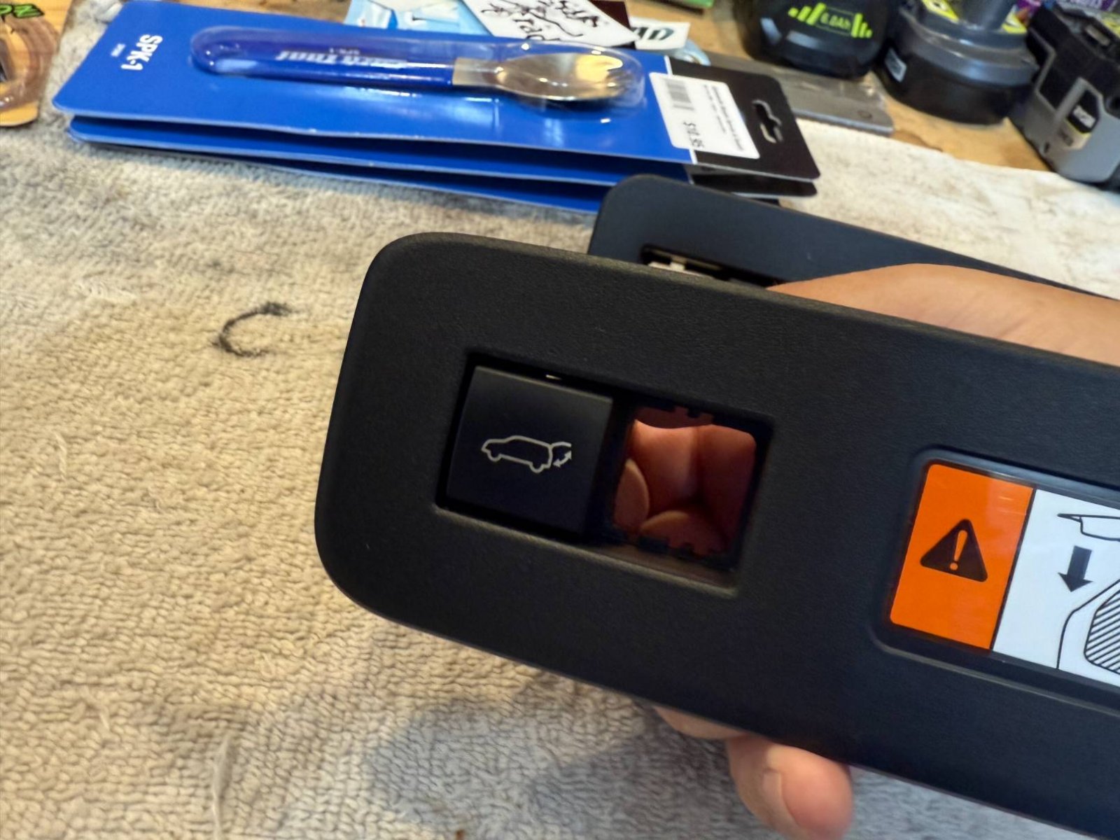

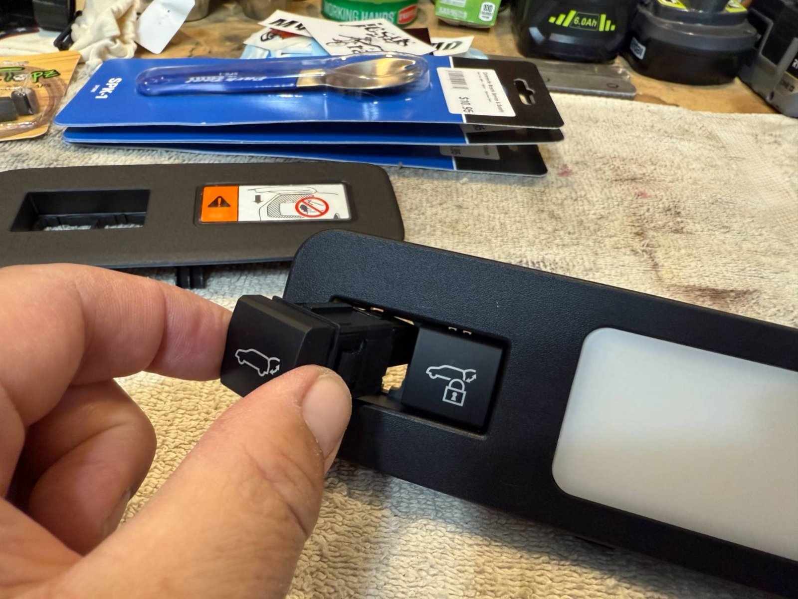

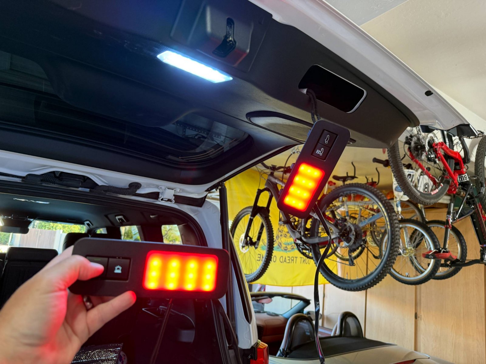

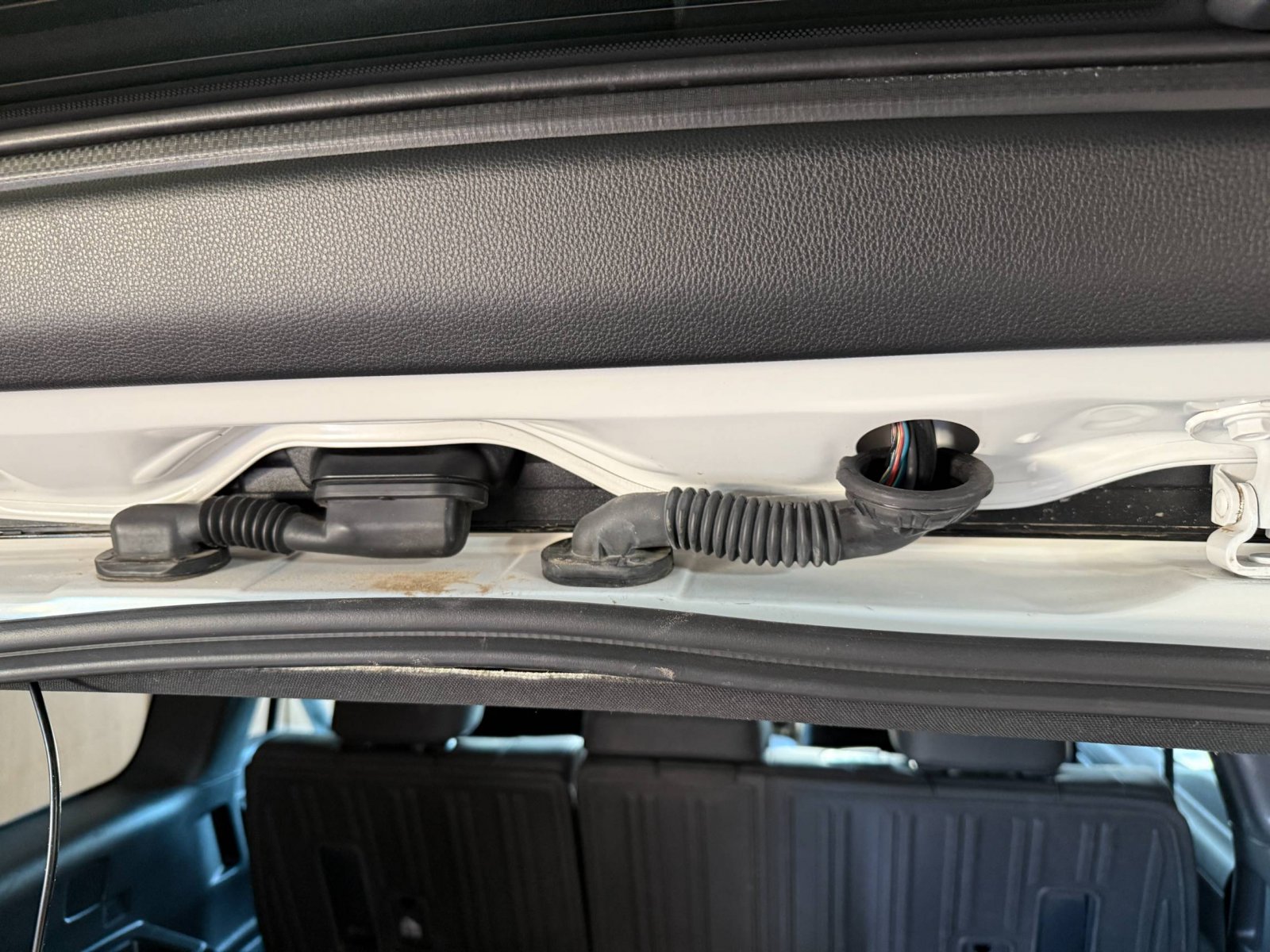

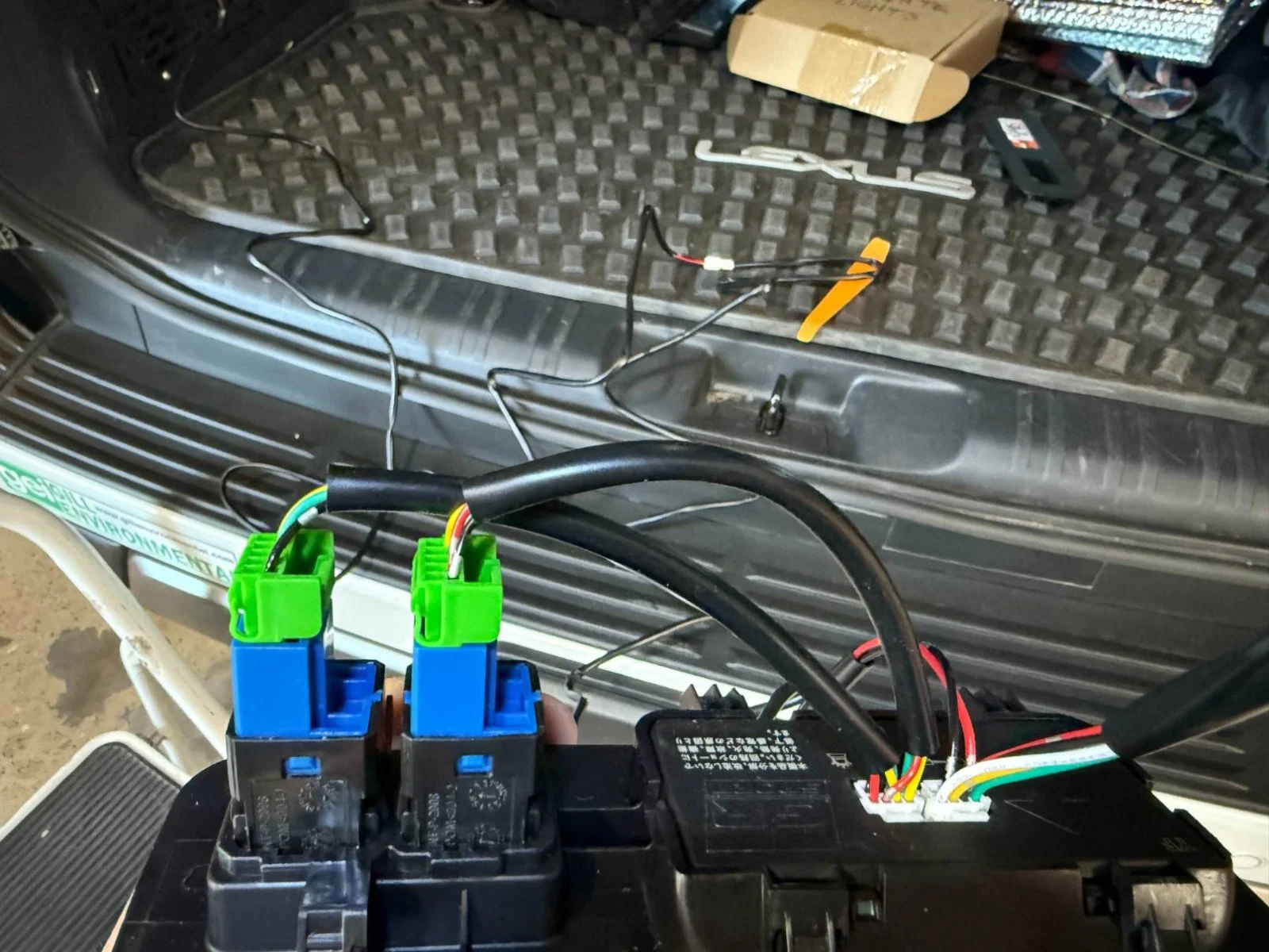

Then comes the double-light that replaces the finger grab handle with a light and 2 switches and keeps the two tailgate raise/lock switches on the right side but adds a light to this little panel. I thought that these two lights must just piggy-back off the tailgate raise/lock switch but this package didn't come with directions. I had to lay it all out and figure it out and of course it had the same piggy-back plug setup for the little tiny LED near the jack. I routed the wire all the way down to the jack area again but I muttered a big F*CK IT and didn't try to get this second plug through the tight rubber weatherproof conduit. I just ran it out of the interior trim and over the rubber gasket and back behind the headliner & interior trim in the upper left corner of the cargo area (see arrow in last pic). For the piggy-back arrangement, I just piggy-backed off the first piggy-back. These LEDs are pretty bright too. The red LEDs are a nice touch, as is the yellow/white strobe setting. I'll have to drive out into total darkness tonight and check it out. Installation was a royal pain in the ass, of course a few of the cheap plastic trim clips broke but all the trim pieces are in place and holding tight.

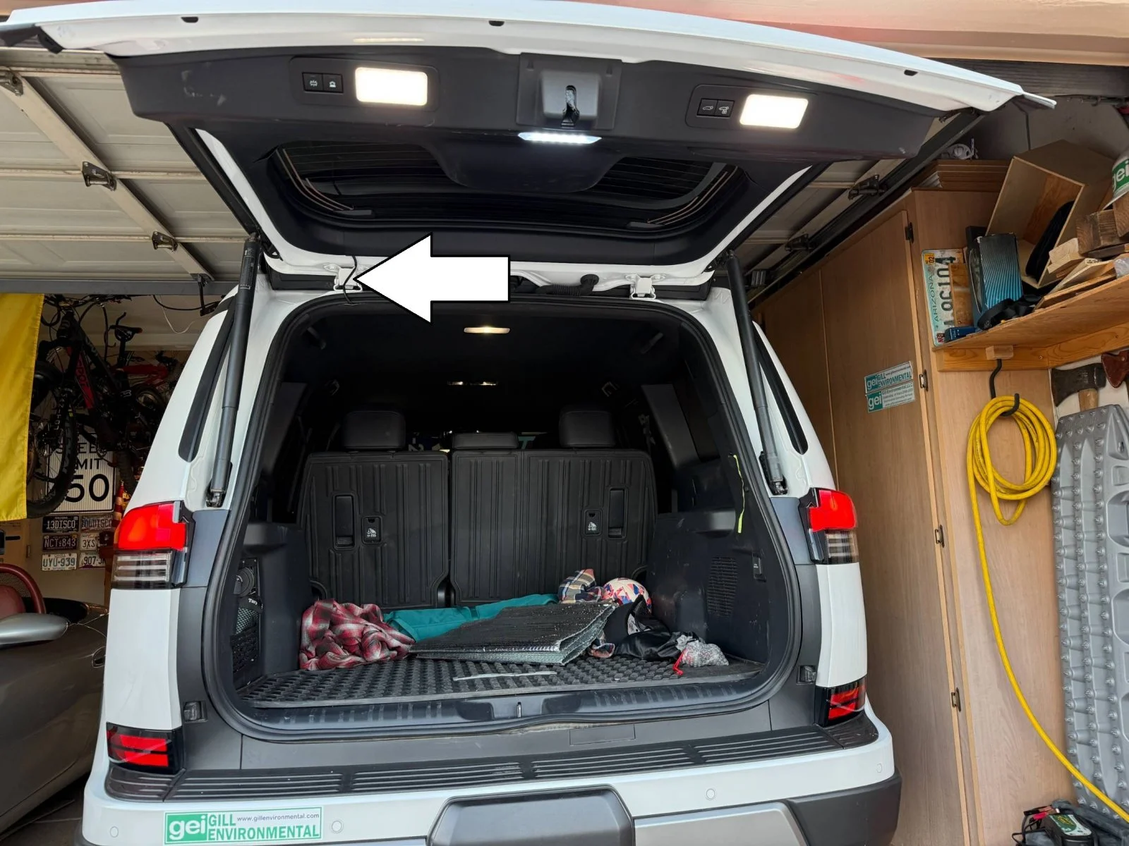

View attachment 8481View attachment 8482View attachment 8483View attachment 8484View attachment 8485View attachment 8486View attachment 8487View attachment 8488View attachment 8489
View attachment 8490View attachment 8491View attachment 8492View attachment 8493View attachment 8494View attachment 8495
Saw the single light you added on Amazon - which are the 2 lights you added where the close/lock buttons are and the other side? Also, you noted that Amazon sent you the light that was not the one for the power tailgate that looked like a pain to install. Do you know if the one for the power tailgate just connects to the close button side versus all the way to the jacks?
Here are the two I ordered from Amazon:
Single center tailgate light:
https://www.amazon.com/dp/B0DNLXL6L2?tag=lexusgx-20
Double lights:
https://www.amazon.com/dp/B0DL5YCLTF?tag=lexusgx-20
There have been other links to these lights on Alibaba or Temu or some other china websites but I decided to pay a bit more through Amazon so I could return if needed. As I remember it, it was one of those cheesy china sites that had directions showing at least one of the lights (either the single central light or the double lights) simply piggy-backing off the tailgate raise/lower switch.
I though I was getting one light kit that piggy-backed off the tailgate open/close switch and the other light kit would piggy-back off the little tiny LED near the jack.
Turns out both of my kits piggy-backed off the little LED near the jack.

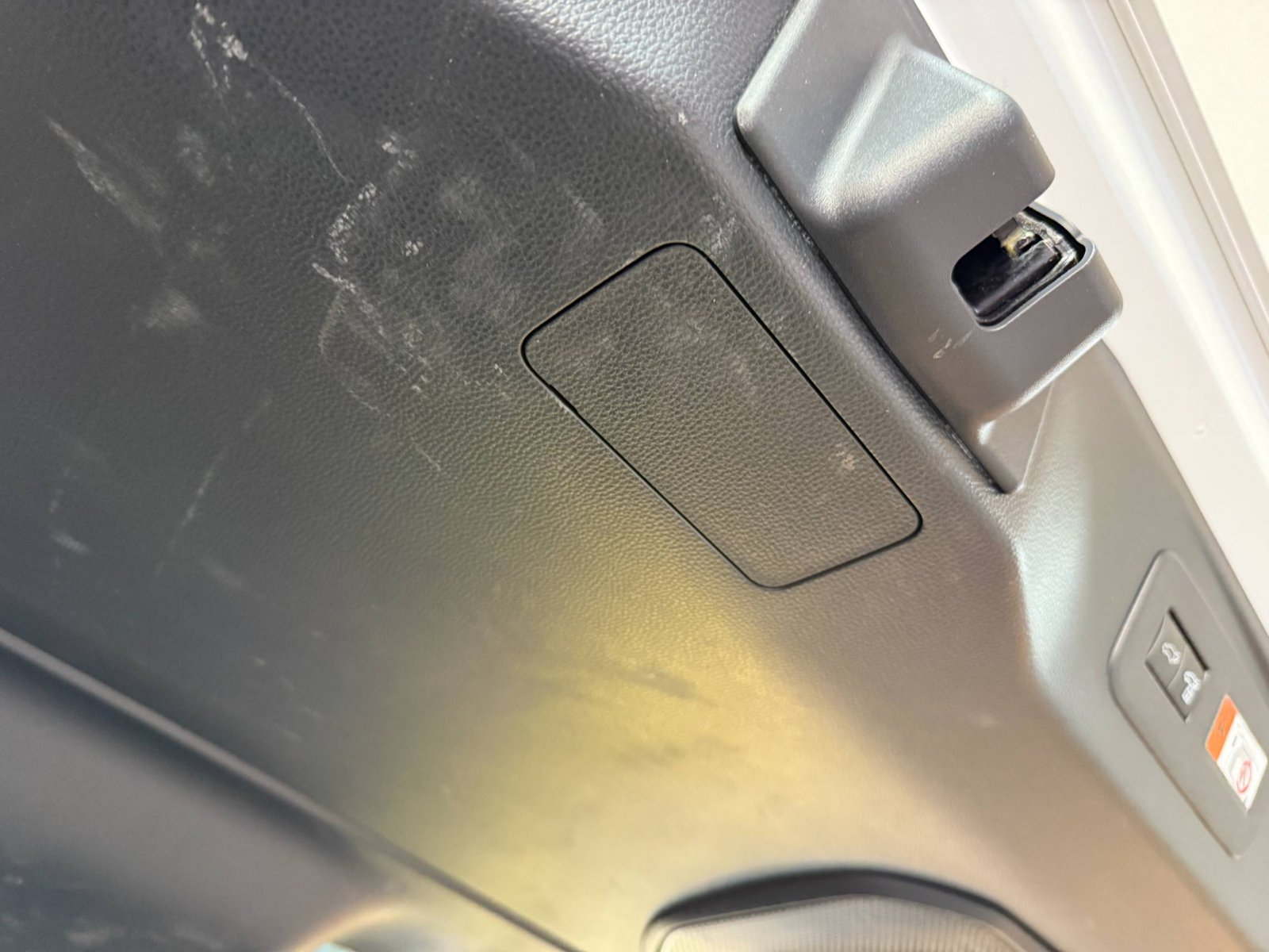

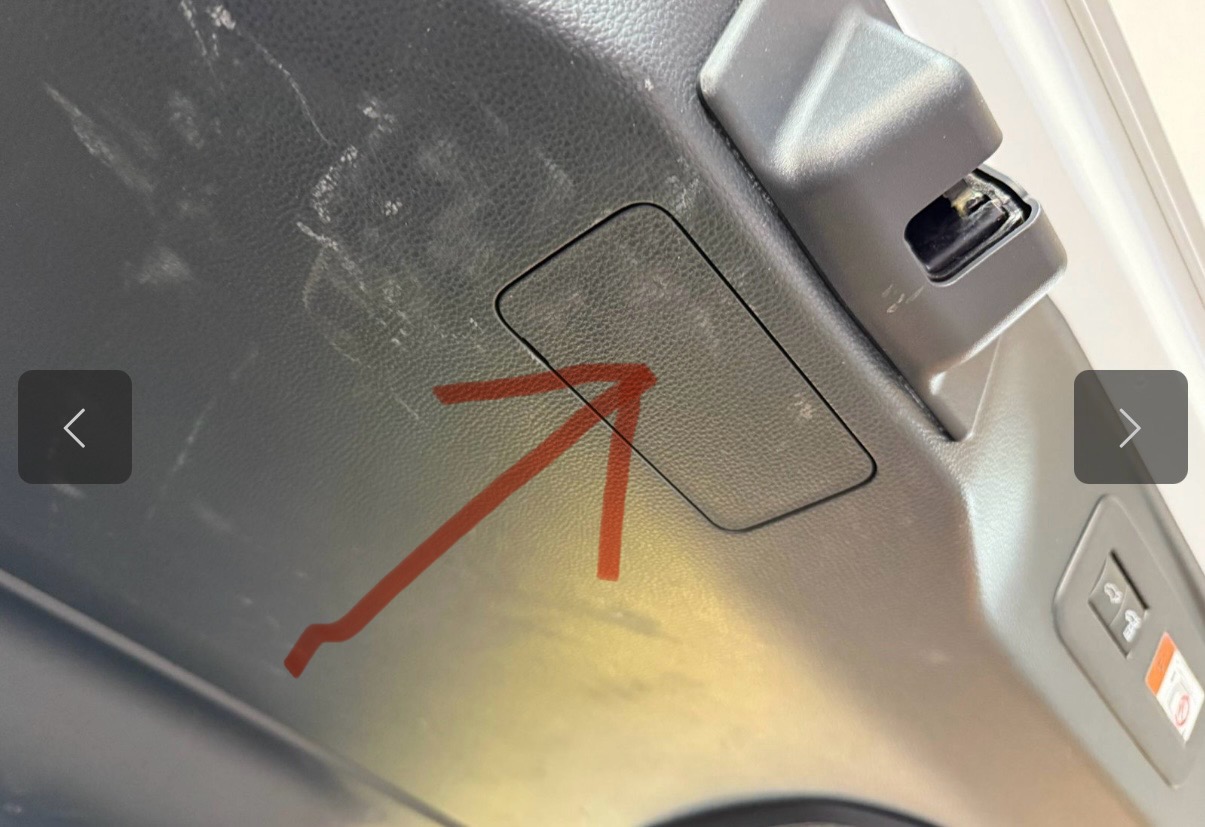

Did you use a Dremel to cut the panel for the single light?
No, there’s a pop-out piece for the single center light. You can see it in my first pic.

I've really been digging these extra tailgate lights. They make a huge difference in a dark parking lot. I now have a giant bubble of white light around the back of the truck where it was previously a black hole. I also just realized that the single central light that faces straight down turns on & off just by touching the light anywhere on the plastic cover. I'm looking forward to using these lights next time I'm camping and it's absolutely pitch black.

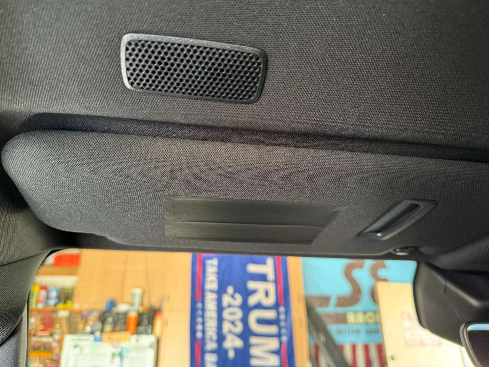

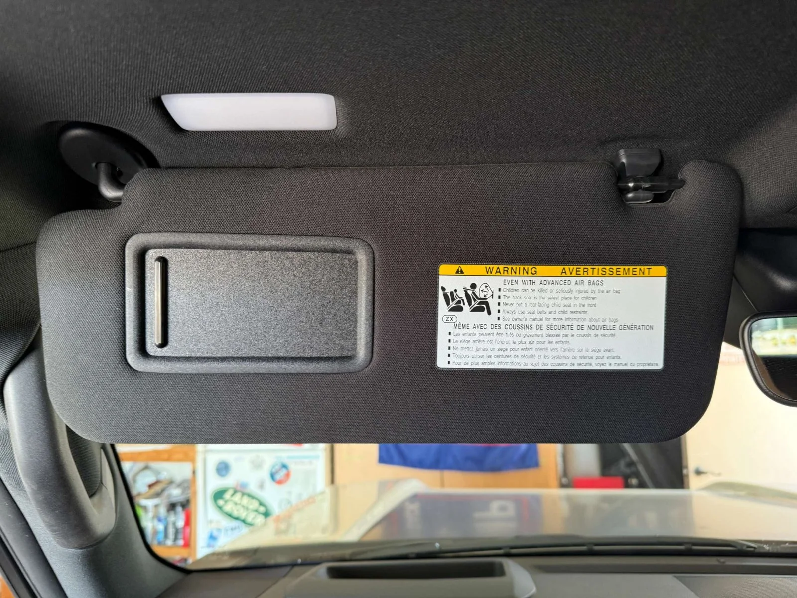

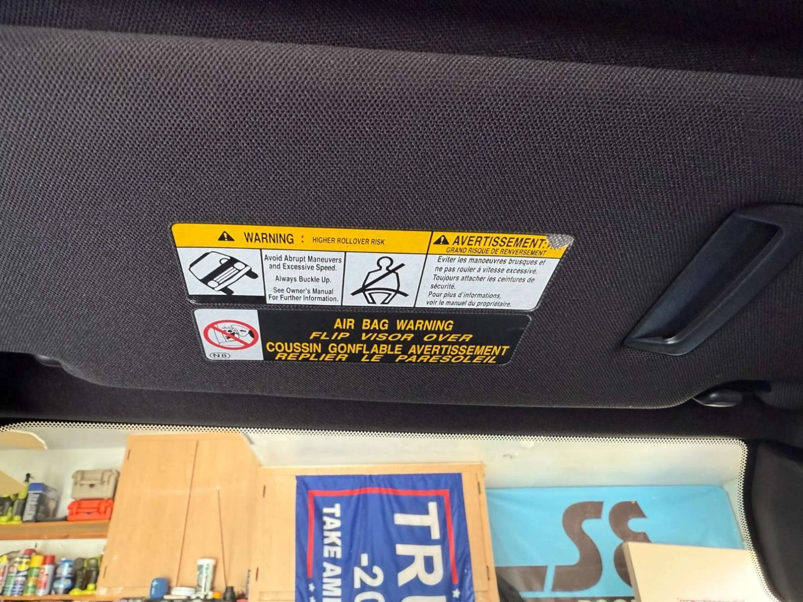

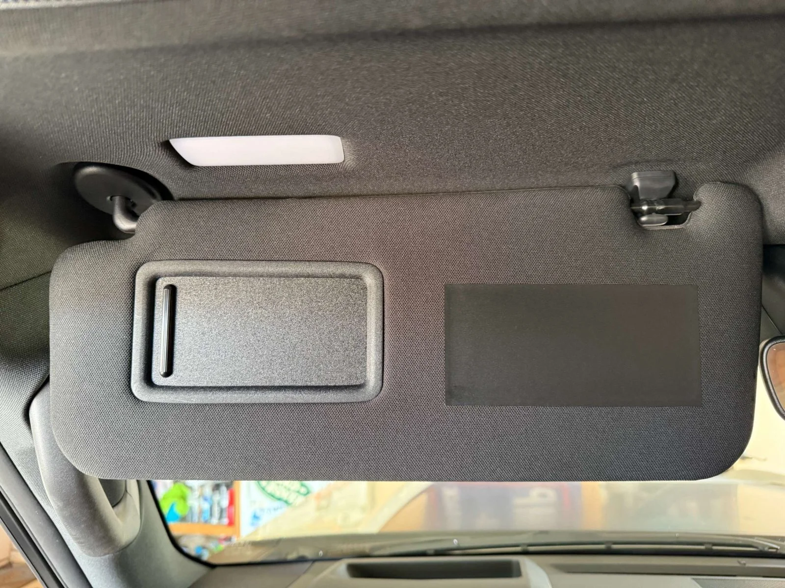

I absolutely hate the warning decals that our nanny regulators mandate for the sun visors in all vehicles nowadays. On previous vehicles I've been able to remove these decals with isopropyl alcohol and some heat, if needed, but that didn't work on my GX550 because the decals are infused into the fabric covering the sun visors. My previous vehicles have all had the vinyl material covering the sun visors. For my Porsche I just ordered a pair of European sun visors that of course don't have the idiot stickers because Europeans assume their drivers have IQs above room temperature.
I had a discount coupon from Stickerfab after ordering their steering wheel cover and their B-pillar seat belt protection decals (more on these items coming up), so I ordered their black vinyl decals to stick over the warning decals. There are two idiot stickers on the driver's side and one on the passenger side because clearly the average American driver is twice as stupid as the average American passenger.
It's not ideal - they are clearly black vinyl decals on the sun visors, but it's better than the idiot stickers. The other solution would be to remove the sun visors and have them refinished in vinyl or some kind of fake or real leather.
In the photos the decals really stand out but in reality they blend in very well. Stickerfab also supplies you with two of each decal so you have two full sets in case they start to peel or whatever.
Sun Visor Warning Overlays - 2024+ Land Cruiser / GX 550

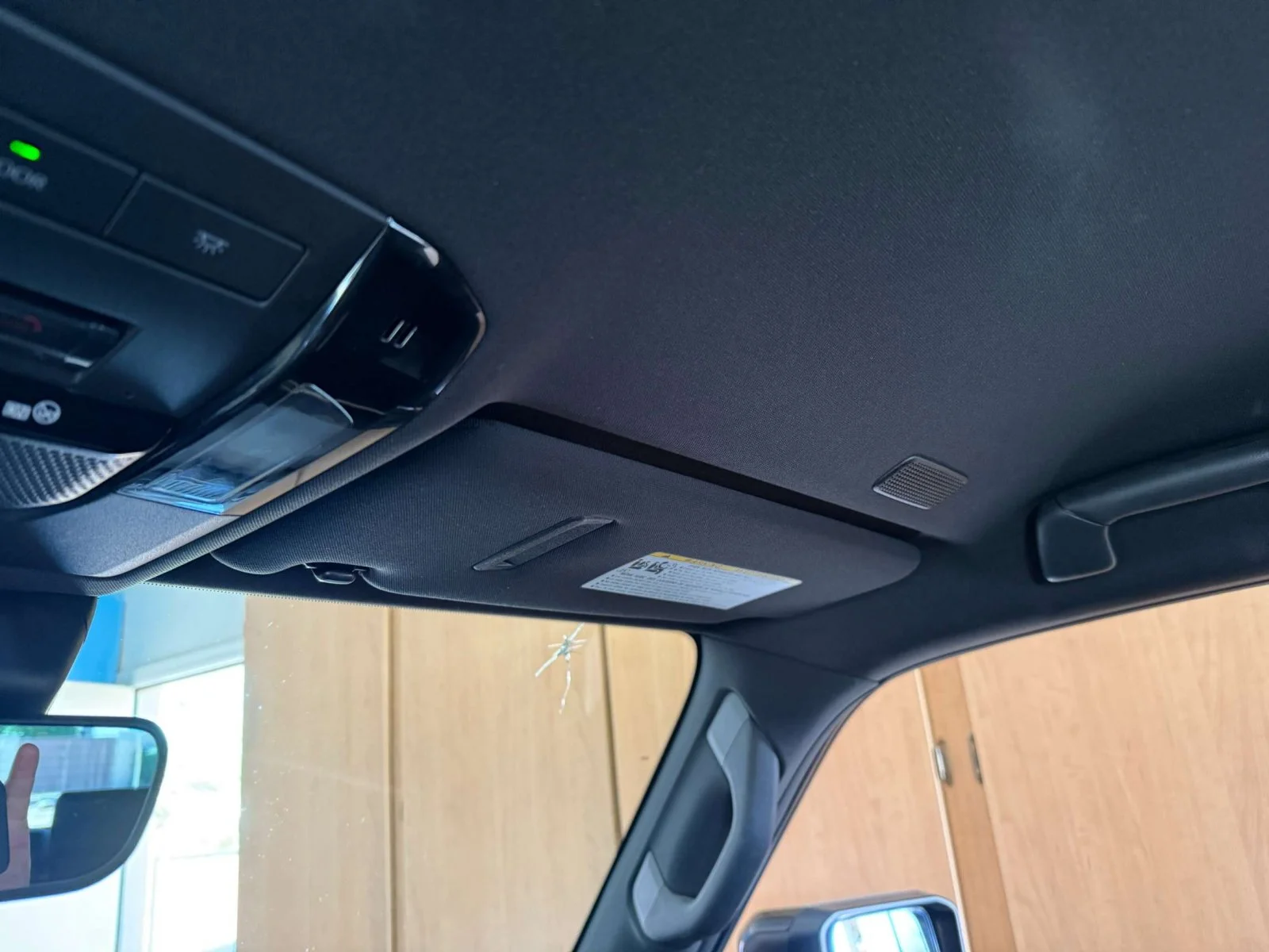

In this picture you can see where I tried to peel the idiot sticker in the upper right corner. I soaked a folded-over paper towel in isopropyl alcohol and let it sit on the decal for 5 minutes but it wouldn't release the decal from the fabric:

Those look a hell of a lot better than before. Very worried though that I could expose the family to dangers now - and they will not know the warnings...
