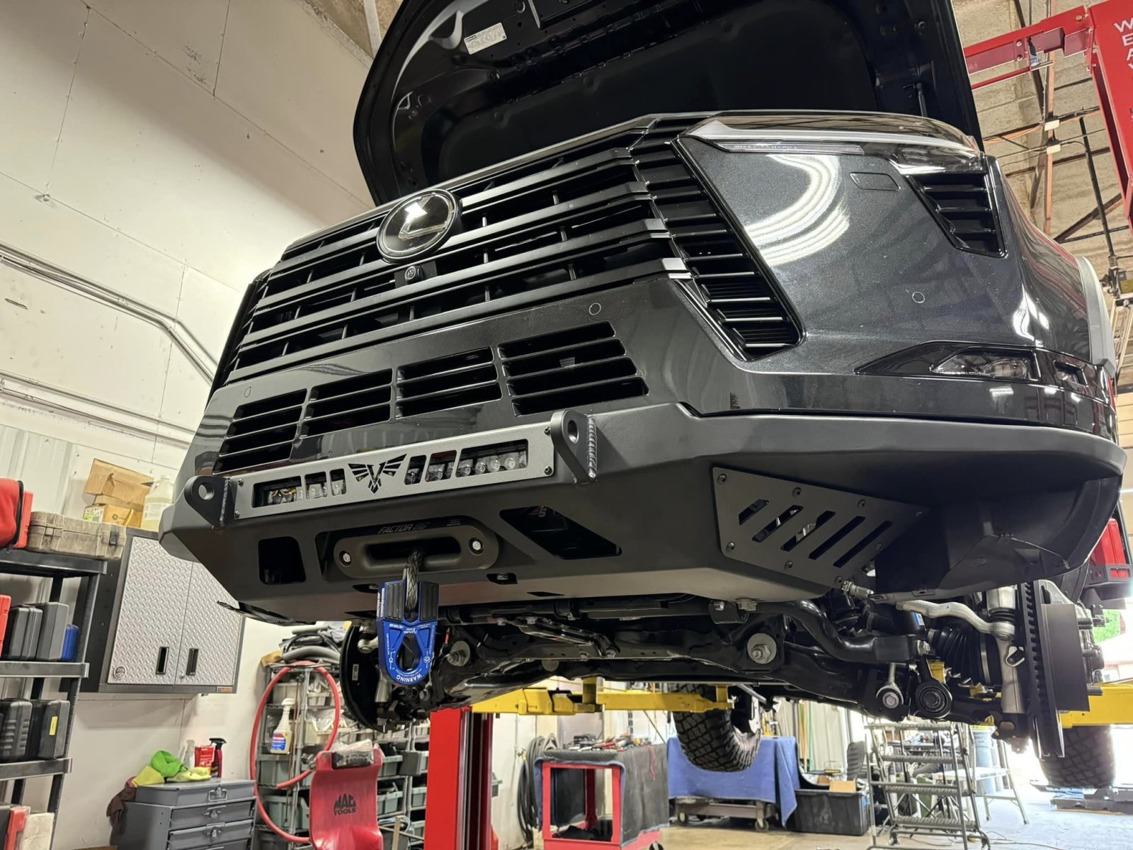

Check this out from Victory 4x4
Looks very nice for what you have to work with on the GX550 front end. The fairlead is pretty low and it's going to take some hits and get packed with dirt but it's pretty darn good for just removing the lower bumper plastic and not cutting into the front plastic above. Personally, I think you'll see some winches being placed in the space occupied by the lower air openings just above the light bar with the Victory logo in the picture below.
Hopefully that's a pre-production version...the fit and finish doesn't look great, particularly on a new $80k truck.

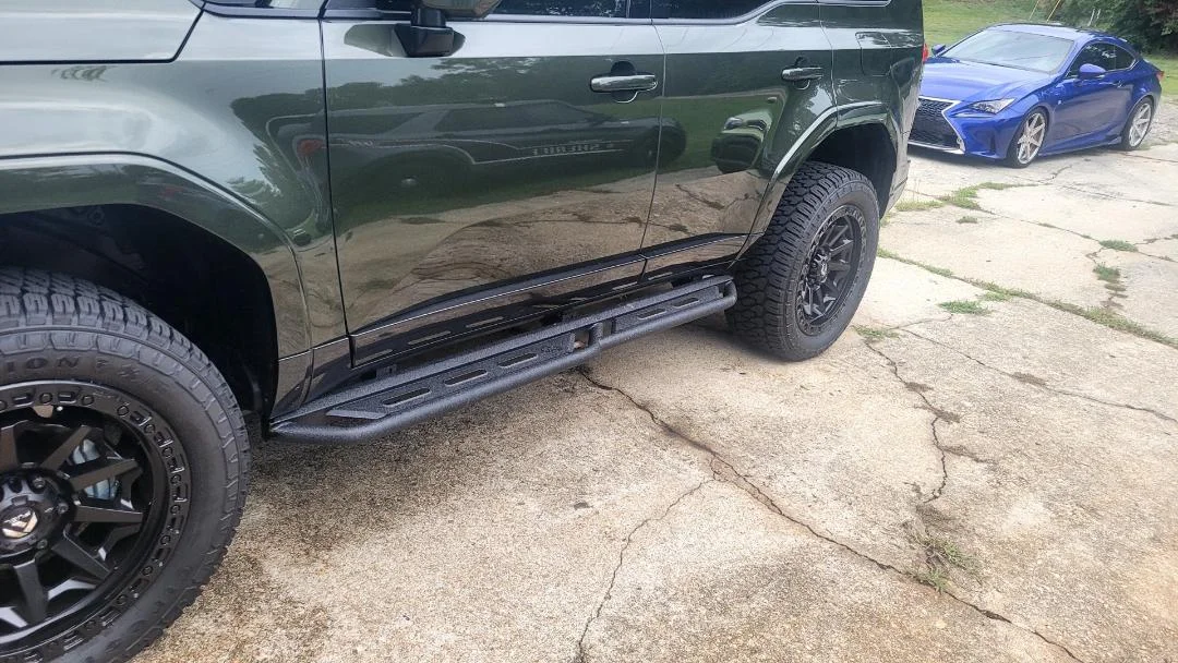

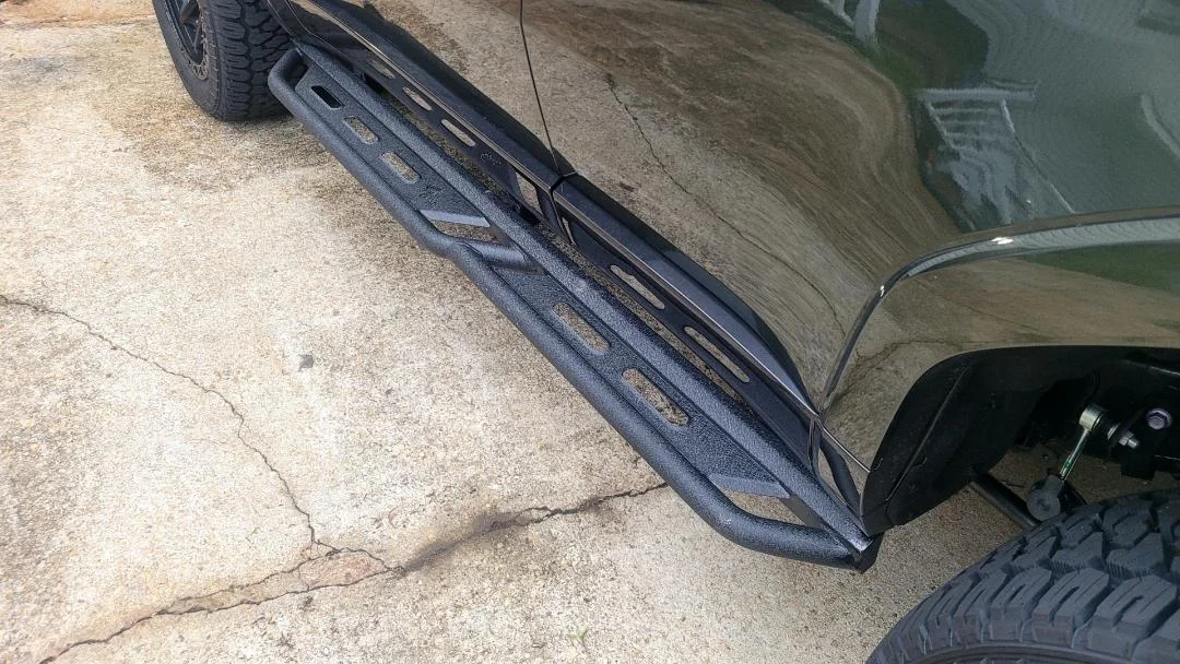

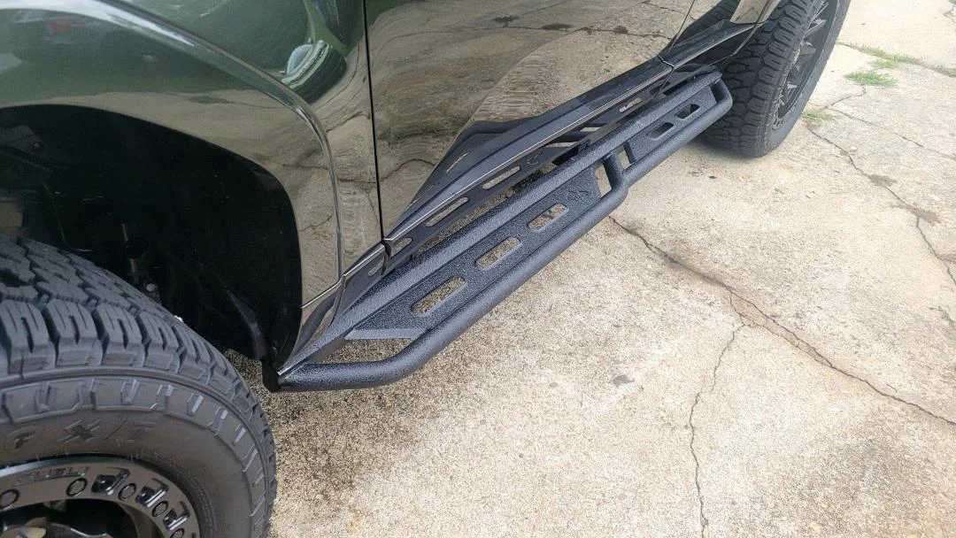

Iron bison tacoma step rail on the Gx, modified mounting bracket locations

Despite the noted above, it is great to see the aftermarket getting in quickly on this new platform. Low profile front bumper to gain clearance where it can will be a huge win on the trail and provide some added piece of mind. Some high clearance step sliders are also very handy. I have a very old set on our 80 made by bump it off road and they provide enough protection without loosing the usefulness of a step when packing away our RTT. Will be looking for a similar option for the GX in the coming years. Maybe a set of 285 (34") tires on the factory Overtrail 18's would be welcome and potentially bolt on without any additional lift. In the mean time it will be exciting watching all your builds.
