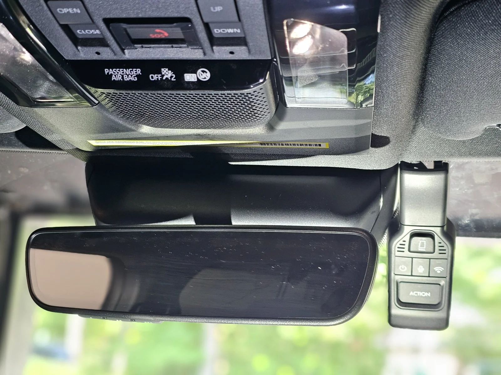

As others have noted, the default location for the port installed dashcam is a little bit obtrusive to driver visibility. I was planning to see if the dealer could move it to the other side, but then when I took it in for window tinting, the installers removed the camera from the windshield and left it just hanging for me to reinstall after the tint dried. I decided to see if I could move it myself. I removed the two part housing from the rear view mirror, which was easier than you would expect, it just kinda came off with minor tugging. The wire for the dashcam was run over the top of 4 other wires and I could not disconnect it from the camera. After a few minutes I realized I could disconnect the other wires one at a time and move the dashcam over to the other side, took 2 minutes. Then I just worked on putting the housing back and tucking the wire up behind the cowling and the header. The tint installers had kindly added new 3M adhesive tape to the mounting plate. I got it ready to adhere and snugged it right up against the mirror housing. From the driver's seat I can barely even tell it's there. One thing to note is that the port installers cut a small notch in the header for the wire. I did not do this on the other side and it worked fine, and I can't see the original notch after moving the camera. It's a simple DIY mod that makes a great improvement to driver visibility and retains the extra security of having a dashcam.

Can you include a picture of where you have it placed now? I think i need to move mine as well.
Thank you very much!
