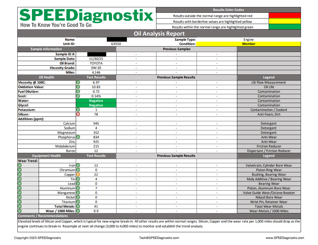

It would be nice to know if switching to 0-30 or 5-30 would be acceptable and better long term. I’m not concerned with whatever minute gain in mpg 0-20 may give me.
There are anti-wear additives in engine oil that diminish over time/use.
Bearing film thickness is tried and true for protection against bearing wear.
You want bearing surfaces in the hydrodynamic lubrication range where there is a layer of oil separating metal. Ref: Stribeck curve
Turbo engines run hotter than non-turbo engines and will most likely shear your viscosity in a couple of thousand miles.
When your oil’s viscosity shears down, your oil moves towards mixed lubrication range (some metal-metal contact), then eventually boundary lubrication range (metal-metal contact).
This YT video ELI5 it better:
If switching to a -30 weight, then consider one with a high HTHS to resist shearing (not all -30 weight oils are the same). Change it every 5k/6mos.

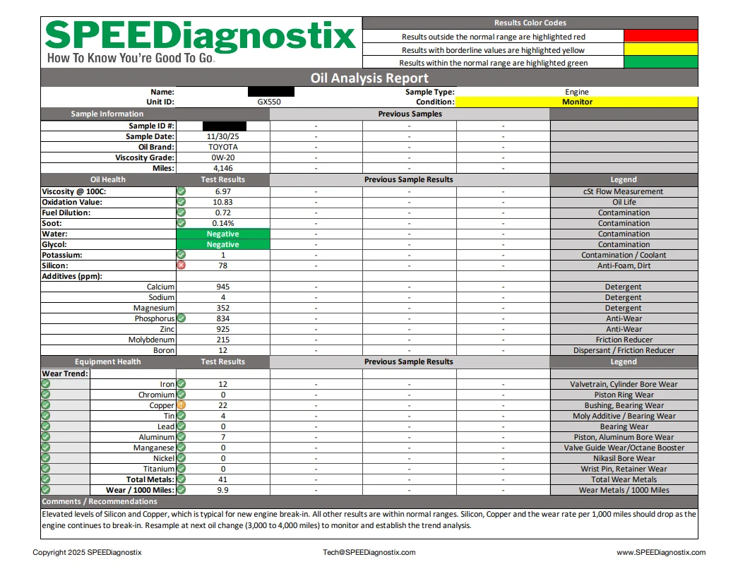

One thing I can say is my Genuine Toyota 0w20 almost sheared out of grade after 4100 miles. I believe the minimum KV100 spec for Xw20 according to SAE J300 is 6.9cSt, and looking at my used oil analysis, its KV100 viscosity was 6.97cSt.
According to this new oil analysis of Toyota 0w20 from 2021, its original viscosity should be around 8.2cSt: https://bobistheoilguy.com/forums/threads/toyota-0w-20-sp-voa.341709/
KV100 is only one metric out of many, but I think this gives credibility to a 5k mile oil change interval, at least if you plan to run genuine Toyota / Lexus 0w20 oil. Sadly, my oil analysis company doesn't appear to measure HTHS, which would be another indicator of oil film protection under the heavy loads and high heat seen in bearings.
Here's my UOA:
