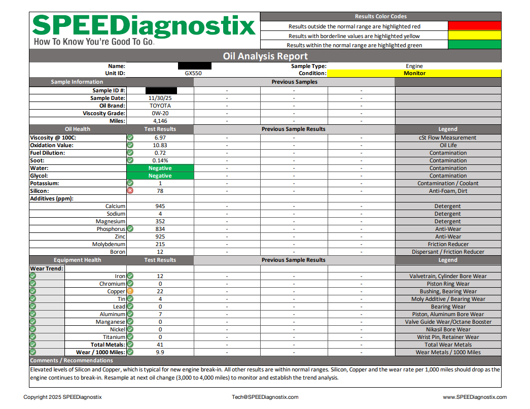

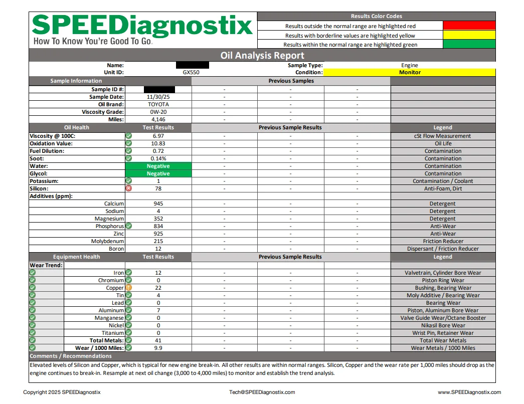

One thing I can say is my Genuine Toyota 0w20 almost sheared out of grade after 4100 miles. I believe the minimum KV100 spec for Xw20 according to SAE J300 is 6.9cSt, and looking at my used oil analysis, its KV100 viscosity was 6.97cSt.
According to this new oil analysis of Toyota 0w20 from 2021, its original viscosity should be around 8.2cSt: https://bobistheoilguy.com/forums/threads/toyota-0w-20-sp-voa.341709/
KV100 is only one metric out of many, but I think this gives credibility to a 5k mile oil change interval, at least if you plan to run genuine Toyota / Lexus 0w20 oil. Sadly, my oil analysis company doesn't appear to measure HTHS, which would be another indicator of oil film protection under the heavy loads and high heat seen in bearings.
Here's my UOA:
